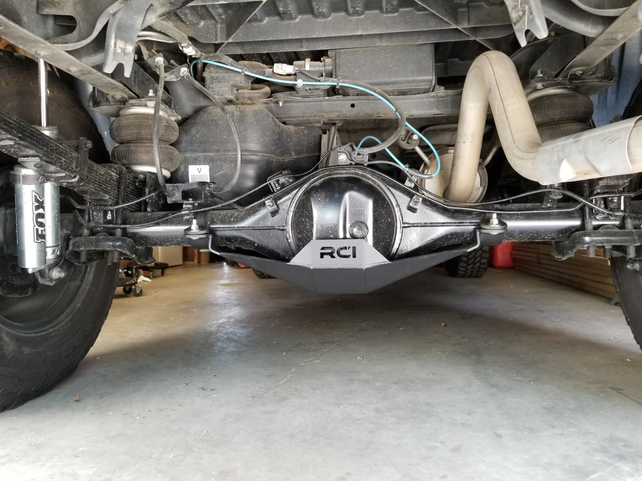

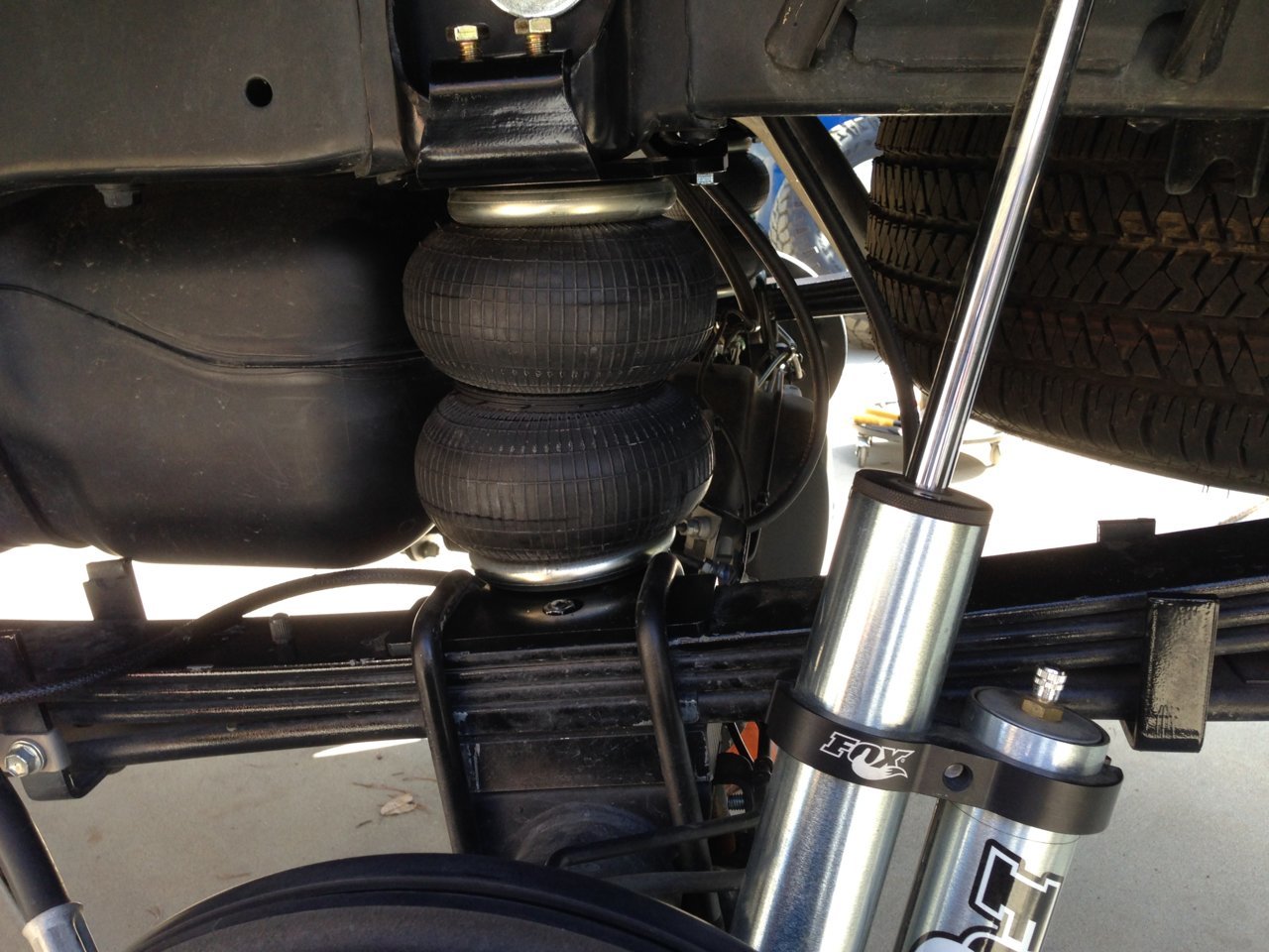

    My truck is like driving on a cloud. I think it's truly amazing. My bag kit is the Hellwig bags, they compress very well and will extend with the suspension when the axle drops out. I run 5 psi in them until I tow, then I hit them with about 40 psi. Here is a closer pic when I was running inverted 2.5 FOX shocks.

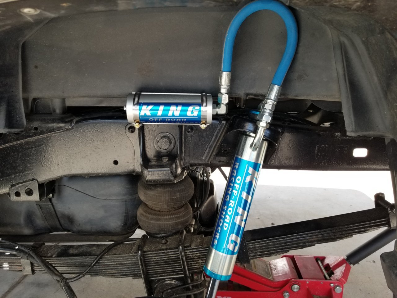

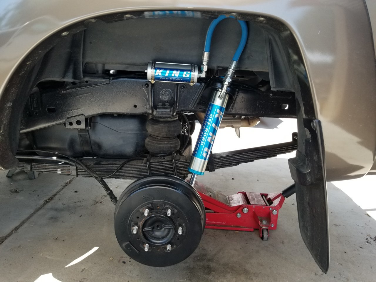

    I have a set and like my setup better. No noise at all. Here is a pic on stock springs. I have been running them this way for years with no problems and I wheel my truck in places like Colorado and Moab UT.

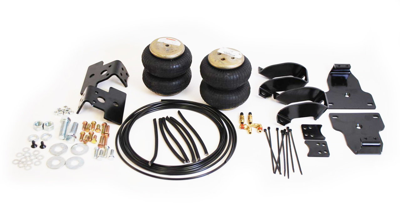

    Complete kit, ready to install, no issues in over 30K miles. Just works, great product, uses a Firestone airbag, but different mounts.

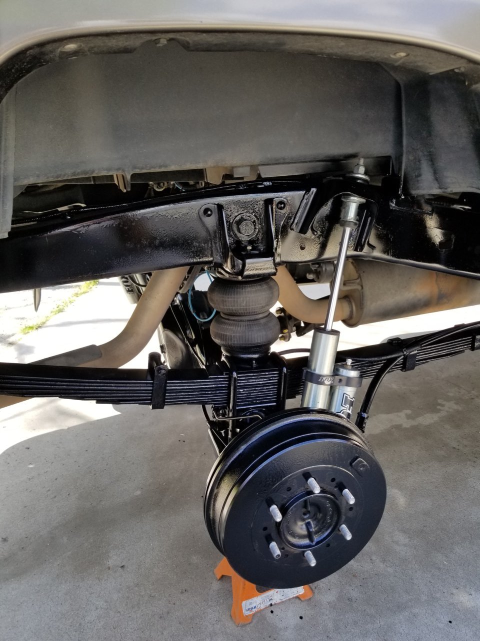

    See pic of the kit, left side of pic are the lower mounts. Zoom in on my axle and you can see how they are mounted. This kit has given me absolutely no problems at all. Year after year, trip after trip. They just work and no leaks.

    Had cradles, dont like the clanking. The bags have an internal bump stop, and when you go wheeling, let the air out of them. The suspension drops out 100%. I have never had a bag tear. They are really strong.
