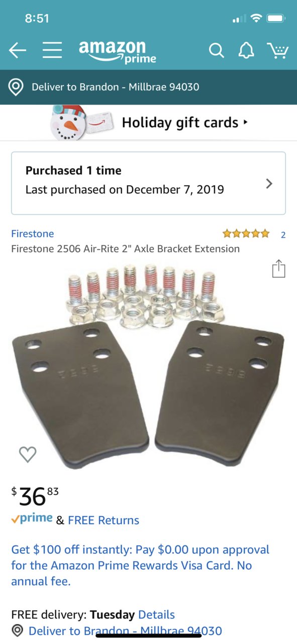

    I run air bags, with the cradle.
    The only thing you might need to do different, is use longer bolts. The bolts that bolt the lower mount might not be long enough. I have seen spacer kits for lifted trucks that move the lower mount up 2-3 inch. I really don't think you will need the spacer with your aal. My buddy had a 2 inch aal with bags for a long time with no issues.

    Thanks! I was reading looks like might needs these to prevent the bracket from bending under load.
