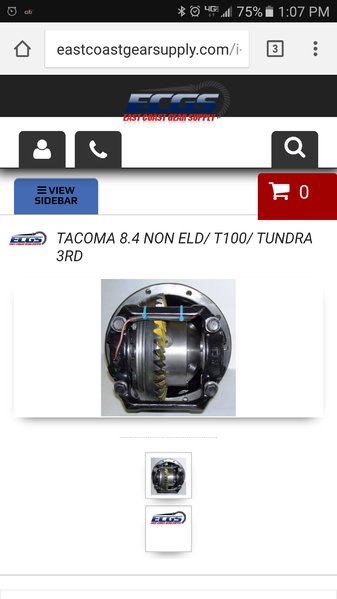

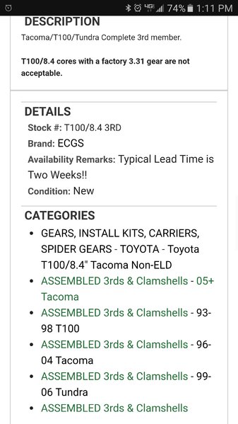

    I'm confused as well, the third member on the front side of the rear axle has bolts holding it in, you can remove the whole third member gears and all by unbolting driveshaft and removing said bolts.
    Notice the picture I have attached, ECGS has 05+ tacoma, Tundra, and T100 listed as same third member. Interesting.. of course this probably means early model Tundra.

    So idk if I'm misunderstanding, but all of the trucks listed on ECGS share same rear thirds?

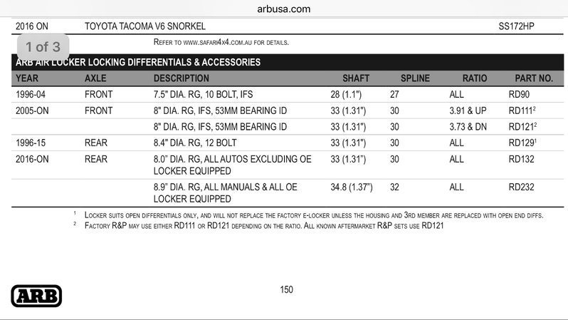

    The Gen3 taco has a new rear diff... it's 8.5" instead of the 8" you're looking at. My 16 Sport has the 8.5" diff because Manual Tranny.. the Auto Sport has the 8" open diff that you can get an ARB locker for. The ORs and Pros have the 8.5" rear locker Auto and manual.
    So for me IF I wanted the locker I'd still got ARB even tho everything is there.. problem is going to be the ECU...I won't have programing for the E-locker and no way to upgrade...

    I believe the new rear is 8.75"

    2016+ All Manuals and autos with factory locker: 8.75"
    2016+ All autos (no locker): 8"
    All 1st and 2nd gen tacos: 8.4"
    Yes, you got hosed if you have an auto and no locker.
    Not sure why this chart says 8.9" thougho_O
