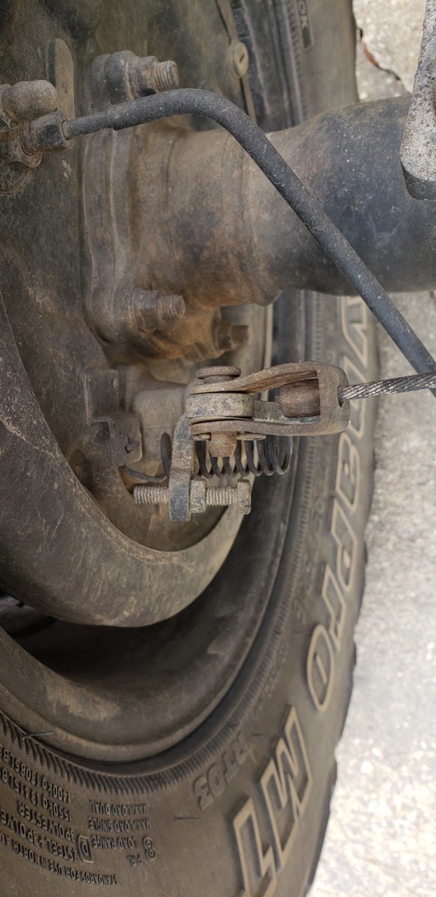

    E brake wire either runs above the housing or across, and this is dependent on 2002 and up vs 2001 and below.
    Everything else is the same when it comes to 4x4 and Prerunners.
    The difference also being a non locker 8.4" or an 8" with factory locker.
    Correct me if I'm wrong for those watching.

    Yep.
    Funny thing is, I remember @eon_blue and I noticed the difference by accident when we were talking about the bracket used for the brake proportioning valve unit.
    The cabling is just different between later models and early models but that's it.
