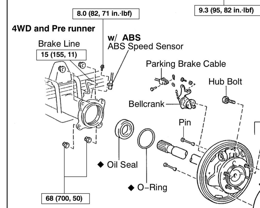

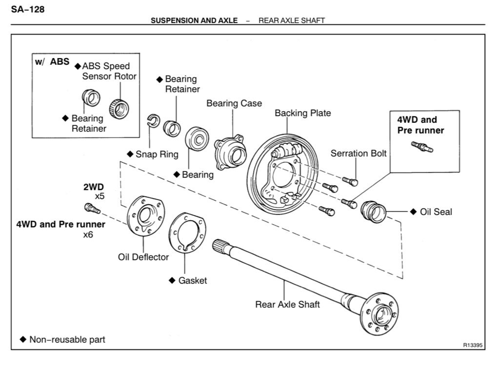

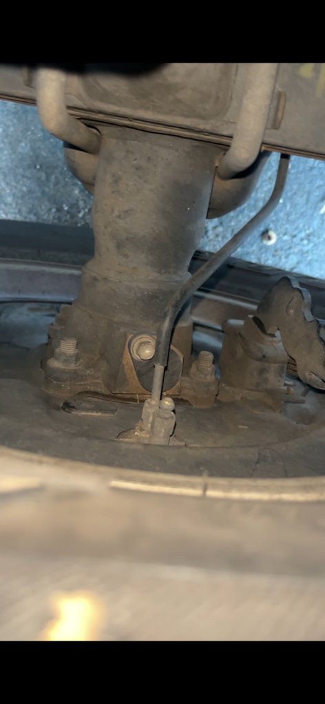

    I have a 2002 pre runner which I believe also has an ABS rear end but does not have ABS (I think I can spot the blocked off ABS sensor port in some pictures I took). Does this mean that my axle seal is recessed into the axle housing like in Timmy the Toolmans 4runner video? Or is my axle seal still flush with the end of the axle housing like in this video: https://www.youtube.com/watch?v=gRgkaYlrWLU

    is this true even for the Tacoma? If I have an ABS backend with no ABS (which I believe I do since I have a plastic cover over the ABS port, see pic below) - then what surface does my axle seal ride on? No ABS means no ABS tone ring which should mean no second bearing retainer either (which is where the oil seal normally rides). This is what is shown in the FSM too (see below). So what the heck am I missing?

    "Even for the Tacoma?" - You had me there for a minute b/c I was like... "even on?" since we're on TW. But then I realized the photo I posted was actually of my 3rd gen 4Runner, hahaha. Assuming you caught that, in which case, good work!
    If you have an ABS housing, I think the only place that the seal can sit is in the race that is inboard of the ABS tone ring. You'll still have two retainers (I believe) and you might even have the tone ring on the axle shaft (though, it's unused/does nothing in that case).
    Do you have an e-locker? If you do, all e-locker housings are ABS housings.

    haha yea I recognized your name and learned you had a 4runner a long time ago when I was looking at your drum brake tutorial (awesome btw) and couldn't figure out for the life of me why it wasn't matching the tacoma FSM lol.
    I do have an e-locker, so yea I should have the ABS housing.
    I'm just not convinced that I have a tone ring OR a second bearing retainer for the seal to ride on (since the FSM pictures I posted above don't show it). And because of that, I'm totally confused as to where my oil seal is located (recessed or not) and what surface it's sealing against. I'd like to take it off and replace it myself, but I don't have a press to be messing around with popping off bearing retainers and flipping them around and what not. I was hoping my seal was NOT recessed because that seems like a little easier of a job I guess (are the "redesigned" seals still problematic in this case?). Idk maybe this isn't a job for me haha. sounds like it requires a little more finesse than I'm capable of giving it.

    Yeah, if you have the e-locker, you definitely have an ABS housing and so the seal is going to be recessed.
    Regardless of which axle/housing you have, you'd still need to get at least one retainer off (and back on) to replace the bearing (which you should do if you've had gear oil leaking through it). So, you'll need to press either way.
    As for the FSM, what it means when it says "with ABS" is "with ABS housing," which is confusing for folks unfamiliar with the way Toyota does things, but pretty normal for Toyota.

    Agreed I should do bearings as well, just wondering if I could put it off for a little longer. It looks like I have a "slow" leak (I guess?) - dried up oil in the drums and a little bit of staining on the backing plate. The problem is, I need new drums and shoes right now regardless. Do you think it's a dumb idea to change the drums and shoes now but leave the seal and bearings alone for now and tackle them later? I guess my hope is that the leak was only due to a clogged diff vent (and not a true seal failure) and replacing that will fix the problem for now (and keep my new shoes clean). But if I ever get the full on "oil spun onto the wheel well" leak, I'll 100% replace the seals and bearings then. what do you think?

    Personal opinion is that if you're going to replace the seals, you should replace the bearings at the same time.
    If you didn't have oil splatter onto the wheel wells however, I'd be inclined to clean everything up well with brake cleaner, make sure that you've got the breather situation fixed (relocated), and then wait to see what happens. The seal/bearing job isn't difficult, but why do it if you don't have anything continuing to leak? (would be my approach). I'd also not replace the brake shoes (after a good cleaning), at least for a while, because I wouldn't want to ruin brand new shoes if the leak does appear in a month or two.
    Over that month or two, you can get a better sense of whether you need to replace the rear shoes at all, and my guess is that you won't have to, if the leak doesn't return.
