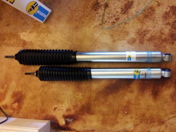

    Side by side rear 5100s, regular and long version.

    Thanks for the pic. Hopefully this will help put the issue to bed once and for all.

    I ran the regular length ones for awhile and wheeled fine but it did limit down travel. Best thing to do is measure your compresion/extension without the shock and go from there. I got the 9.25" 5125s and added a spacer under my bump stop. Based on the #s a 2" aal will have you close to 16" compressed/25" extended (that's my 3 leaf aal with overload). There's no point in running the shorter one with the numbers of 14/22 unless its for light trails where articulation isn't an issue!
    The longer ones look good for a larger rear lift like allpro's standard/expedition pack........that's what I'll probably end up with. AAL will wear out over time and is a very temperary fix. Mine softened up considerably in a year after light to moderate use.
