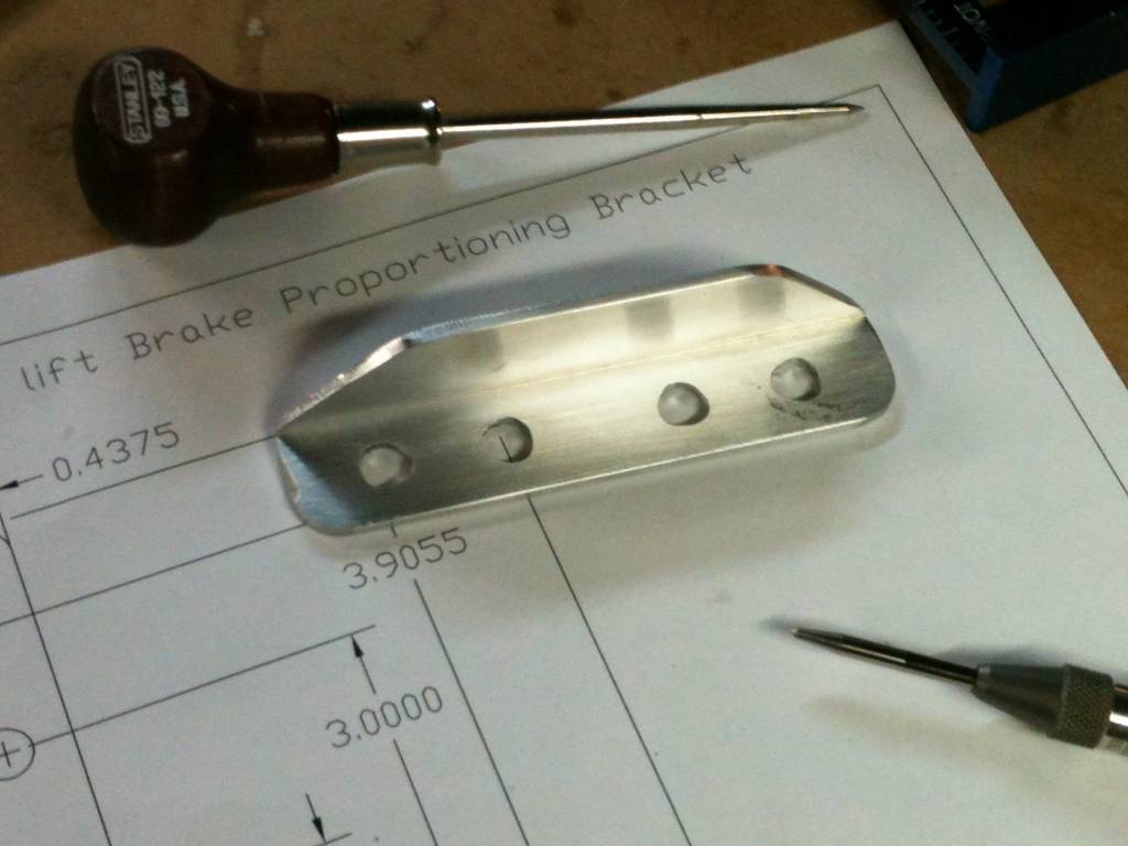

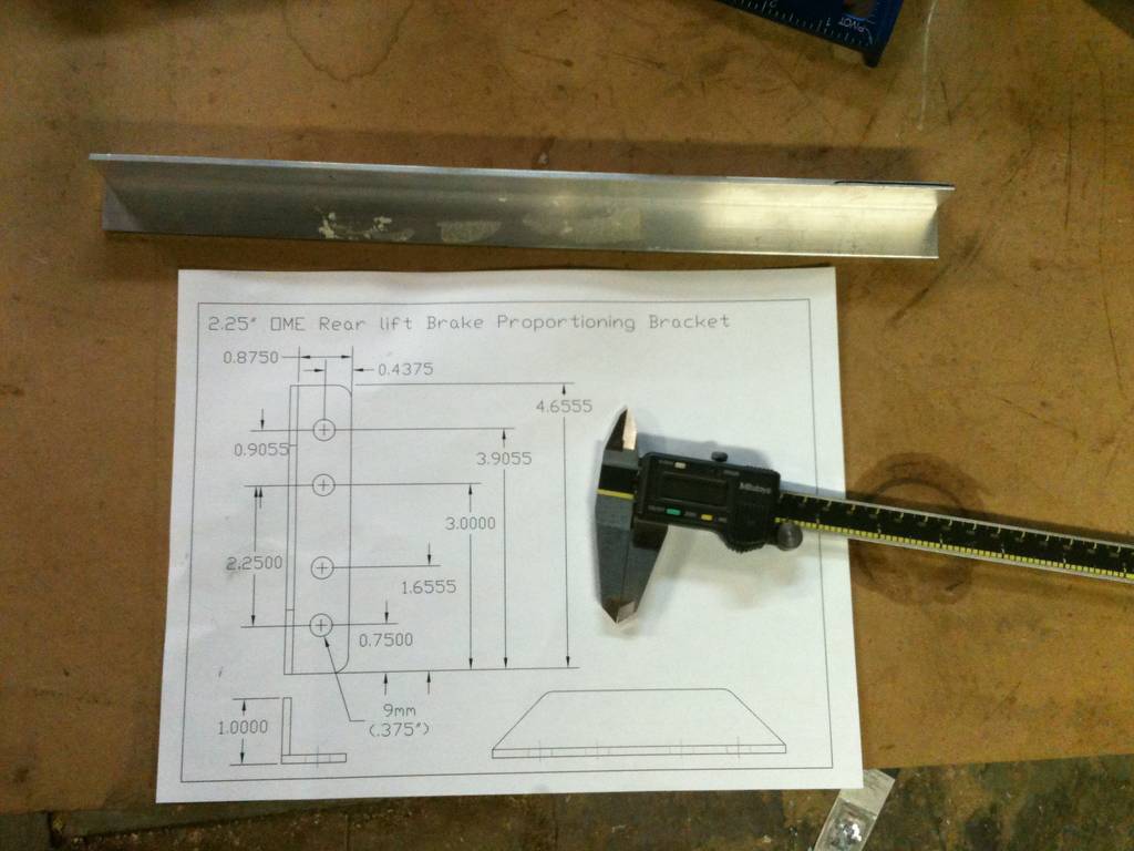

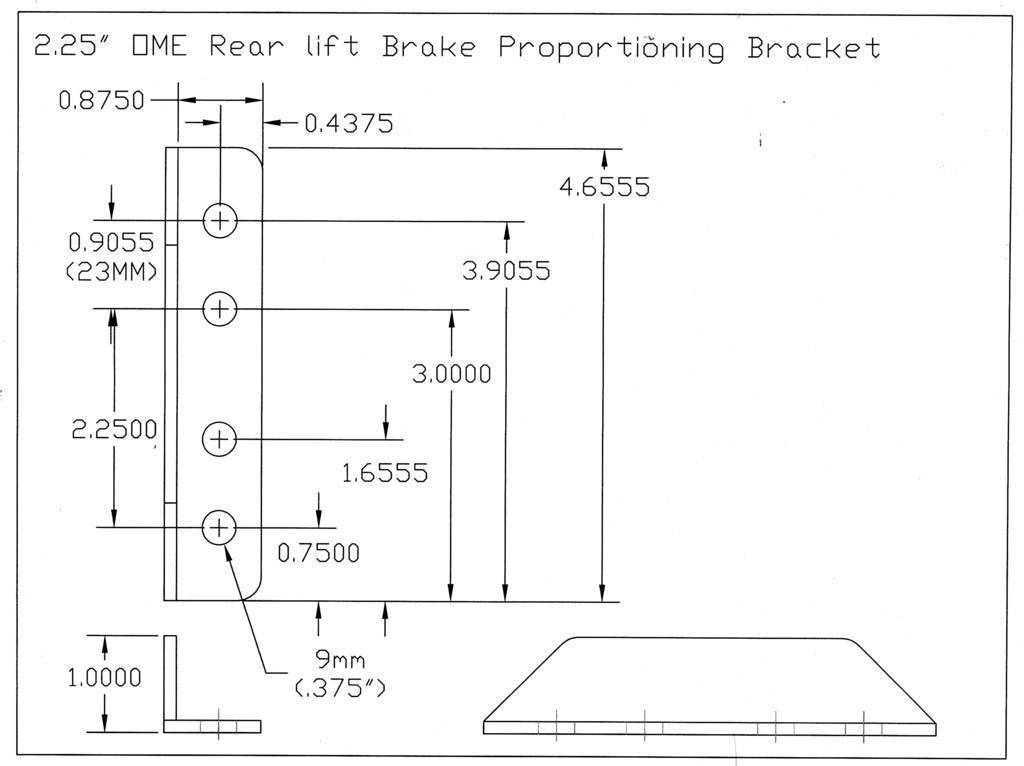

    I just fab'd one up today out of some scrap 1x1 aluminum angle I had laying around. I did some measurements of the existing hardware first. There are (2) M8 x 1.25 bolts 23MM apart holding the original bracket to the axle housing bracket. I gave mine a 2.25" rise for the OME Dakar leaf pack. Time from raw material to install on truck less than 1 hour.
    Quick Cad drawing:
    Raw material:

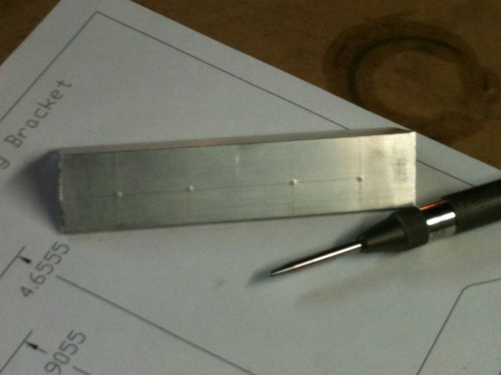

    I cut to length and laid out my holes:

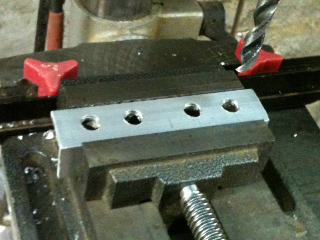

    Drill press set-up:
    All holes made, the original used 9MM holes, but I went with a .375 bit as that's what I had:

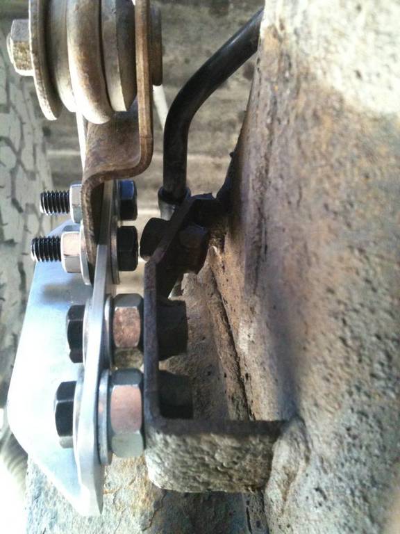

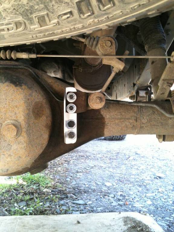

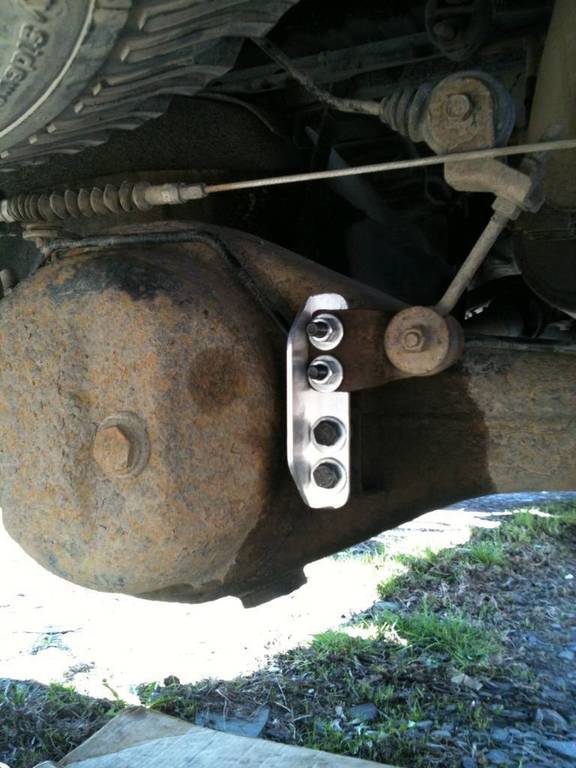

    Install on truck:
    I had to space the bracket off the axle housing bracket to avoid the brake line and other hardware (this is probably why one of the vendor brackets is offset a bit) and used new longer bolts:
