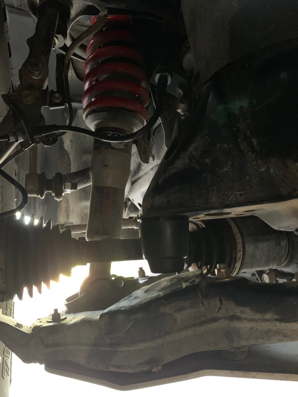

    Looking for some advice on my otherwise mostly stock 30k miles Fox suspension TRD Pro.
    I just received and installed a bump stop setup with flip kit from DuroBumps. Front was no issue and perfectly replaced the SuperBumps I had.
    The rear has me scratching my head. I wanted to upgrade the rear bump stops since the bottoming out gets a bit harsh at times, either with a full bed load or doing some offroad track stuff. Stock bump stops don't do well with bigger high speed bumps.
    Anyway, after install, I'm left with maybe 1.5" of space between the bump stop and the frame. They are advertised as working with stock suspension, but I can definitely feel them hitting around town on speed bumps, etc. I like the idea of a flip kit but the bracket & bump stop combo take up a lot of room. These are the 3.5" (smallest) ones they offer.
    Advice? Thoughts? Go back to stock until I get a lift?

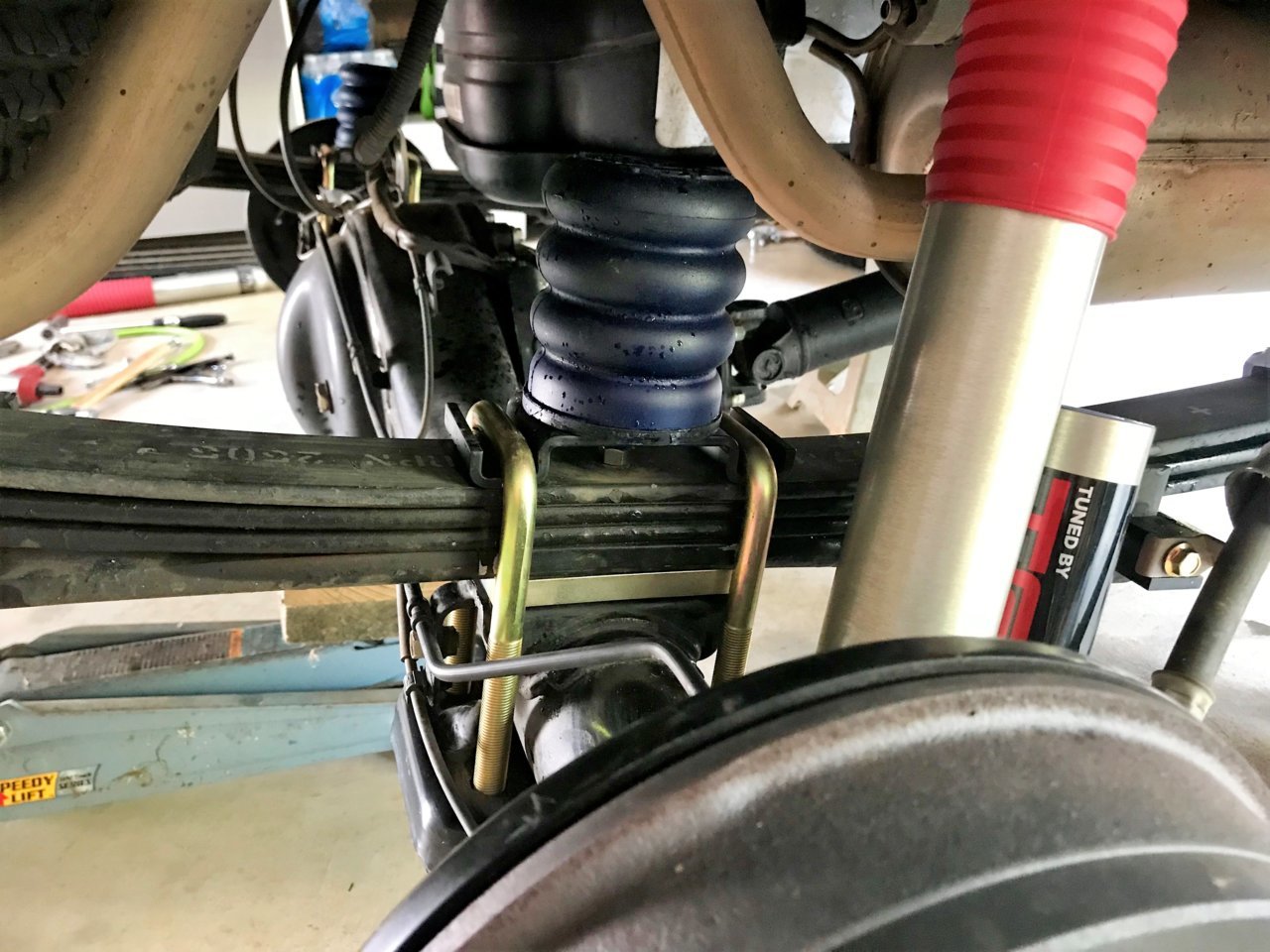

    You might want to consider SumoSprings. They replace your factory bump stops, support heavy loads, yet ride smooth as silk on the road. I love these things. Great for pulling the boat, hauling weight in the bed, or serving as a premium bump stops. Truck is on jack stands in the photo. When sitting on the ground there is about 1/2 inch gap between the Sumo and the frame. Great product, but they are not cheap. https://www.supersprings.com/shop/SSR-612-40

    I see that you have trd pro shocks on ur truck. I do as well but with stock leafs. Can you let me know how much weight u can have on the bed before the frame hits the sumo springs? With a canopy, I carry about 200 lbs all the time and during the summer months, around 400lbs with all my gear. Wondering if I need to get the heavy duty ones.
