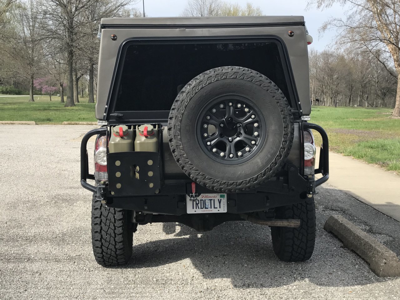

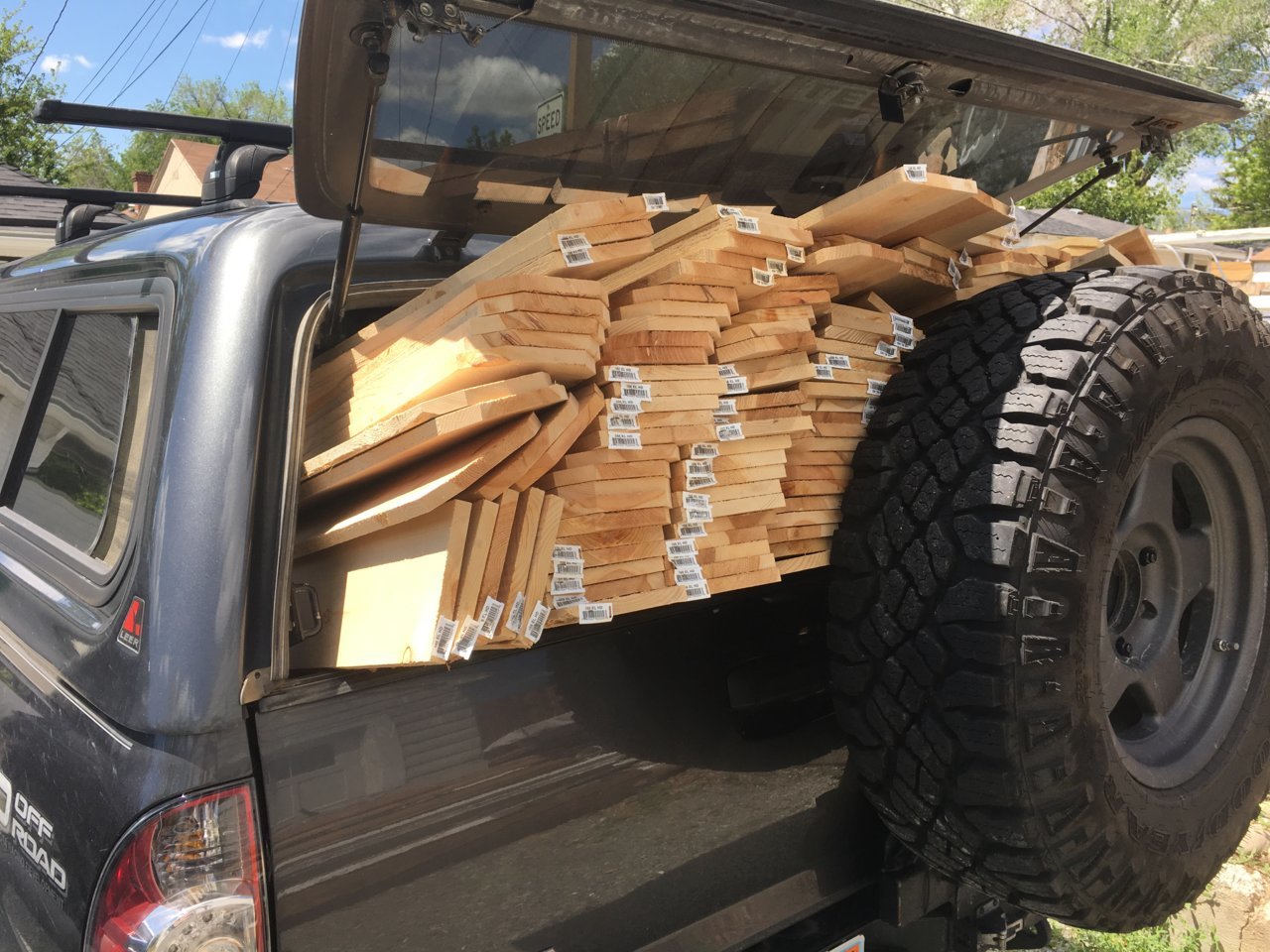

    Yep, it's a Kilroy, great little kayak for fly fishing.
    Much appreciated! I forgot it open one time with a trailer hooked up but luckily I made a left turn so it didn't crush the swingout haha.
    2013XSPX[QUOTED][OP] likes this.

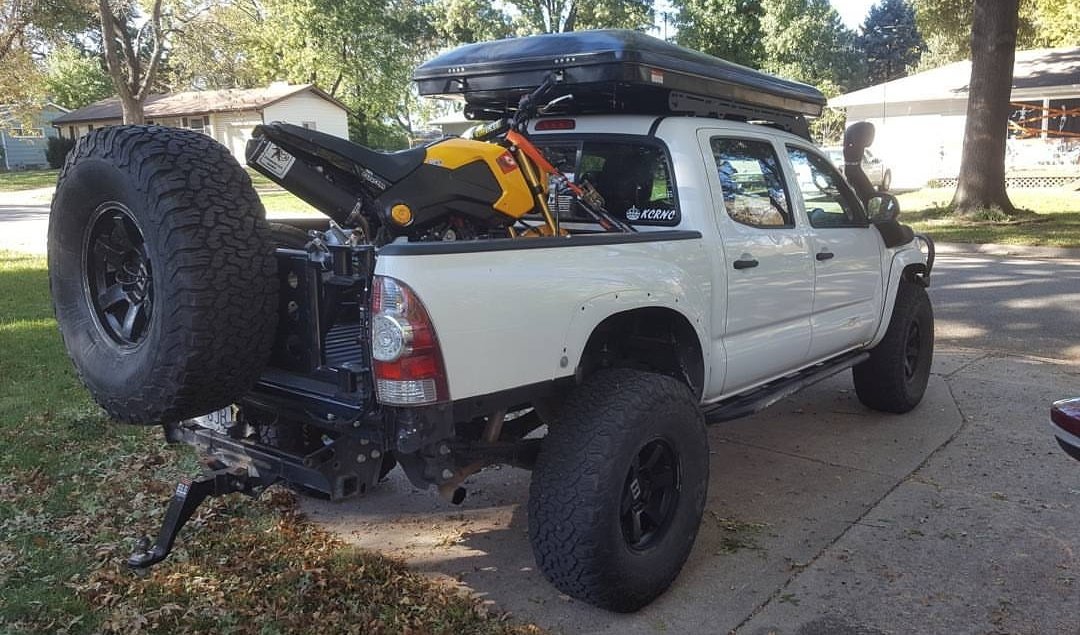

    I'm running a bruteforce high clearance with a single swingout. This allows me to carry 2 spares and I'm not dragging my receiver all the time offroad anymore.
    Visibility isn't great but I can still see well enough and I relocated my backup cam and have the ability to turn it on anytime if needed.
    It's not a big deal to open it to get into the bed if needed and I've never been in a situation where I didn't have room to open it. A longer swingout could be problematic though. Also, a table would be pointless since the swingout is barely longer that my tailgate when everything is open.
    One inconvenience is that I have to remove the spare from the swingout when towing our travel trailer because the tongue jack on the trailer contacts the tire. This isn't a problem with our boat or a utility trailer that I borrow a few times a year. Another inconvenience is when hauling things that are longer than the bed you can't leave the tailgate down.

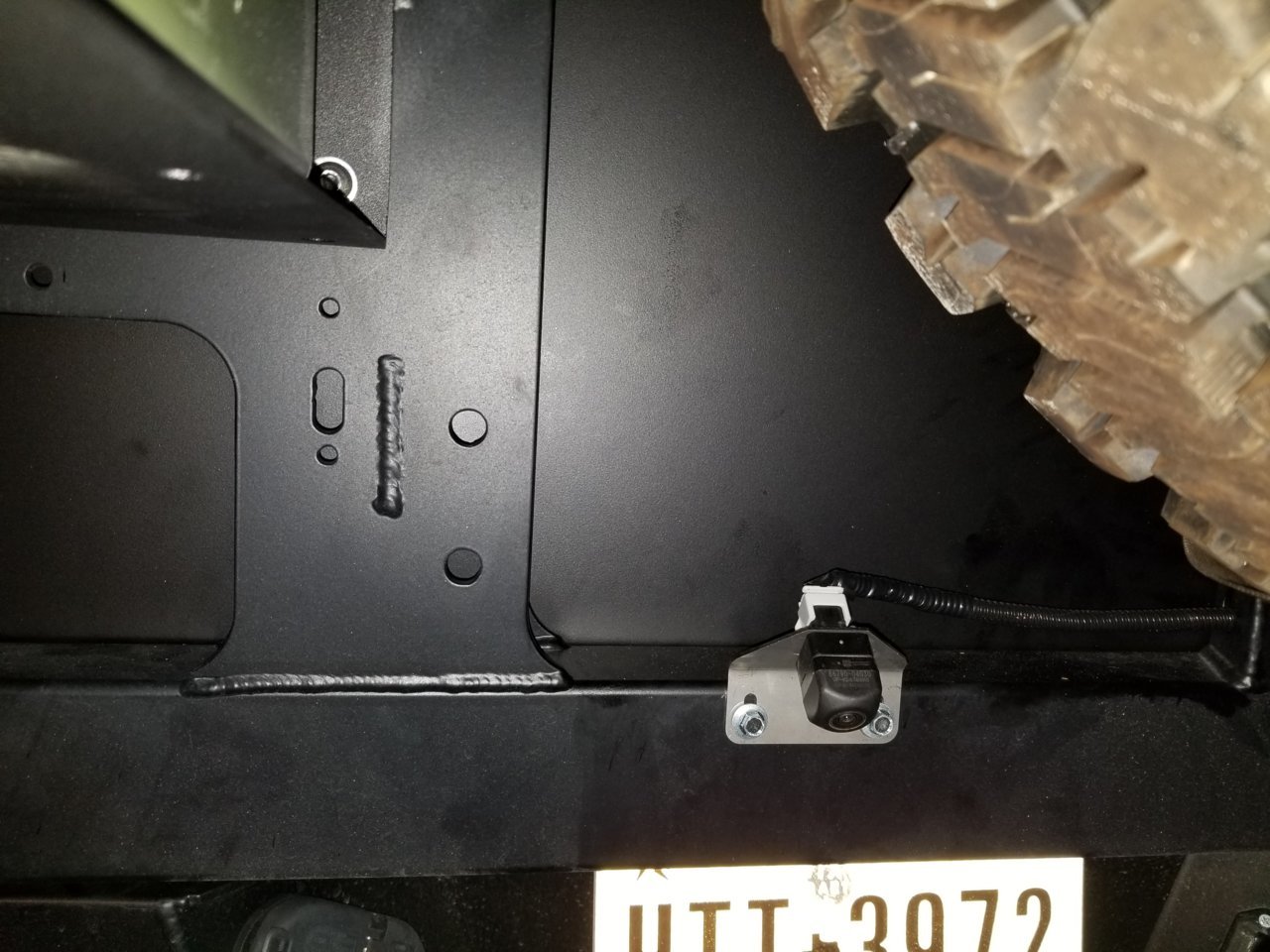

    I am looking for feedback about rear bumpers with swing out spare tire carriers.
    How's your visibility effected? I tend to use my side mirrors more anyways but it will have an impact. Blocks some annoying headlights though.
    Why did you choose a single or dual swing out? I went with the dual so I could do water/gas carrier and full size spare tire. Also my water pump easily reaches the carrier.
    Would you change anything about your setup? Maybe only to shift my water/gas carrier over a few inches for other unforeseen items
    Is the built in table worth the $150+ ? Not for me though I liked the idea. Like mentioned, with tailgate down, it's kind of a waste. IMO
    Powder coat, Line-X or rattle can? Powder coat
    I did have to use an extension from Harbor Freight and drill an additional hole to be able to use my bike rack
    Water lines mounted

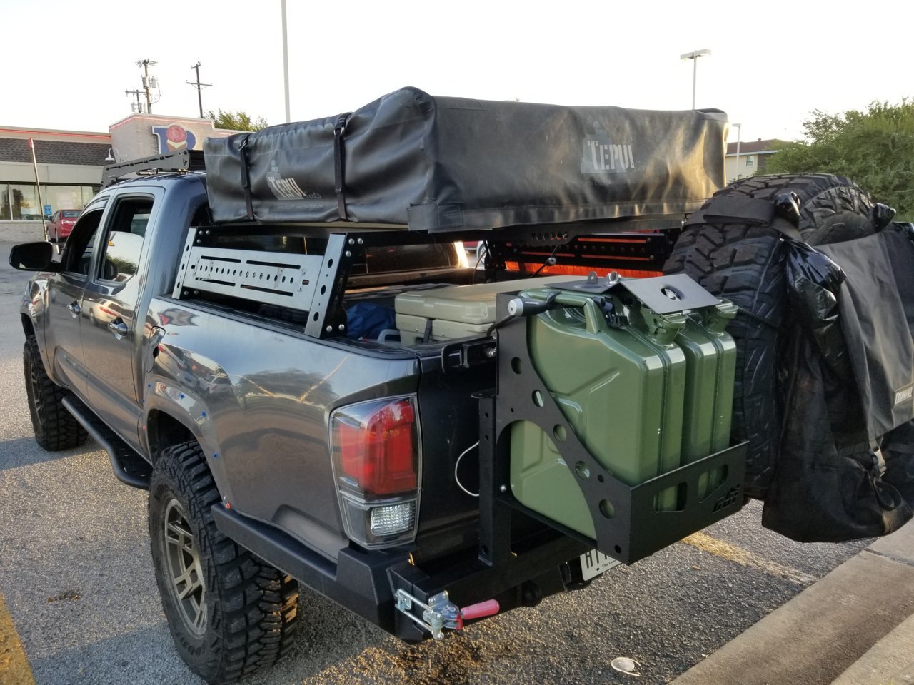

    Truck stuff
    Well I'm a 3rd gen but the form and function are basically the same for all your questions.
    With no bed rack I lost about 1/2-2/3's of the visibility from the rear view. I almost always have my mid height bedrack on which causes me to lose all rear view mirror visibility.
    I chose to go with the single swing out for cost and a bigger table.
    If I did it over I would go with dual swing out for less weight and room needed to open.
    The one on my single I find useful but I honestly rarely use it. I dont think I would spend the money for one on a dual swing out.
    Powder coat. Yes if you use your truck you will scratch it off and I'm ok with that and touch it up with spray on bed liner. I painted my front bumper and decided from them on all bumpers will get an initial powder coat and then just touch it up with paint.
    Impoy47 and 2013XSPX[OP] like this.

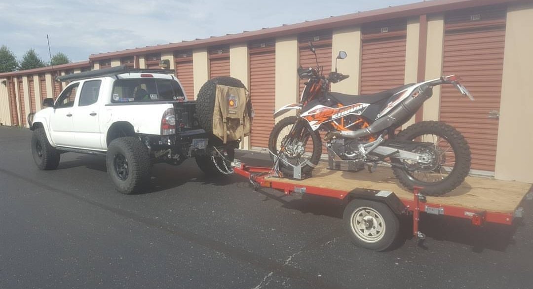

    I wheel allot more than I go touring in the Tacoma so I bought this bumper. Dual swingout bars with extra pipe armor on the sides.
    It works great and does what I wanted it to do. Departure is much better, I can still tow, and the side bars keep my taillight assemblies intact. I never moved the backup camera so the tire blocks about 85% of its view but I grew up using mirrors so no real annoyance to me.
    Pulling the bed and bumper off soonish to take a different turn with it but I have no problem recommending them to those that are interested.

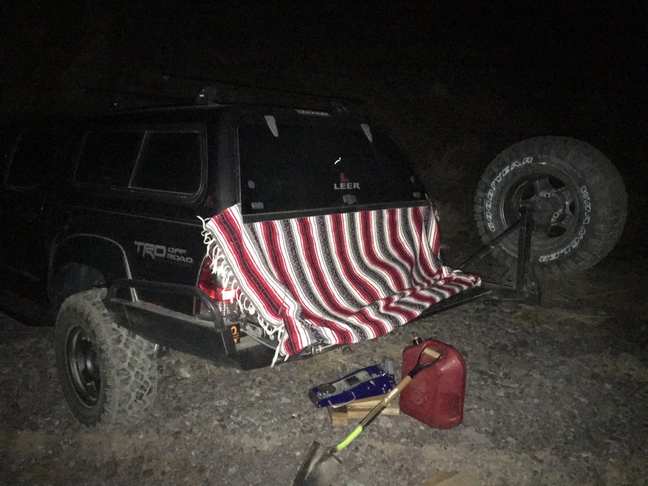

    Have you thought about a tiregate?
    I do agree with many that i wouldnt go back to a swingout style ever. The tiregate at least kept the tire close to the truck but i use my truck bed too much. It was annoying to open, annoying to have to grab the trailer for stuff that otherwise could have been in the bed.
    I still had plenty of room to see though and i had relocated the camera so that wasnt an issue.
    I have my 315/75/16 shoved in the stock location under the bed currently. I got tired of moving it in and out. If i go wheeling id move it into the bed though

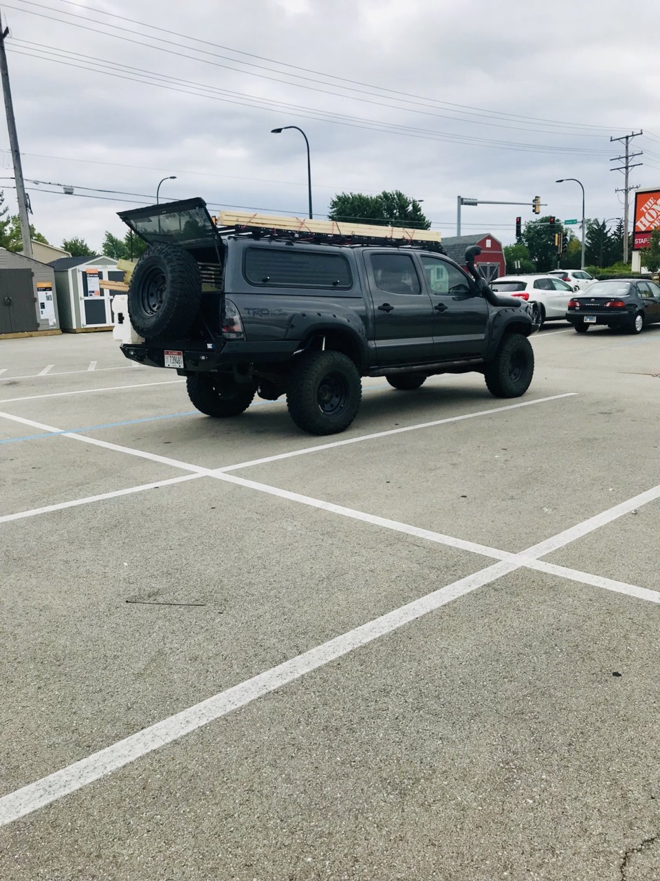

    My BruteForceFab single swing is somewhere between ordered and fabricated. I went single swing with table. I've definitely heard the dual swingouts have tiny tables that aren't much use, but the single swing table is usually worth it. I don't plan on mounting a spare on it, I'll have a case with my eccotemp L5 water heater with 12v water pump in it's place. Will also have a water jug and propane on the swingout so my entire hot water system will be there. Figure the table will make a great place to wash dishes.
