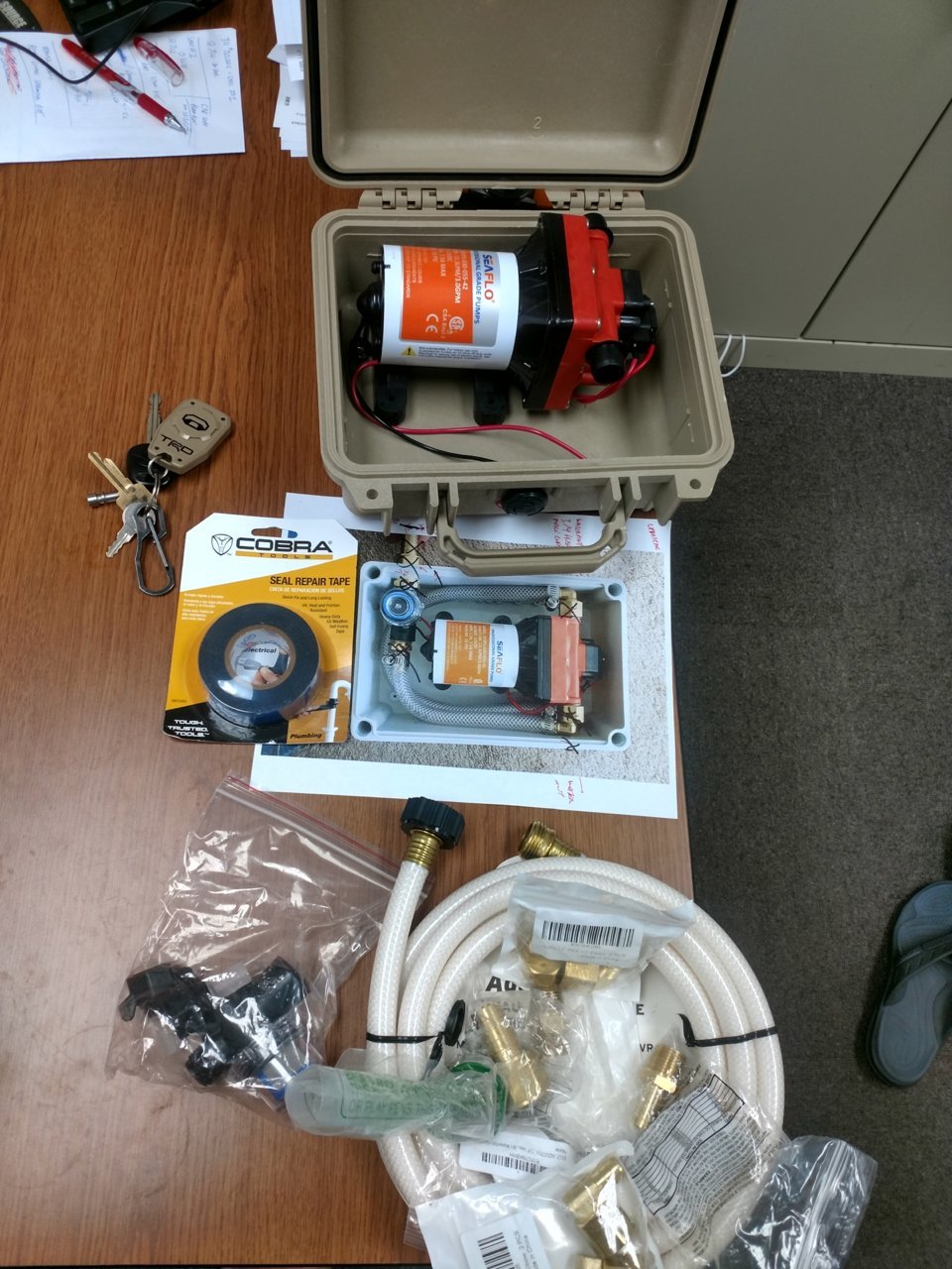

    Awesome! We've only used our hot water twice so far. It was great. The case with everything in it is a bit of a pain currently though. Just big and awkward mainly. Can't wait to get it mounted on a swingout. Hoping it'll get here early October.
    We got this sprayer and really like it. Was much better than what came with our water heater.

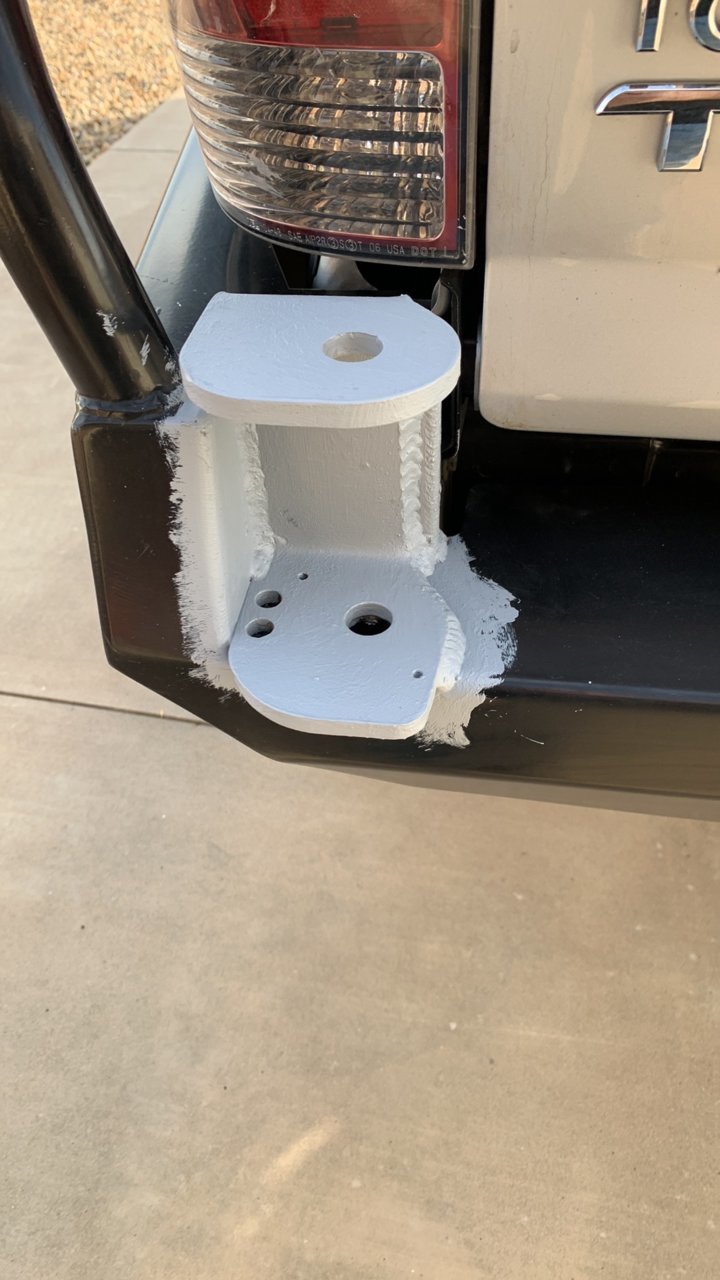

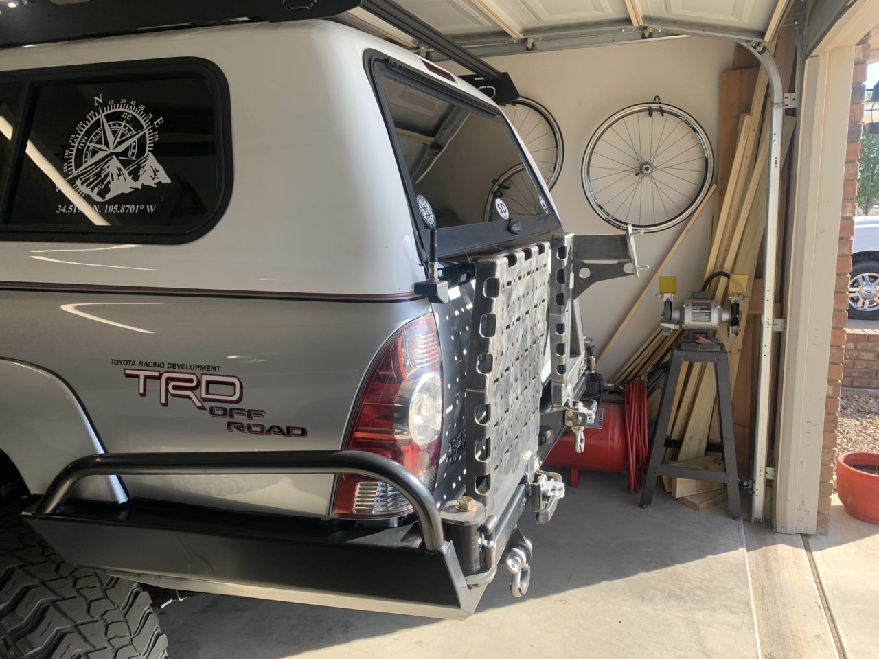

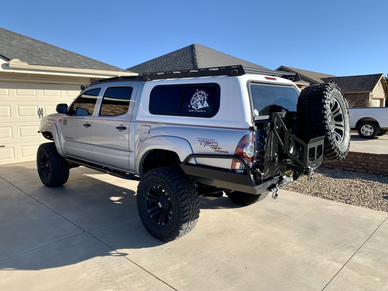

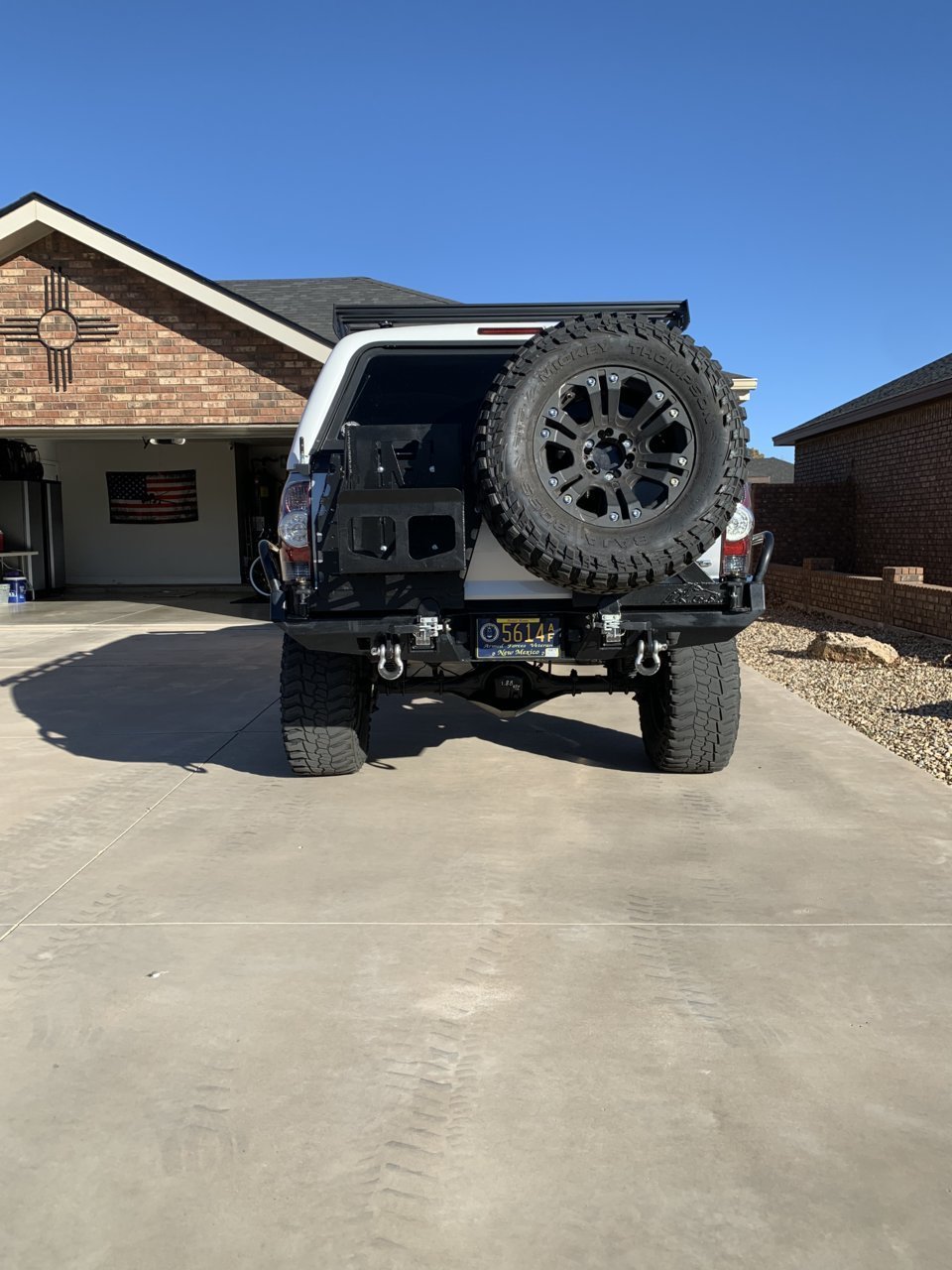

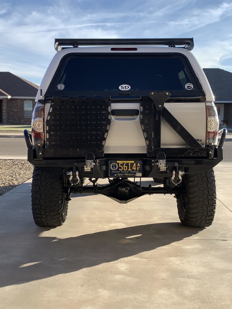

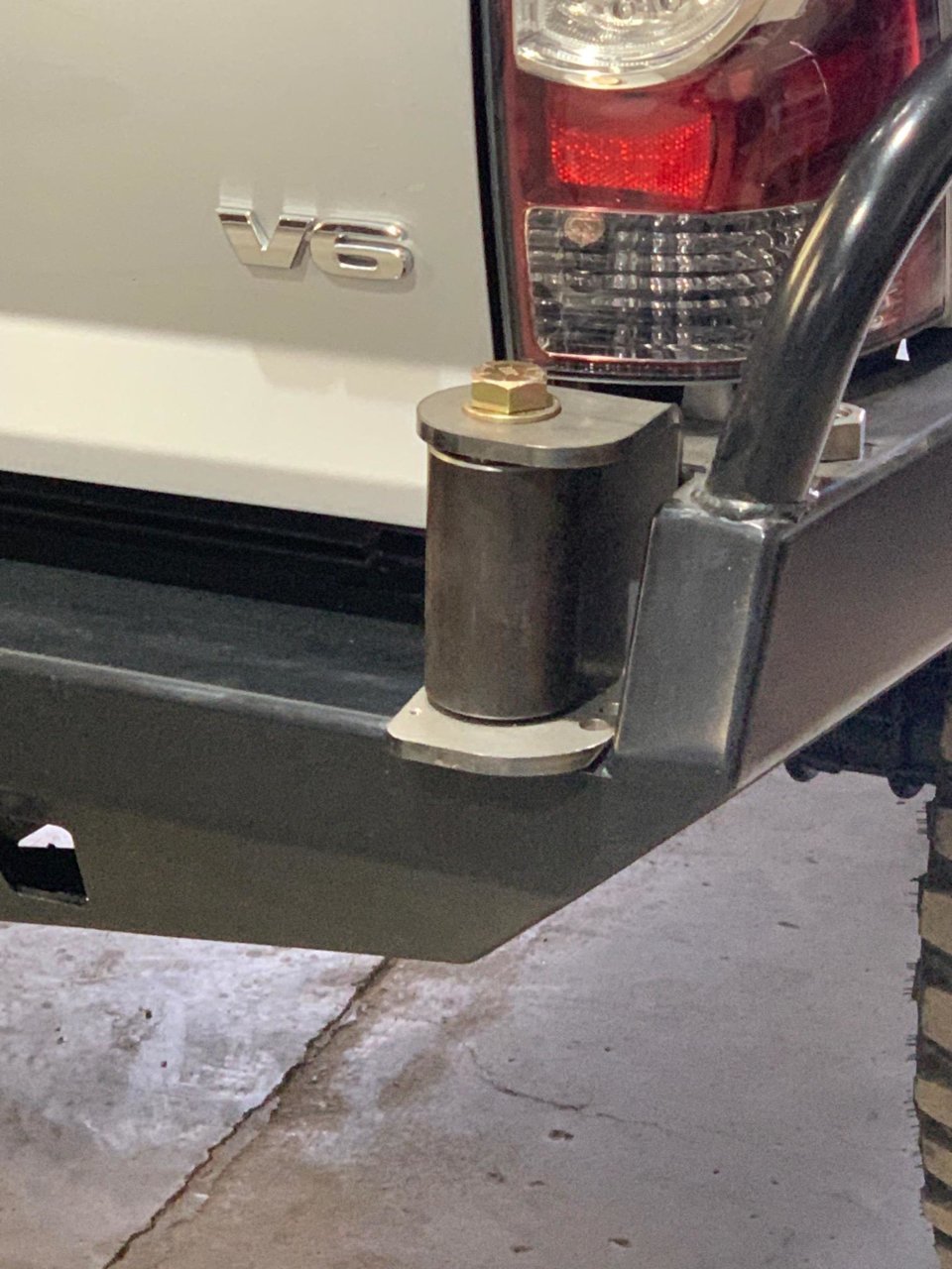

    PO installed a Brute Force Fab HC rear bumper without swingouts. I recently had SOB Fabrications (Ruidoso New Mexico) build dual shear custom dual swing outs. Extremely pleased with the decision and end result.

    Do you have a up close side view picture and of the shear tabs welded to the bumper. Planning to do the same but wanna see what type of hinge n stopper u used and how far it sticks out. Lmk. Thanks. Solid truck

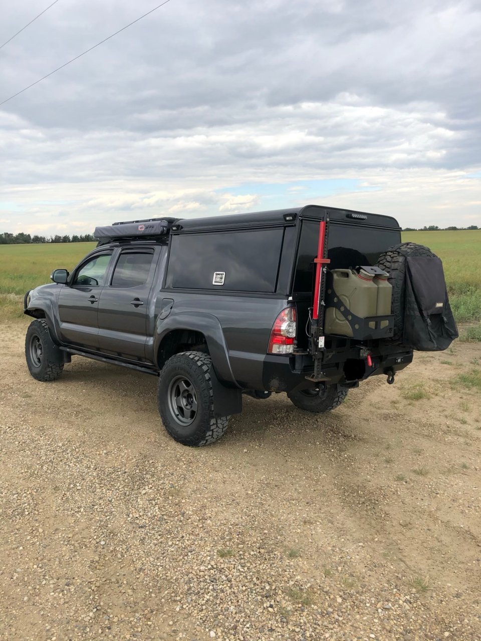

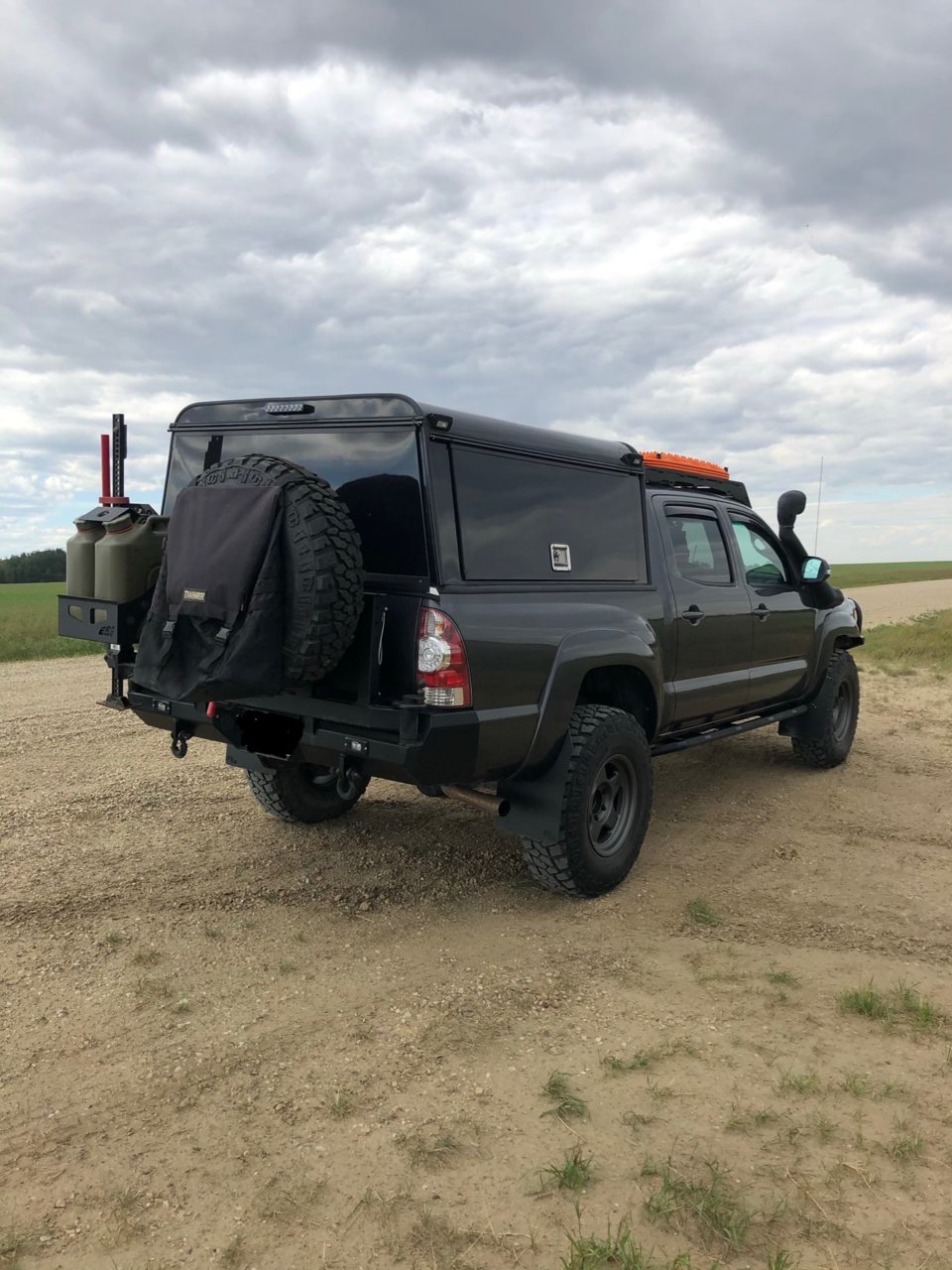

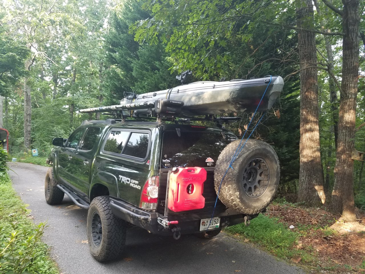

    Very late to the thread but oh well it may help others in the future.
    How's your visibility effected? What visibility. Backup cam sees nothing but could be relocated if required. I can't use my rear view mirror either due to the cap so it's just side mirrors for me.
    Why did you choose a single or dual swing out? Dual. The length of the single is 4'ish and makes opening the swing out difficult in parking lots and garages. The dual is a nice option which allows me to keep the swing arms open in the closed garage when loading/unloading. The dual swing arms also breaks up the weight to two pivot points.
    Would you change anything about your setup? No, I made the right choice with the dual swingouts. Well, now that I think about it, I maybe would have done a high clearance bumper with dual swingouts.
    Is the built in table worth the $150+ ? I have two smaller tables but yes they are worth it IMO.
    Powder coat, Line-X or rattle can? Powder coat (nice weather crappy powder coat that isn't best for my climate but is holding up ok since it's not daily driven). I can touch up the areas with spray paint but if I did it again, I'd likely Line-X it.
