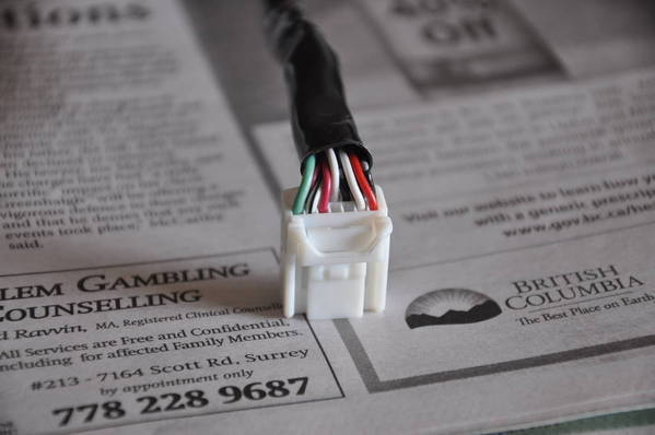

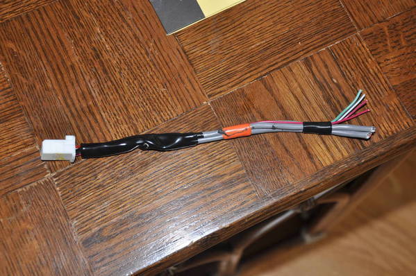

    I have a pigtail for a stock mirror out of a 2010. I think Gentex makes the stock mirror for Toyota, so it should fit. I will try to post a pic tomorrow.

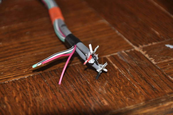

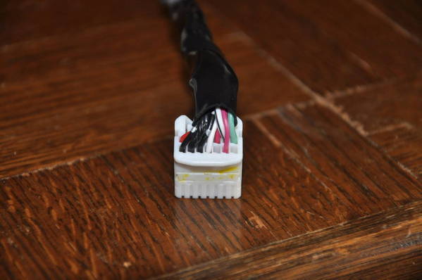

    Pics as promised:

    Thanks for the pictures, this is what I have in the headliner, although your's got more wires. I guess I'll just rig something up instead of trying to find an adapter (the piece that continues from the end on the pictures to the jack in the mirror).

    Sorry, I thought the harness was what you meant. This unit plugs directly into the mirror mount post on a 2010 style mirror, so I didn't need any adapter.
    I had to go to Toyota to get the wire cover piece and I noticed on the parts list that the setup for 2009 was a little different.
    It looks like the harness plugs into the back of the mirror itself- slightly off to one side. I am wondering if this is the type you have? If so, I thought the adapter might be available from Toyota- though their parts diagrams are a little vague. Also, some of the Tacoma specific adapters are available from Gentex website.
