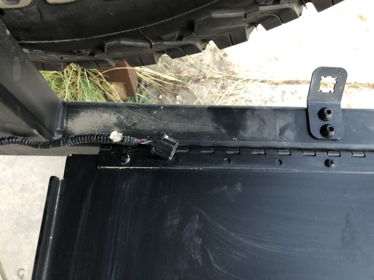

    I just recently installed a rear bumper/tire carrier by 4xInnovations which came with a rear camera mount located on the tire swing-out. I was able to remove the camera, unfortunately the cable won’t reach the camera mount. I’m sure this question has been asked a million times:-/
    Is there a way to extend the wire harness or do they make an aftermarket extended camera wire harness?

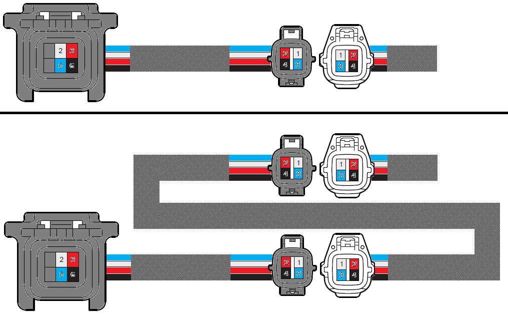

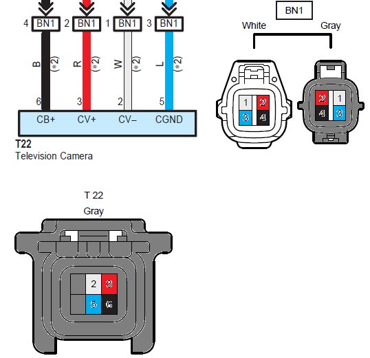

    If you have the covers for when you remove the tailgate then you have the matching connector to attach an extra tailgate camera harness.
    https://www.amazon.com/TOYOTA-82182-04020-Wire-Tail-GATE/dp/B07XFGRPT7
    Purchase the harness, de-pin the terminals on the connector going to the camera. Insert these terminals into the matching connector that goes to the tailgate side. Now you have 2 harness inline for additional distance.

    Where on the swingout does the camera mount and how much more slack do you need?
    I relocated my camera (different bumper fabricator) and have a few inches of excess slack still.

    60F09149-C28D-49D9-ADAC-B5CBAC2355A2.jpg Mounting bracket is in the middle of the swing arm. As you can see I’m short by approximately 6 inches:-/
