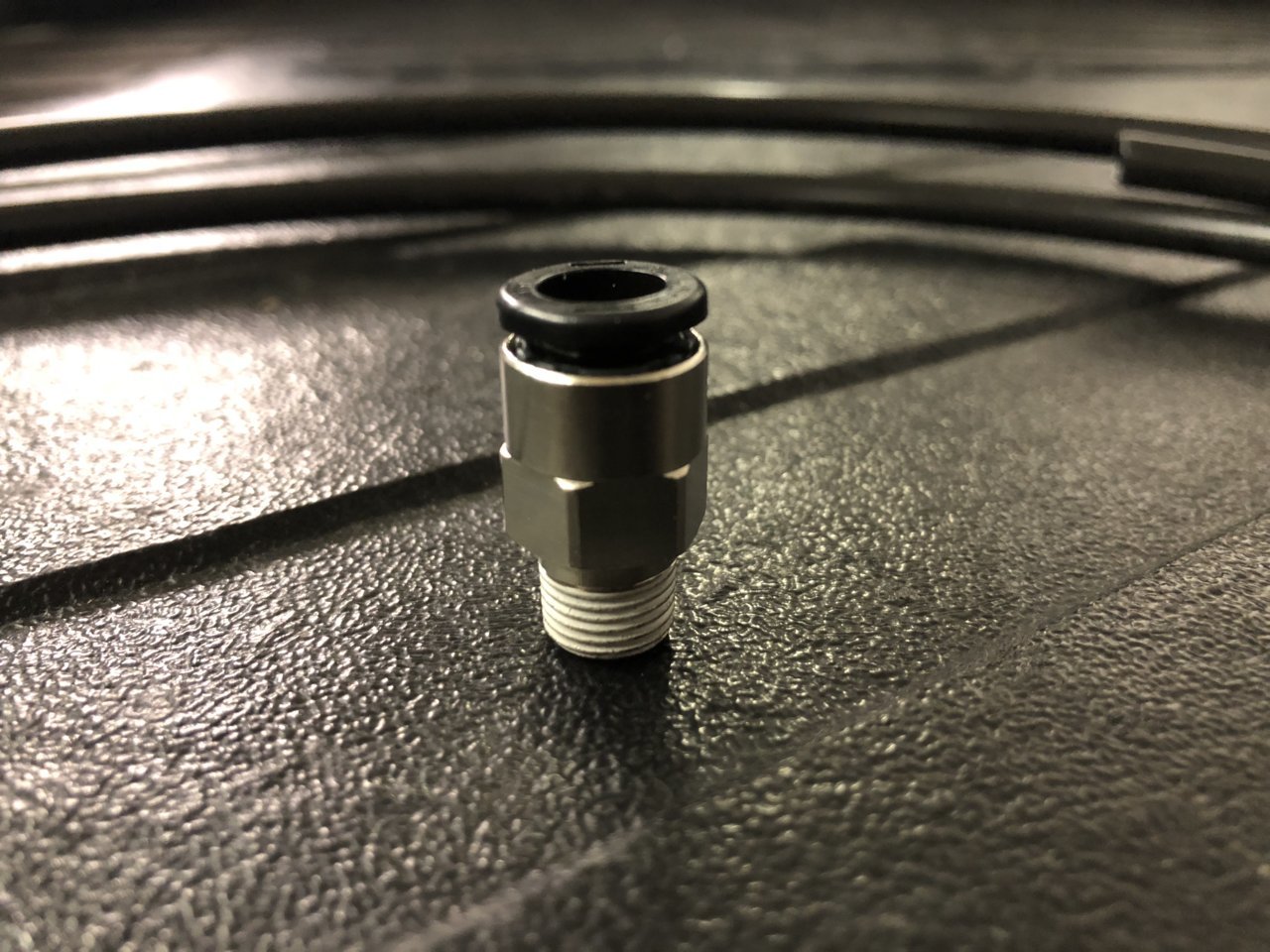

    A couple weeks ago I did the ARB rear diff breather relocation and REPLACED the one way OEM breather with the ARB two way breather.
    When I unscrewed the OEM breather a shit ton of air came out of the rear diff I mean a ton, it was highly pressurized. I thought it was odd and checked the breather valve, it was closed both ways. Nothing in, nothing out.
    These one way valves become no way valves and pressurize the diffs and Tcase (I suspect) and blow gear oil through the seals and creates the seaping that everyone is experiencing. Change these out to completely open two way breathers as soon as you can. Relocating the existing OEM breather is of no help.

    I’m talking about whatever Toyota OEM puts on there, it’s a one way breather meaning air goes out and no air goes in. It gets clogged and old and sometimes filled with fluid and becomes a no way breather valve, nothing in and nothing out and the case become highly pressurized. I know because mine did this.
    I’ve changed out the rear to the ARB two way relocated to the bed storage and doing the front diff, Tcase and manual trans breathers in the front to two ways soon, as well.
    Here’s the ARB which is completely open on both ends.
