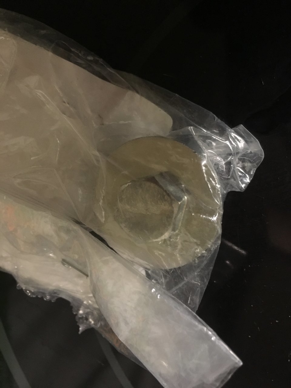

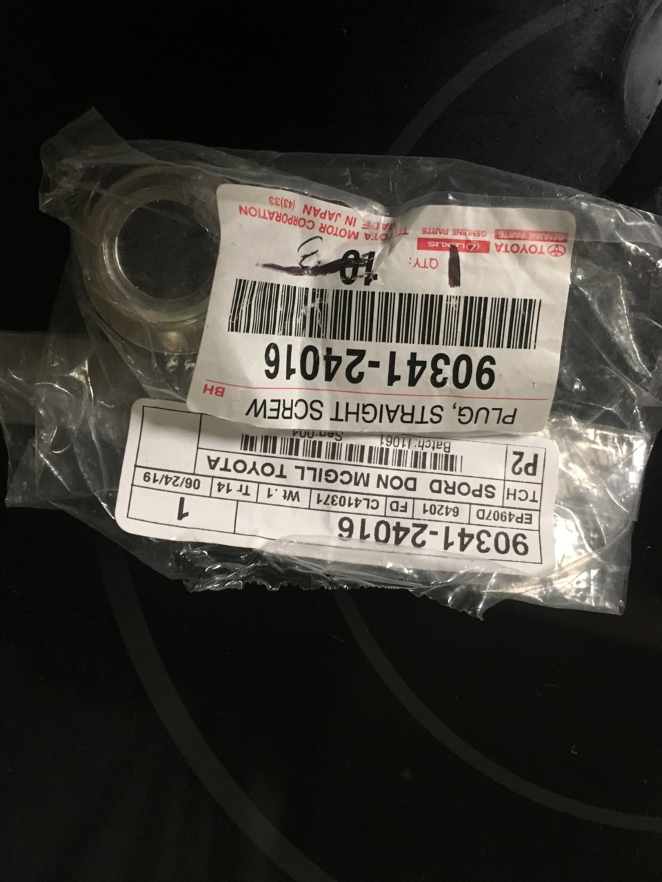

    For the front diff drain, I’d go with Lexus part number 90341-24016. It has a 14mm nut type thing instead of the 10mm hex from hell.

    2010 Tacoma TRD Sport Access cab 4x4 silver streak
    Same here, but I decided to get the Lexus one and just swap drain plugs next time I change the front diff fluid. It was cheap enough, $10 or so
