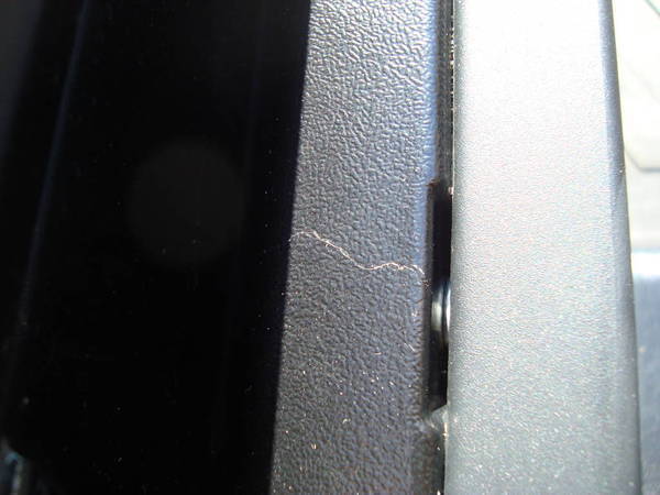

    My elock diff went out at 58,000. I had the diff locked when it went, but I wasnt giving it much throttle when it went. I was going through a ditch and the most embarrassing part was having to get towed out by a ford. It was dissappointing, if it goes again, I will look at heavier axle options or larger ring and pinion to replace it with.
    [​IMG][​IMG][​IMG][​IMG]
