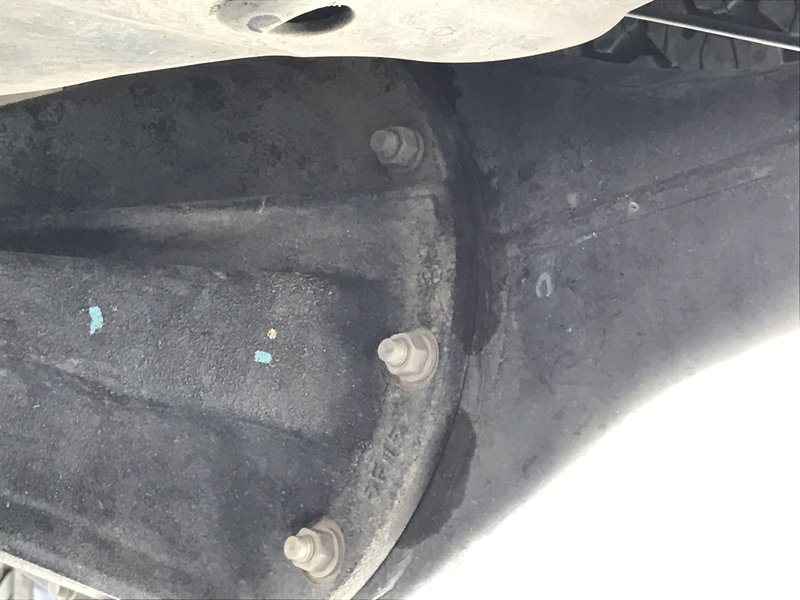

    IMG_8213.jpg Should I worry about this? Look like diff is seeping.

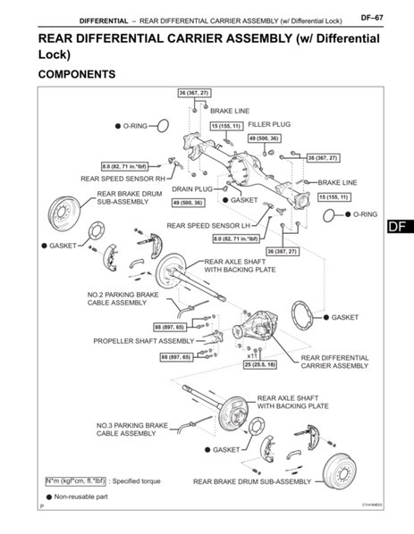

    Should be fine. Just check the fasteners and retorque to factory spec in criss cross pattern. If it starts dripping, it would be a concern, that's just weeping. Let me see if I can get a screenshot of the torque values for you from the FSM.

    I'd clean the area with some degreasing spray and keep an eye on it. See how soon it returns afterwards. If it comes back quick, I'd take it in.

    Hit it with brake clean and keep a eye on it . It should not keep seeping.

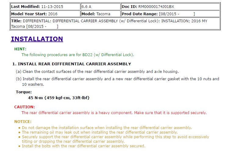

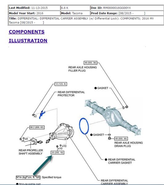

    Manual puts the nuts at 18 lbs. In any case being a new truck, I'd mention this at your next Toyota care appointment. It may not be a problem now, but if it becomes a problem down the road, they will have documentation that you pointed it out and whatever they did to address it (check fluid, retorque bolts, etc...). CYA.

    There is a discrepancy in the manual???
    I just saw the 18 value also...
