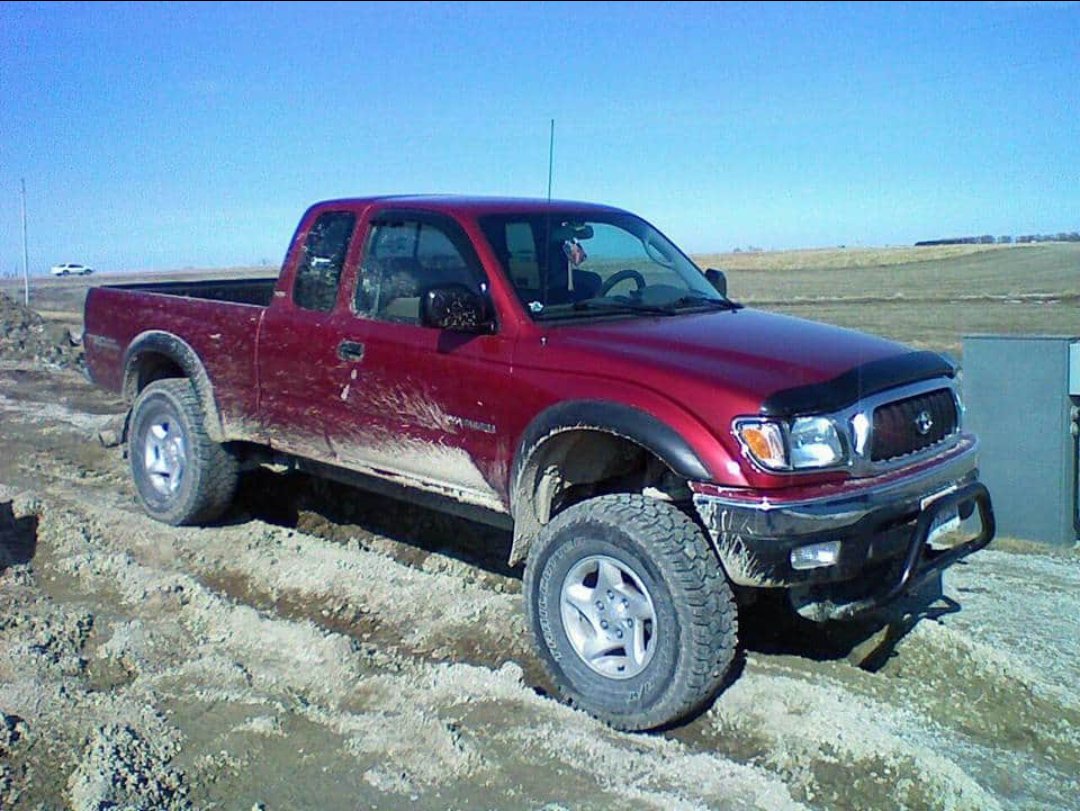

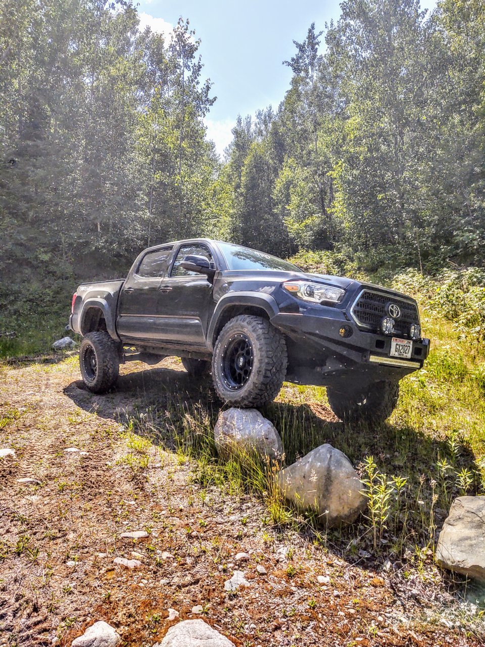

    Absofuckinlutely!
    It was so simple on the first gen... And hands down my favorite mod! I kinda miss the old girl...Screenshot_20200717-222052.jpg
