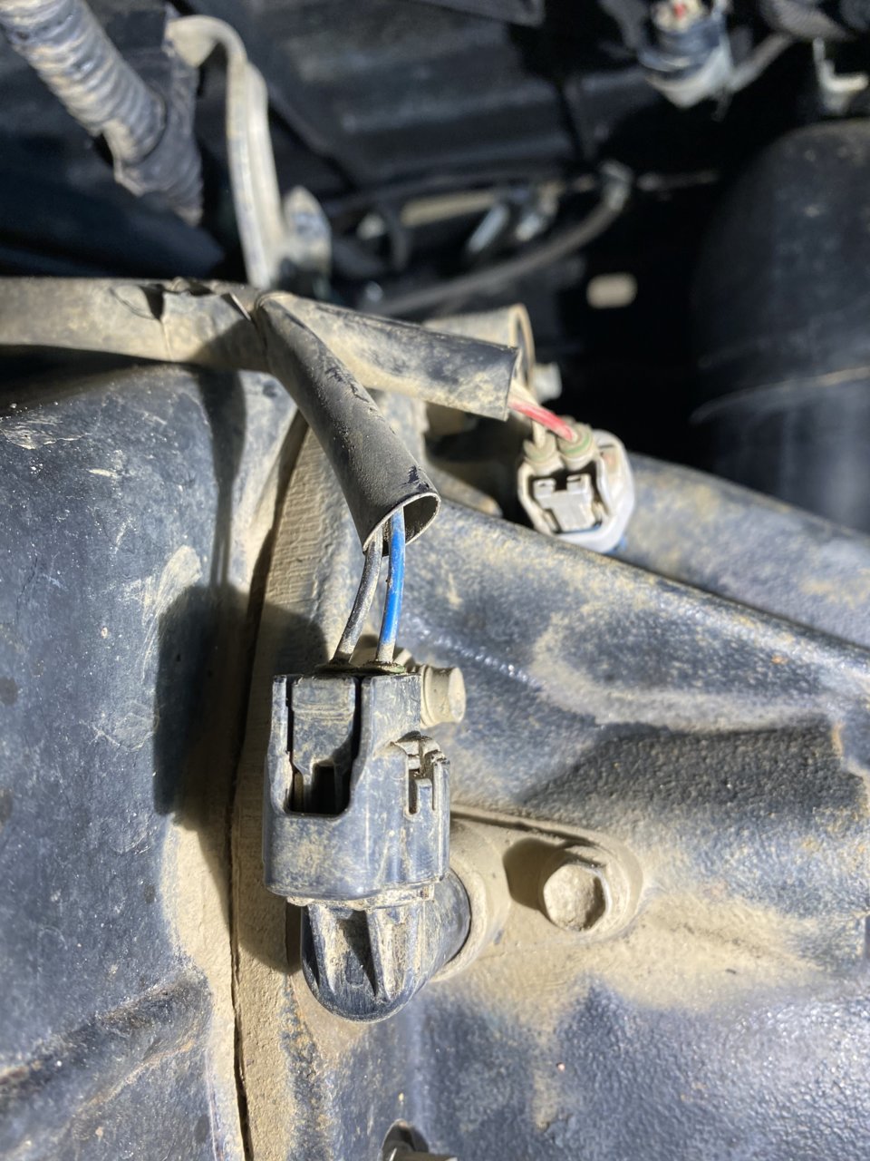

    Can anyone tell me what these wires are? Red= White= and blue= black=. Sorry in advance for my ignorance.

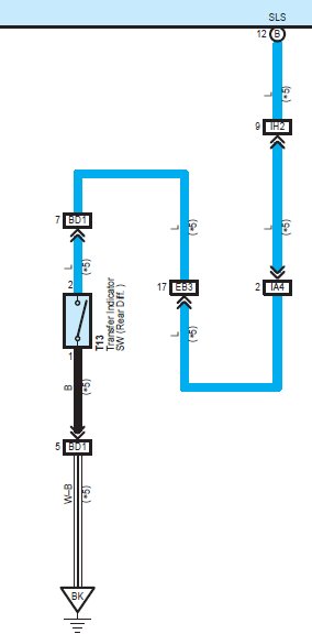

    Black/blue is the lock indicator switch. When locked, it sends a ground signal to the 4wd ecu.

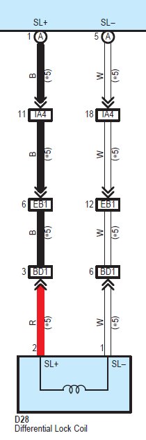

    Red/white is the lock coil. It recieves a PWM current from the 4wd ecu to engage the locker.

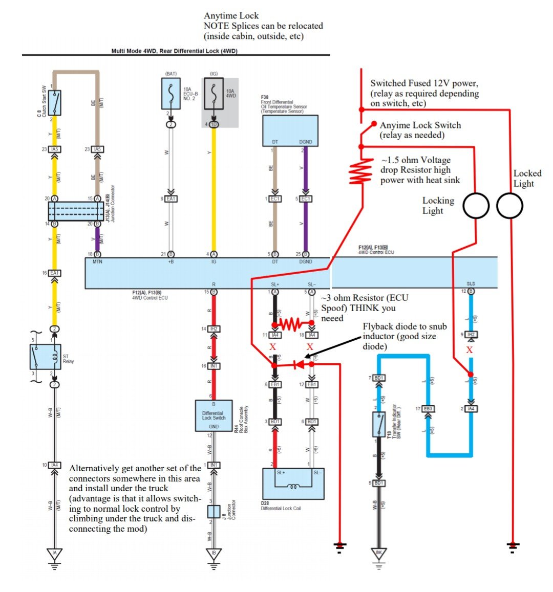

    cnstaco[QUOTED] and ShimStack like this.

    To spoof the ECU, did you try a switch between the locked indicator and ECU to prevent a locked signal being sent to the ECU while powering the coil with your separate power source?
    BigWhiteTRD[OP] likes this.

    In the end, as you describe is the only method that has been proved functional. As you say, you have to prevent the lock feedback signal reaching the ECU, because that will throw a code if the ECU isnt commanding the rear locked, but the computer receives the lock signal.
    So far, all the installations/tests I have supported have used some power resistors to reduce the voltage to the coil to approximately the same level as the ECU applies... (it might be acceptable to skip this voltage reduction, but I don't have any proof that the coil is OK at 14V, and I am not trying it myself). And also add a flyback diode so the coil inductance doesn't damage the relay.
    Never found a 'good' way to cancel ABS, etc... like the Toyota installation does. Never found an elegant way to activate the locker besides this method, which I dont consider very elegant...

    Ok so if I cut the wires and splice red to blue and black to white will this stop the error codes on start up? (That you get when disconnected) Simplest terms please I’m in construction lol. I’m only interested in function, my truck is used for Offroad only. That being said I’m not impressed with the factory locker in the first place it flashes a lot and doesn’t engage and disengage consistently. My 2 wire harrop in the front works flawlessly in comparison. Btw this thread is awesome but definitely above my head.

    What are you trying to accomplish? If you do anything with the wiring the locker won't work at all.
    To disable it and not get an error on the dash, you would need to put a dummy load (~5 ohm ~25-50 watt) in place of the locker coil. Across the red and white wires. You can leave the blue and black as is.

    Stop the codes and control it manually. How do I create a dummy load? If I disconnect blue/black and leave red and white no codes on start up?

    Do something like this

    The red and white needs to be connected together with a 3 to 5 ohm resistor on the truck harness side so the 4wd ECU "sees" the locker exists.
    The black and blue can be left disconnected so the truck always thinks the diff is unlocked.
    You then power your locker via the red and white wires to the locker.

    A dummy load is just a big resistor that has roughly the same resistance as the locker coil. You can buy them from any electronics seller, or Amazon even.
    If you just disconnect that plug, I don't think it will give an error on startup, but the locker will also not work. The 4x4 ECU needs to see that switch when you try to engage the locker. Having said that, when do you get codes and flashing lights? Is it always on startup, or just when you try to enable the locker? Have you had a competent independent or off-road shop look at it? It could just be a bad sensor.
    This post has all the info on what you would need to do to have full manual control.
    @BigWhiteTRD beat me to it...
    https://www.tacomaworld.com/threads...d-gen-development.537810/page-4#post-17382498
    Not hard, but lots of cutting and splicing to do.
    You can *probably* skip the PWM circuit, but I personally don't think that's a good idea. In theory, you could also skip the PWM and just wire a switch from +12V to the red wire, and ground the white wire. You would need to disconnect the other plug to eliminate the errors in addition to putting a resistor in.

    So if you want the 4wd ECU to think there is a locker when there is not one hooked up to the ECU, just a resistor across the SL+ and SL- on the ECU side. If you never activate the locker (with the ECU) then it only takes a little resistor (low wattage)... If you could accidentally hit the locker button on the ECU, it needs to be a BIG (100W or bigger) resistor... You probably want to disconnect the roof locker button too.
    Just disconnect the lock feedback signal, so the ECU never knows it is locked. But you will NOT have a dash lock signal, and ABS will not be disabled when locker is activated.
    Does the schematic I posted make sense? If not, we need to focus on that more.

    The schematic does make sense. I’ll dig into this more soon.
