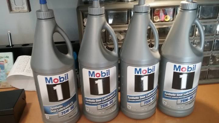

    Ok guys I bought 4 bottles of this:
    Will this be ok?

    Yes. Literally anything you buy that says 75-90 and gf-5 is fine.

    The additive won't hurt anything if you put it in a non-LSD diff.
