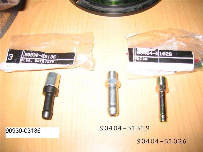

    The 51026 is a little smaller than the 51319. Like 1/4" vs 5/16" hose?

    uncleART, I already ordered Toyota Part numbers:90404-51026 and 90930-03136. So, now I'm planning on using 10ft. of 1/4" Fuel Line instead of the 6ft of it in this thread: http://www.tacomaworld.com/forum/2nd-gen-tacomas/15686-diff-breather-mod-dummies-pics.html or 5/16" in your thread....do you foresee any complications in doing it this way?
    The only potential problem I thought of was that the longer the fuel line, the wider or bigger gauge the inside diameter should be. So, if I'm only extending the line 5 or 6 ft....1/4" should be good but if I'm extending it 10ft. maybe I should go with a larger diameter fuel line. What are your thoughts?

    Hey Theo. Sorry for the delayed response - been busy. It really doesn't matter on the size or length. Whatever you can acquire easily. 1/4" would get the job done if you want to go with that. Good luck.
