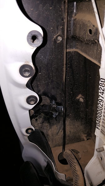

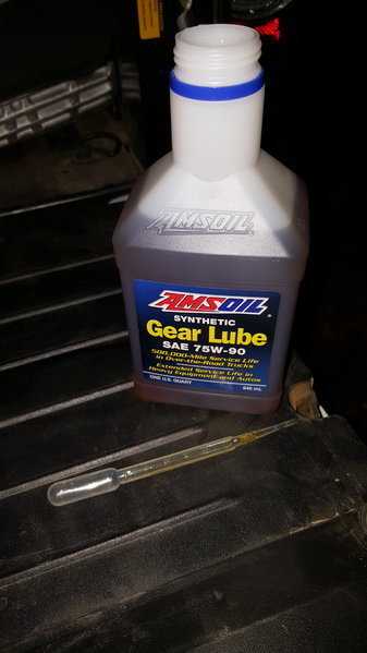

    I did this mod awhile back. I added a few droppersfull of lube to the fuel line I used for the breather. I figure it will catch and dust that might get in there since it is now a two way vent. Probably overkill...

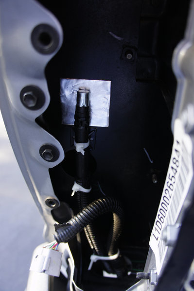

    My rear breather. Added a little pad behind the breather so it would not rattle.
