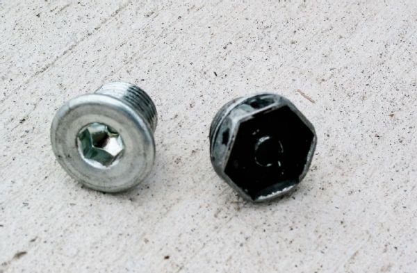

    Big fan of replacing the original 24mm plugs (on the right) with ones that use 10mm Allen keys (on the left) instead.
    Toyota part numbers for them:
    Magnetic plug: 90341‑18021
    Non-magnetic plug: 90341-18016
    They tend to not round as badly but more important IME is that being smooth they are less likely to grab a rock on the trail. Which depending on how you grab it minimizes the chance of having unexpectedly become extra tight or loose and vibrate out.

    The front differential has these 10mm allen plugs and they are known to strip when you try to break them free. This has happened to me and many many others. I don't know why these plugs get so locked onto the front differential but they do. A common fix is to weld a hex nut on once the allen strips out. I'd much rather be able to get a big 24mm socket onto the drain plug rather than 10mm allen socket any day especially if the plug decides to get a little stuck and fight you. But, to each his own I reckon.
