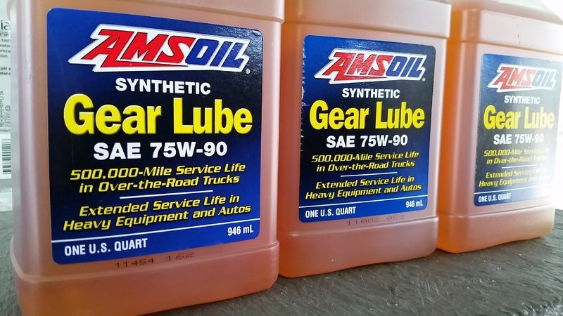

    A little revitalization on this thread... looking up my 07 Tacoma SR5 4x4 V6 the vin search says I have LS - so yippy I guess. Dont think it was standard on the SR5. Anyway, I'm going to swap all my fluids and picking an oil for diffs and xfer case. I have 190K on it - I did these back at 130K. Maybe I did them once since but can't remember. Anyway always had them done by a shop so they used Toyota fluids but I was planning on using Red Line.
    Then (while writing this post) I switched to Amsol FGRQT (long life). Why? Because at 'member pricing' if you order 8 (to get free shipping) its $13.35/qt including the $10 member fee.
    Note Severe Gear is $15.15 if you wanna go that route. Best I see on Mobil 1 57905 is about the same as Red Line and maybe saves $1/qt ($50/gal but no membership fees - qt's are higher)
    Just thought I'd share my findings for those in need.
