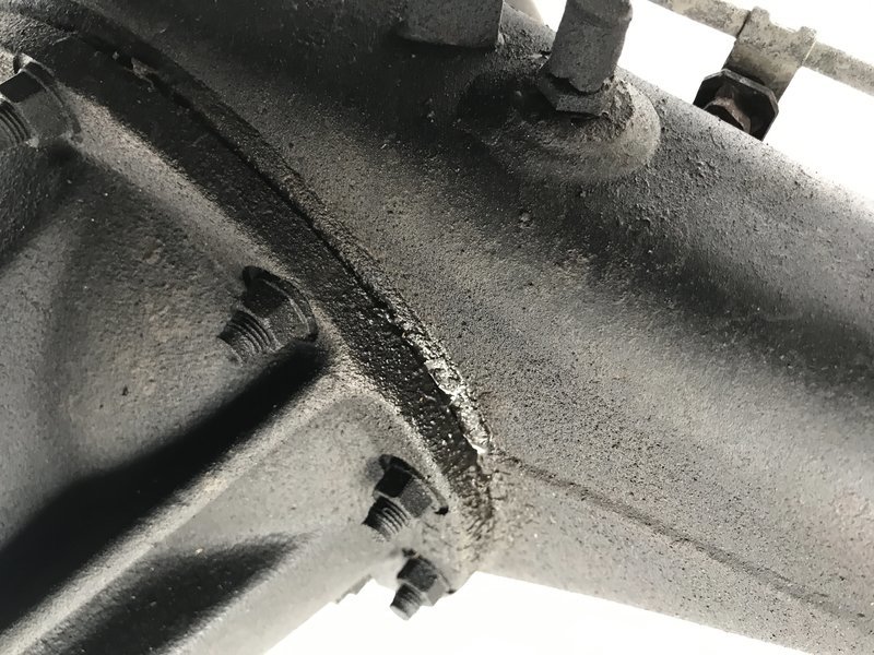

    IMG_1084.jpg any one know if I can just remove pumpkin and just clean add gasket if gasket available

    First...I would snug the nuts down a bit, clean it up and check for leaks over the next few days.

    If it doesn't work....drain the juice, open the diff, clean both surfaces, throw on a gaskets or gasket former, reinstall cover and fill with a little less than 3.5 quarts of M1 75w-90.....or whatever your favorite brand of gear juice is

    Mine was leaking too...nuts were finger tight

    2nd gen elocker 3rd member bolts are 18ftlbs and there is some differing information on 2nd gen non elocker diffs wether its 18 or 33ftlbs.... that stated, if 18ftlbs is good enough for the elocker, 18 should be fine for the non elocker diff.
    OP like stated, clean it up, torque em all down properly (i bet some are SCARY loose) and your weeping will likely go away. .
