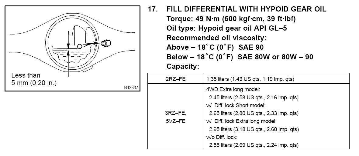

    I have a 2004 Toyota Tacoma with v6 4wd in the manual it has sae 90 for the rear differential gl5 for California Bay Area. I am having problems finding the oil what are other people doing ?

    75w-90 is basically the new (80w)90 gear oil. (80w)90 is harder to find nowadays and usually just conventional. You may not notice the difference unless it gets cold but 75w-90 synthetic will out protect, last longer and even give you a little fuel economy bump

    I agree, remove fill plug first.
    The FSM or Owners manual will have the fill quantity and grade required. I just did my 1st Gen diff fluids and used Valvoline full synthetic 75W-90 in the soft squeeze packaging which is so easy to use for filling. I highly recommend the squeeze packs for ease of filling.
