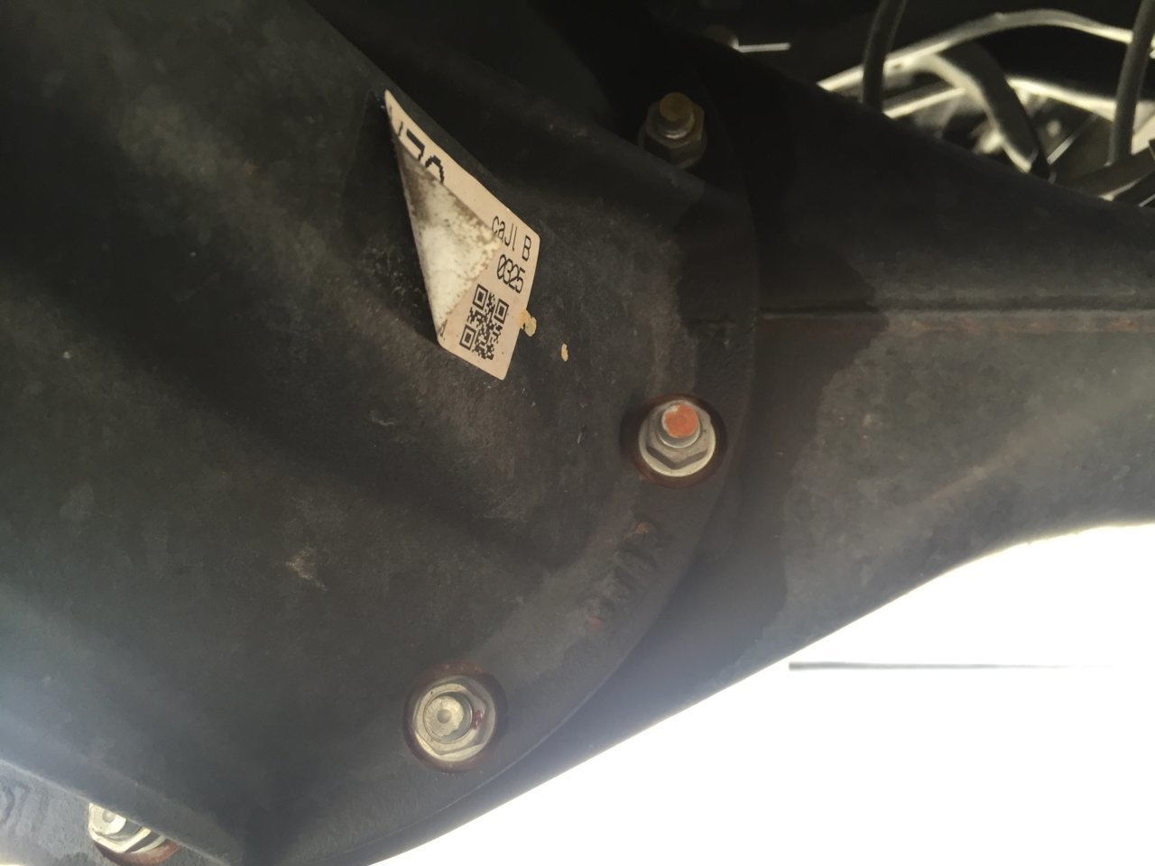

    Has anyone's rear differential leaked after it was repaired under the recall?
    mine was done awhile back, but I noticed my rear differential is leaking again. I think it may be because they only tightened the rear bolts not put a new gasket in. any ideas? Heading to toyota today anyway so it can be documented.

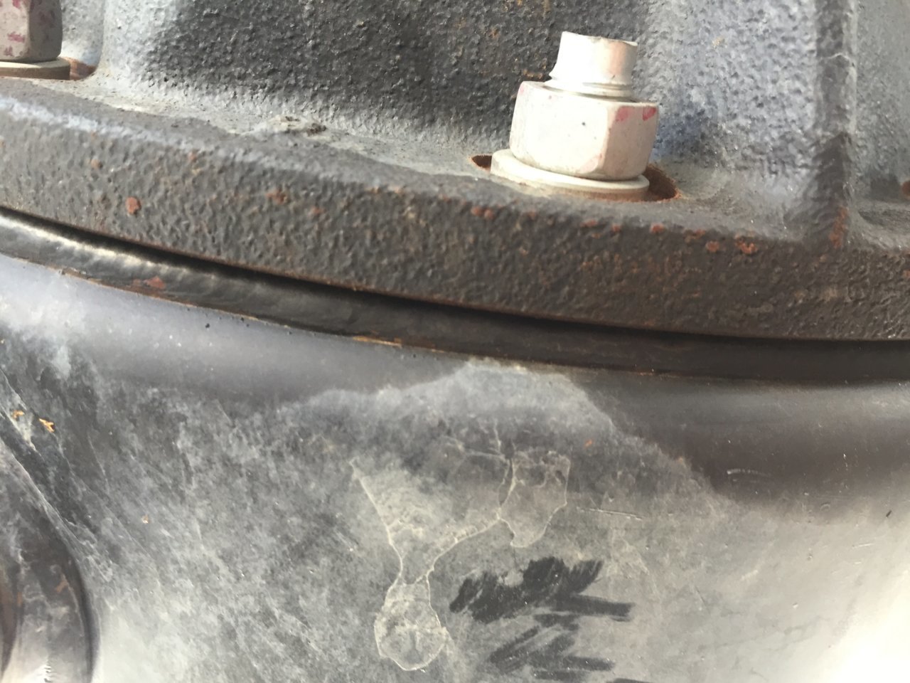

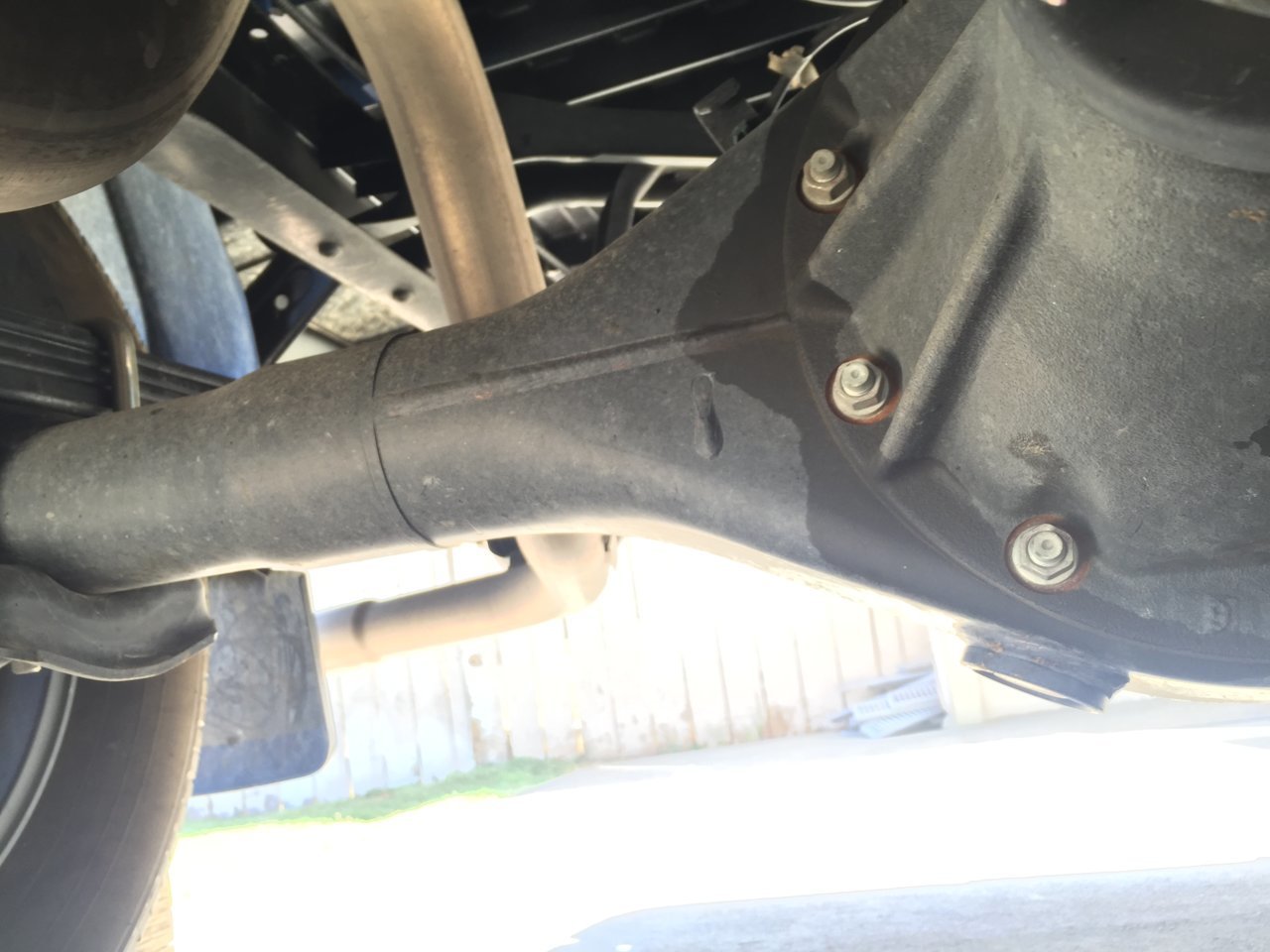

    Could this qualify as leaking Diff? My truck is a 2017 Sport Manual. My Vin did not have any open recalls. 13,900 miles.

    Yes, it should be fixed.

    Yes, got it fixed and I Wasn't on the recall either but I was still sleeping fluid. They should fix it anyways. My dealer even performed a TSB for 6MT that I had absolutely no knowledge of.

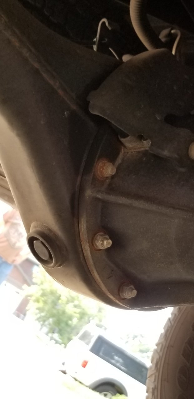

    Has anyone with a 2018 had the leak? I noticed this afternoon a very slight stain on my 2018 SR5 rear diff. Would rather not go back to dealer as my 5k service was done a few weeks ago and it would be trip number 5 in a little more than half a year...
    I just want to confirm 18lbft is correct and not 33. Going to check a few of the nuts. If they are loose I’ll go back to dealer (blah). If not I’ll monitor to see if it gets worse.

    My truck was not part of the recall but I was still weeping some fluid regardless so I took it in and was covered anyways. Check my earlier posts for pics of my leaking diff. Compare them to your diff.

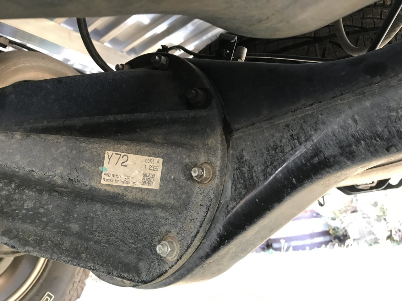

    My truck is covered by the recall. I took it in for it 18 month service and they said this is not leaking. I showed my photo to the manager and he sent it back to the shop, who said this was normal. They torqued and cleaned it up and sent me on my way. Now I can’t even tell if it is leaking!
