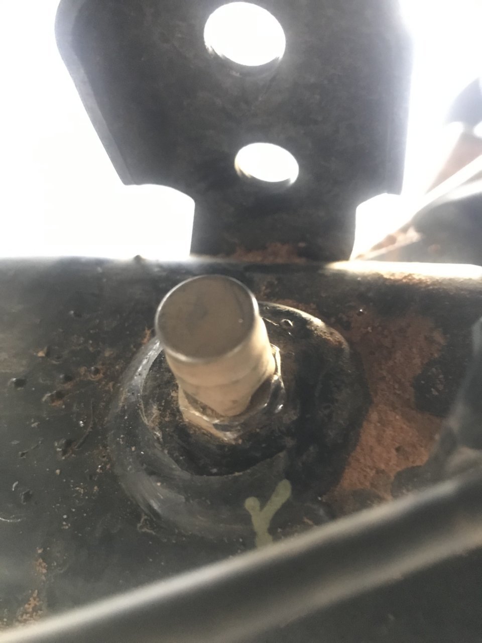

    So I can’t get the nut loose from the stock diff breather and have start almost rounding the corners in the nut. Even used a penetrating oil...any suggestions???

    Locking pliers, plumbers pliers???

    Use a high quality wrench, that fits. If you use a socket, use the least amount of teeth, like a hex socket, more surface area.

    Use a 6 point socket or wrench, not a 12 point.
