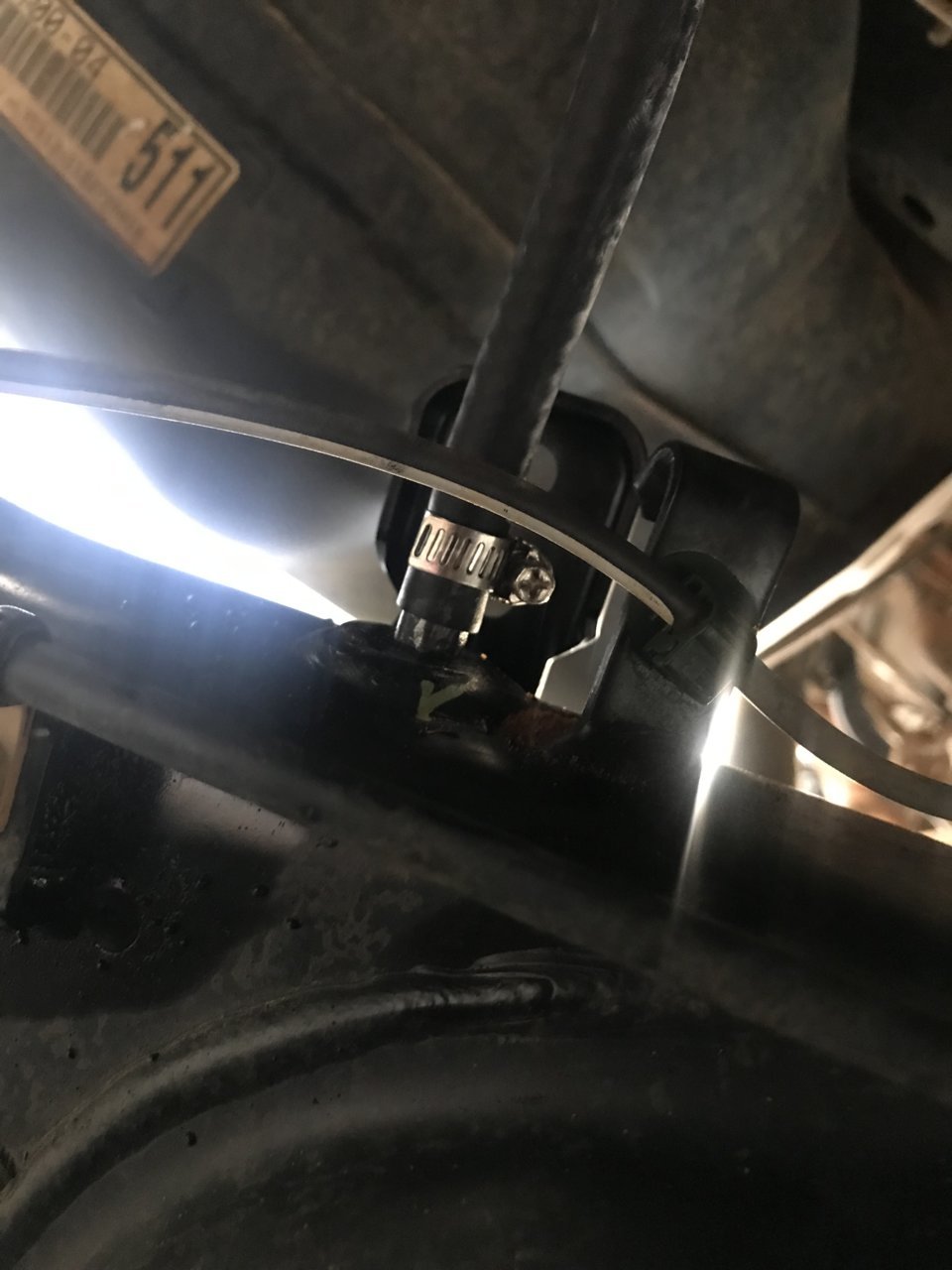

    Finally got it. Used PB Blaster and a 6 point socket and got it loose. Thanks guys!

    This should help:

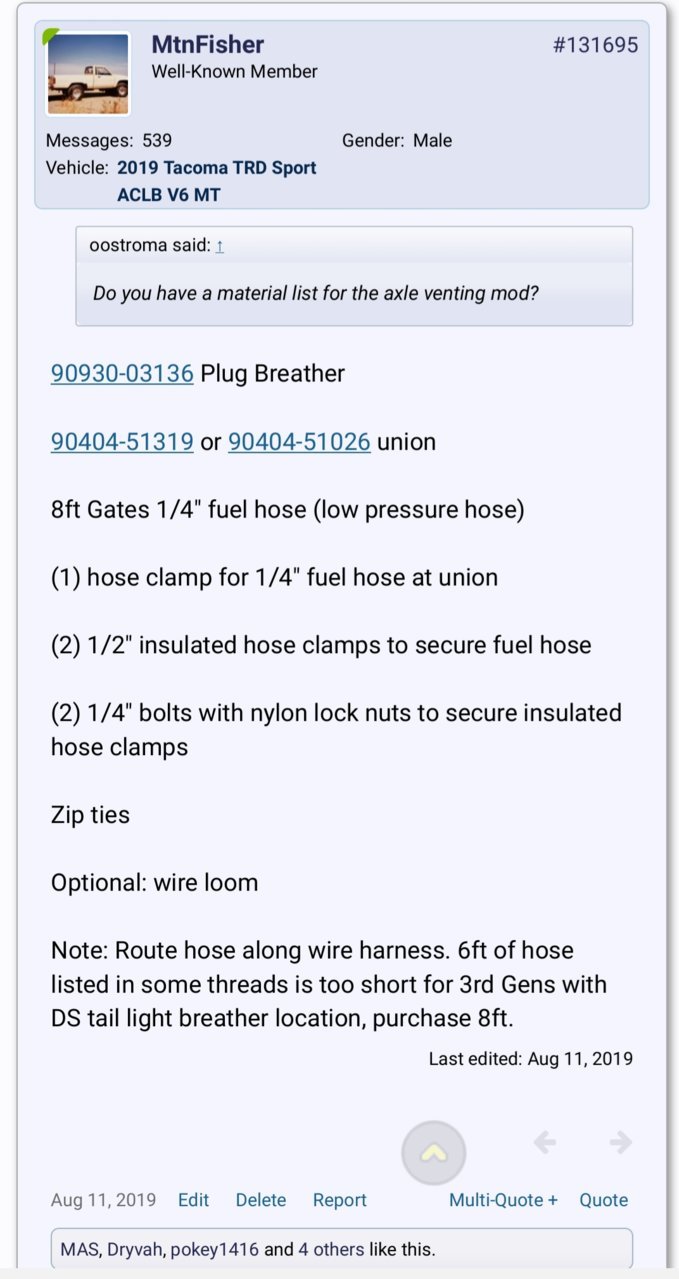

    Home Depot, electrical section:

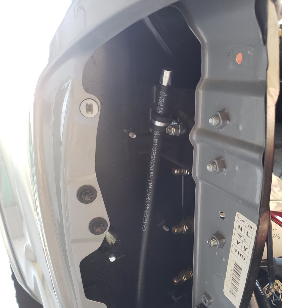

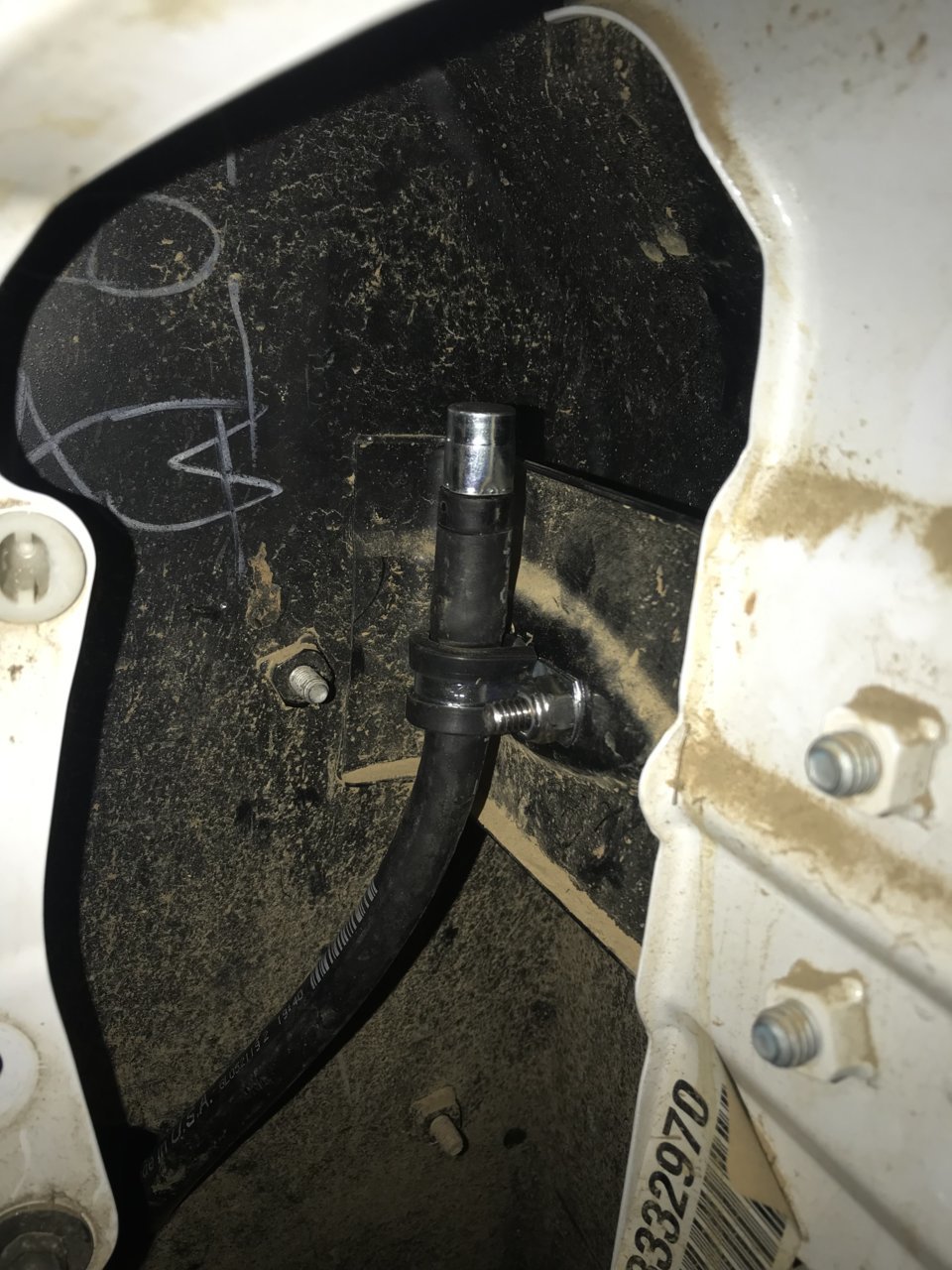

    Also secured the hose above the axle, leave some slack here:
    List of notes and parts used from another post:

    Got it cleaned up nice! Also nice to have a “no drill” option. Thanks!!
