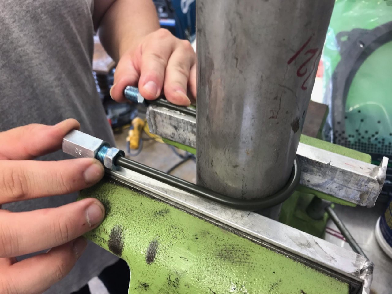

    For those adding the Sequoia master, this helped. For bending lines. Yes a 3" section of tubing.

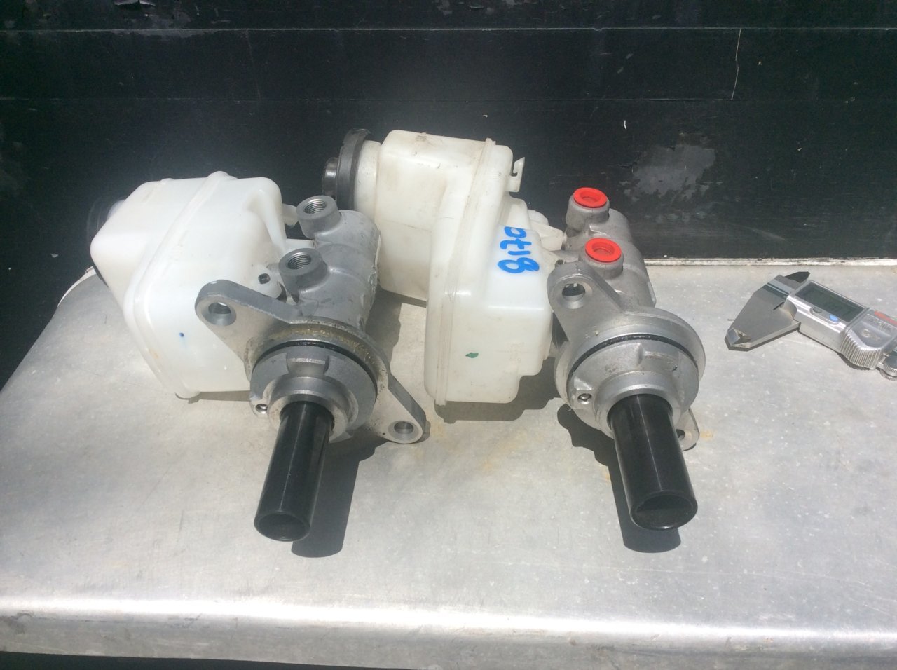

    that isnt going to be worth it or likely possible. The electric booster is ALL tied into the VSC ecu which also ties into the engine ECU and 4WD ecu. unless you swap harnesses, it wont work. You might be able to make it work with just electric boosted, but ANY traction control wont work.

    i have been looking into if its possible to swap in a T4R E booster into the Tacomas that have the e booster/VSC with the idea that the T4R is setup for dual disc setup. Those damn things are $$$$ so won't even be a thought unless I can score one off a wrecked one for cheap. The 2010-2014 T4R looks to be compatible and is the years the front and rear T4R setups are based off of. I do not have enough data and note quite ready to try it for fun.

    One question I was curious about in terms of braking bias. You obviously do not want too much braking in the rear and have been contemplating if/when I install my disc conversion kit (been sitting in the garage for a year due to how the electronic master will handle it) upgrading to 4 pot wilwood calipers. I have the Aero 6 up front already.
    The contemplation I have is my front setup uses 338 4runner rotors paired to the wilwood calipers (slightly smaller then the BBK they offer (342mm or so). The SOS rear BBK upgrade uses 345mm rotors Will the 7mm be that much of a bias difference? I have not seen this setup yet.
    I have seen at least one person running the electronic booster/vsc setup with the stoptech BBK front and rear and says its was a great upgrade for a heavy truck. If I can score a deal I am considering swapping out the OEM 4runner caliper/rotor in the rear for the larger wilwood setup. Not sure how much added bias that would cause. Anyway to estimate it?

    If the T4R e boosted masters are in fact a different piston size, it LOOKS like you could get away with going to a junkyard, stripping the master cylinder body out of the center where the main piston is housed, and swap just that.
    But you would want to confirm its actually different... unfortunately all OEM part numbers dont have just that part as its packaged with other things.

    The 2003-2009 4Runner uses a 22.22 mm master cylinder for front and rear.
    The 2010-2020 4Runner uses a dual-sized master cylinder, 19.05 and 26.99 mm, this is the same as the 2005-2020 Tacoma and the 2007-2014 FJ Cruiser with hydraulic booster.
    NOTE: That the dual-sized masters used in the Tacoma, FJ, etc., use the large size master for all normal braking. The second diameter is used as a failsafe in case of leakage, etc., on the primary piston. It is not used to have a different rear bias.
