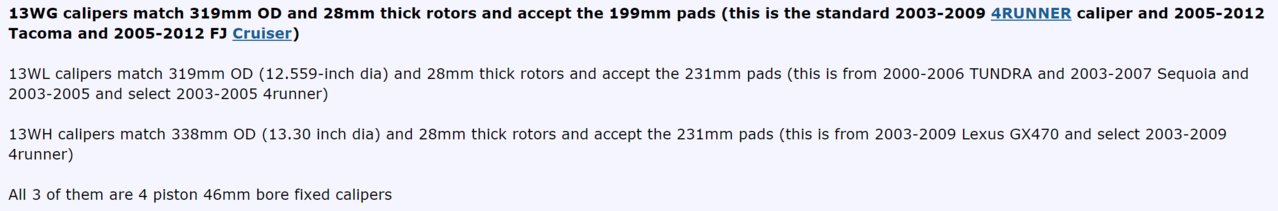

    Incorrect..... i know for a FACT that depending on the 4th/5th gen 4 runner you can have a larger rotor... moms 07 limited 4 runner has larger rotors than my tacoma. 328mm i believe. There is a whole thread write up on the 4 runner large disk upgrade.
    1st gen tundras have the same size rotor as our tacomas.... it would not be an upgrade.

    First, there are a lot of variables with T4R models not all models have larger rotors than a Tacoma = fact. Second, I never said anything about a 1st gen Tundra ?
    You took my verbiage a little too literally, I stated the Tundra upgrade " method " IE: swapping in other OE bolt on calipers...not necessarily just Tundra calipers.
    Here are the calipers that will bolt onto a 2nd gen Tacoma :

    my 5th gen 4runner has 338mm front rotors...

    Yeah I think we have established the T4R's have 42 different brake sizes depending on gen and models with gens...complicated SUV premadonnas

    About the only time i could see the use for upgraded rears is if you were hauling SIGNIFICANT load ALL of the time. But even thing i would start at the front by doing the 4 runner 338mm disks n pads n calipers and SS lines in all 4 corners before touching the rear.
