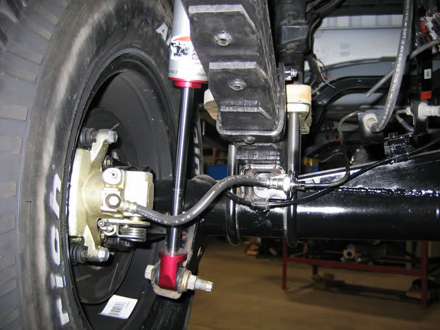

    http://tundraracing.com/taco portal.html
    I'm running it on my rig. Not a bad install.
    It's not a cheap conversion, and it's true that it's possible to get an entire rebuilt rear with discs for less. But add in the fabrication costs and e-locker and the disc brake conversion comes out on top. :)

    I see the difference already. Its all in the location of the caliper! Any debris that comes around with the tire would be brush off and fall with it mounted on the back. The (p.o.s) jimmy had it in the front and the dirt would all get pressed down through it. I had one set of pads last 25k and after that I had to do the rotors and pads again. Expensive and frustrating. Into my second Tacoma now and they rock! Totalled the first one off or I`d still be driving it.

    Order on the way! The set i'm getting from all pro off road can be installed with caliper right, left or top of axle so pretty neat. too bad the drive shaft parking brake won't fit my model but maybe I could go around this some other way...
