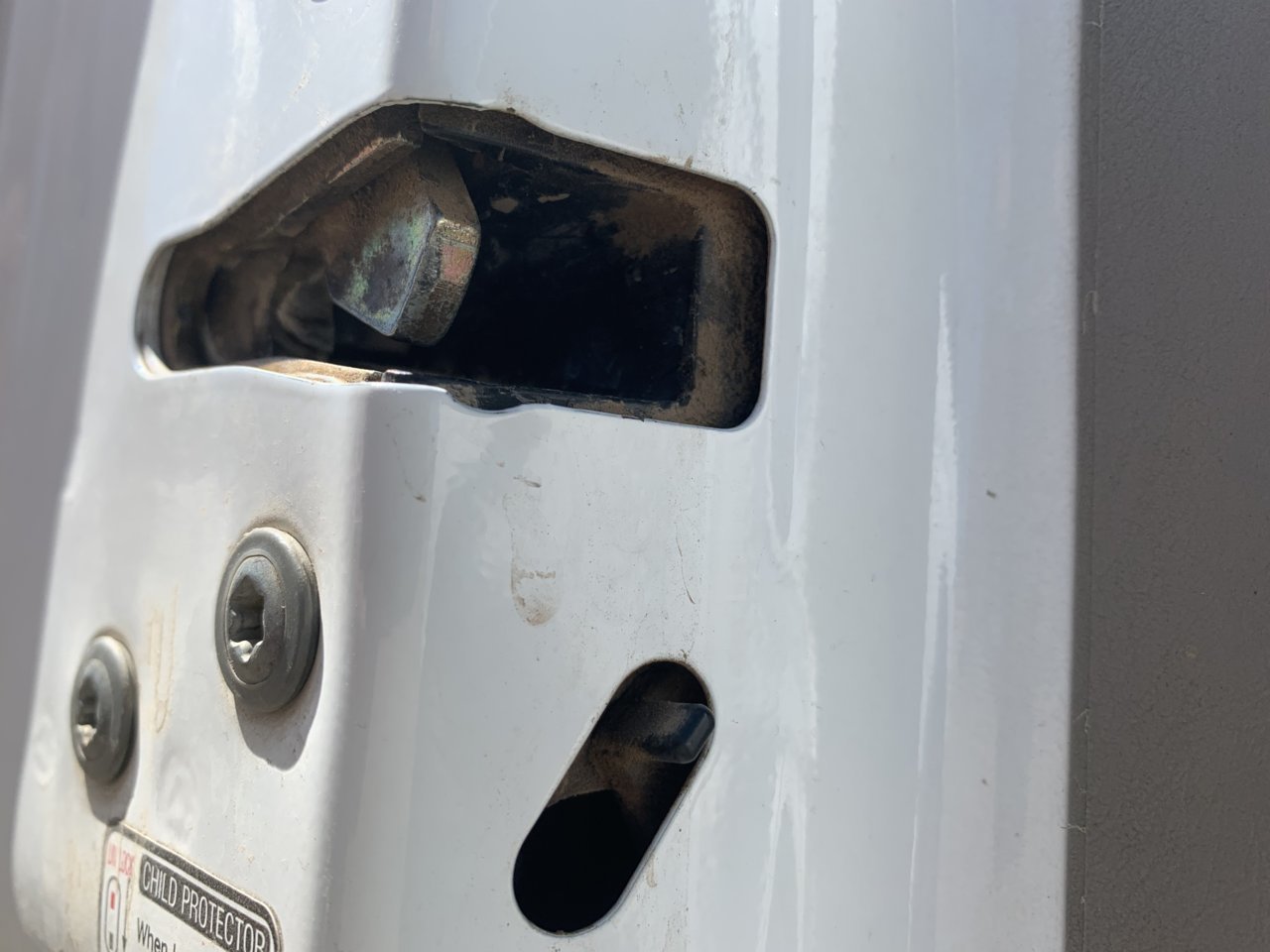

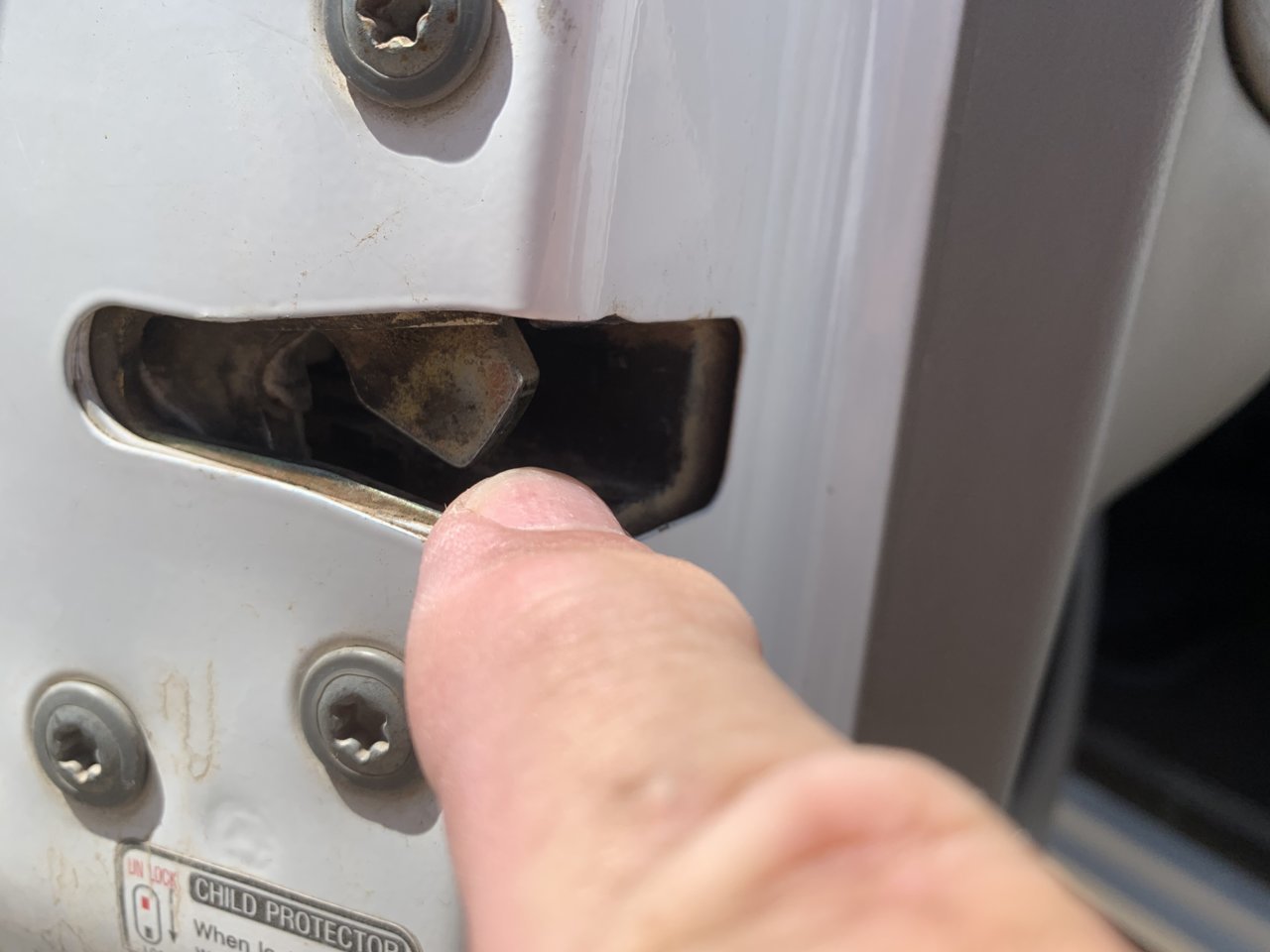

    2003 quad cab rear driver door latch. Door opens with handle and locks just fine but once the door is open, more times than not, when you go to close the door it won’t.
    that is, the latch inside the lock mechanism is somehow already closed so when it hits the locking pin in the jamb....it makes a fairly Good thud.
    I can use my finger and lift the latch manually but that’s getting old.
    any fixes short if removal? I’ve tried lubricant, also tried using a cleaner to get rid of the gummy mess from years of lube....doesn’t work.

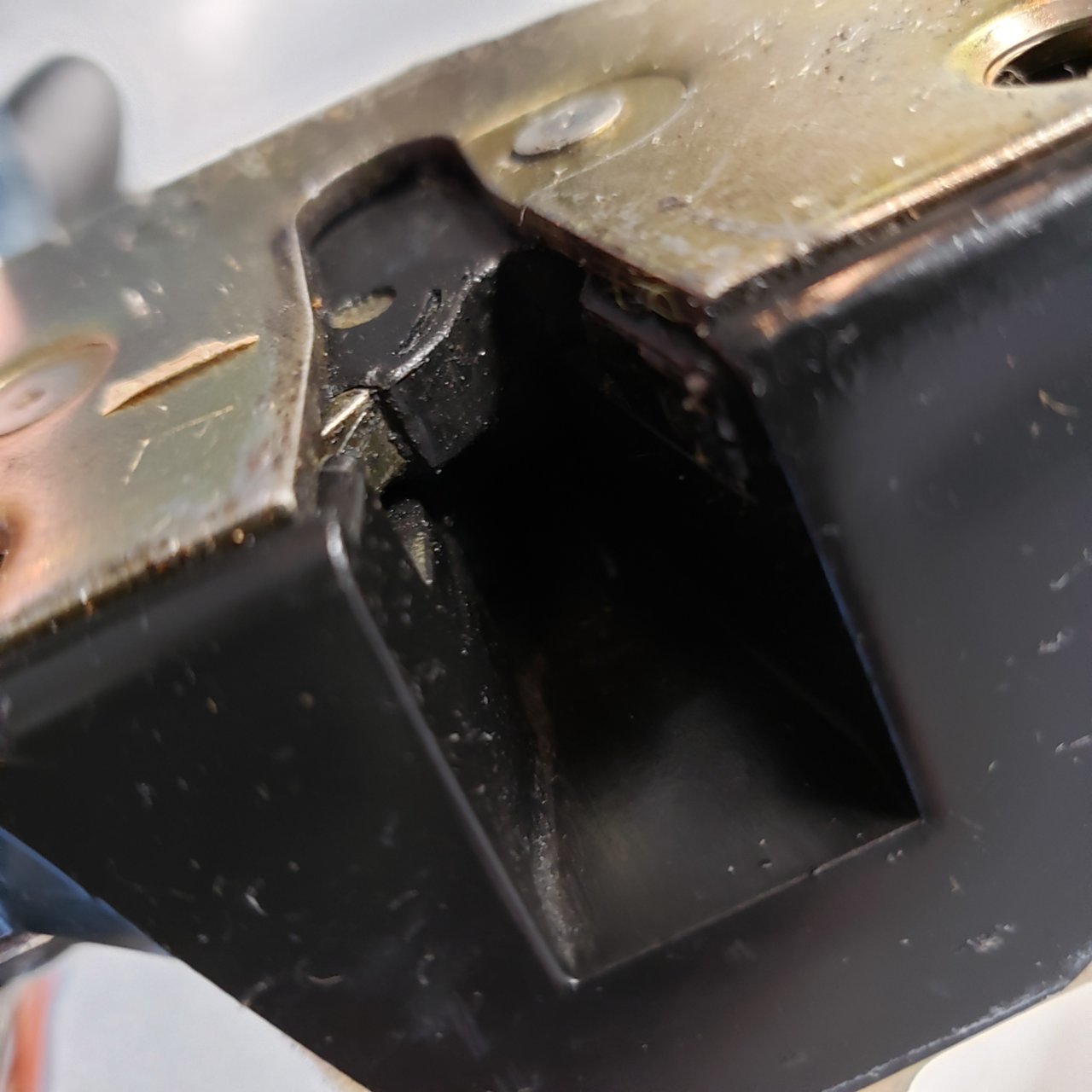

    Same issue for me...the driver's side rear door latch. I also noticed that a piece of black plastic alongside the latch was binding and preventing the latch from fully retracting. I removed the latch mechanism and lubricated everything well to no avail. Next, I tried to remove the worn plastic that was binding. Upon closer examination it seemed as though the plastic piece was integral to the assembly and not easily removed.
    My remedy was to bite the bullet and order a new OEM latch. I have power locks and was able to order just the latch mechanism and move my original power actuator over to the new latch.
    Toyota part #6930604020
    Problem solved, door latches properly once again.

    I used Triflow to clean and lubricate my latch, but as I mentioned the real problem for me was the plastic binding the latch. No lubricant was going to correct this issue. The plastic was worn, deformed, and pulling away from the latch.
    Here's a pic of how the plastic should look when its intact. This is a shot of a left front door latch.
