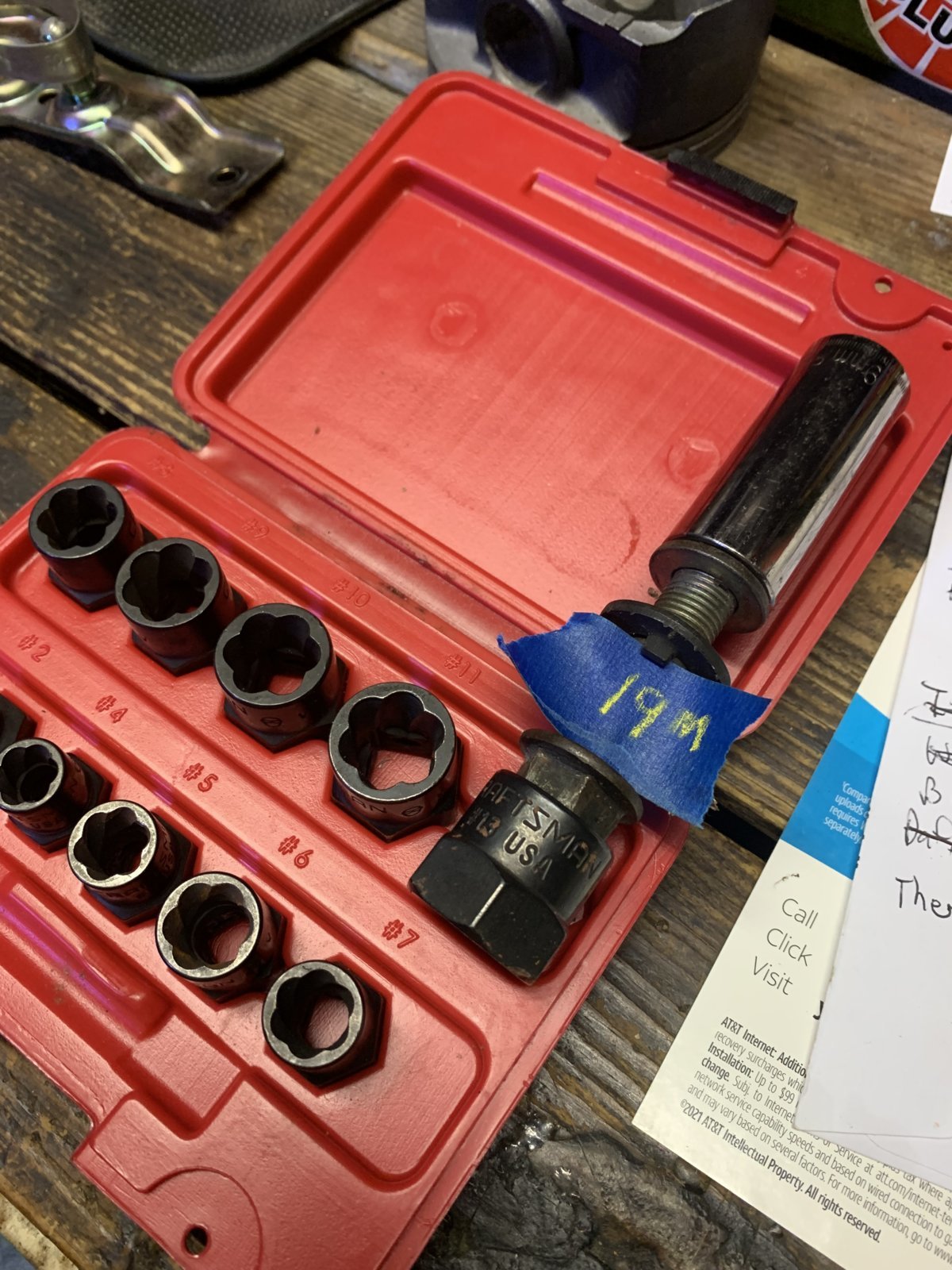

    Gemme a few……..
    I will take close up pix of my set
    (Hammering drives the curved teeth into the bitch bolt head)

    Yeah the bolt extractor sets that ControlCar posted are my favorite things. Helped me take out 2 rounded lugs on a BMW. They are a God send. Hammer them on and then use a breaker bar to break the nut loose.

    Pretty sure my drain bolt was 19mm
    looks like the biggest one fits
    Craftsmen set #13
    Says on the B extractor
    let everyone know if helps

    I know the head of bolt is 24mm. That isnt to say the actual bolt is a 19mm. Im guessing these socket’s reference the diameter of bolt and not the hex head.

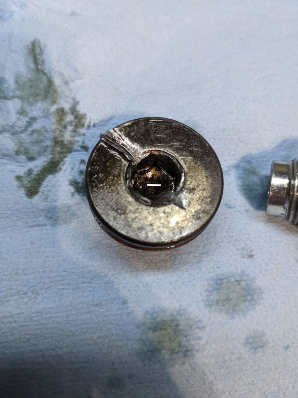

    Kinda like this, make a indent, then using the chisel rotate the plug loose.
