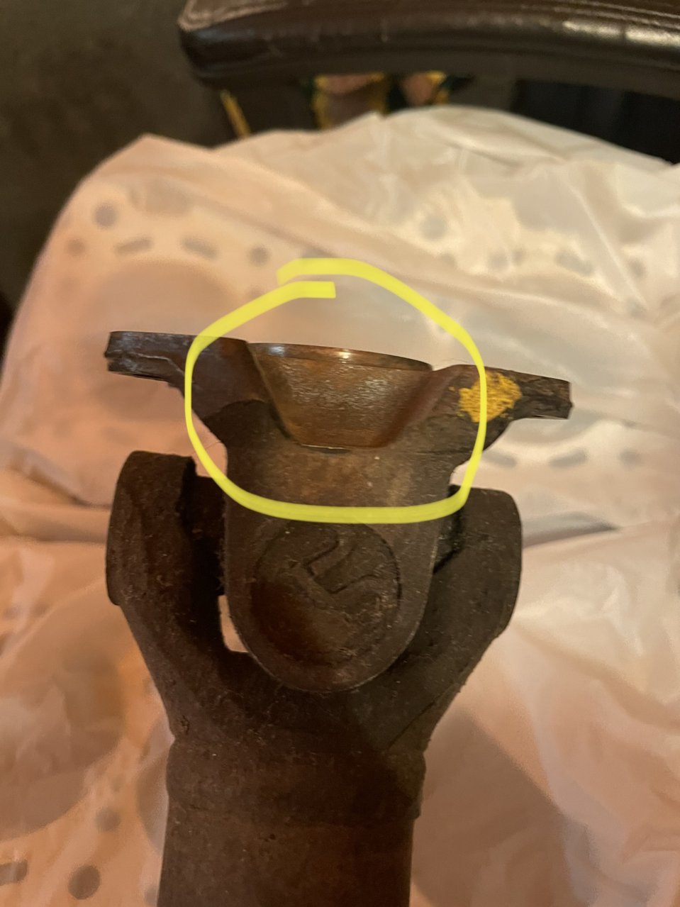

    Attempting to remove my rear driveshaft to replace with a on piece (Tom Woods). I’ve removed the 4 bolts on each flange and the two bolts holding the carrier bearing. Both flanges were stuck but I was able to get the front to release with a few really hard hits with a dead blow hammer. The rear just will not budge. I was able to get it to rotate by driving the truck a few feet (in 4WD) such that the bolt holes aren’t aligned anymore, but still just as stuck.
    Anyone have any tips or tricks to break this free, or is there something else I’m missing here completely?

    14mm open end wrench- shove it in this area and pry

    The 14mm didn’t fit right but was able to use a pry bar in there and that broke it free. Thanks!

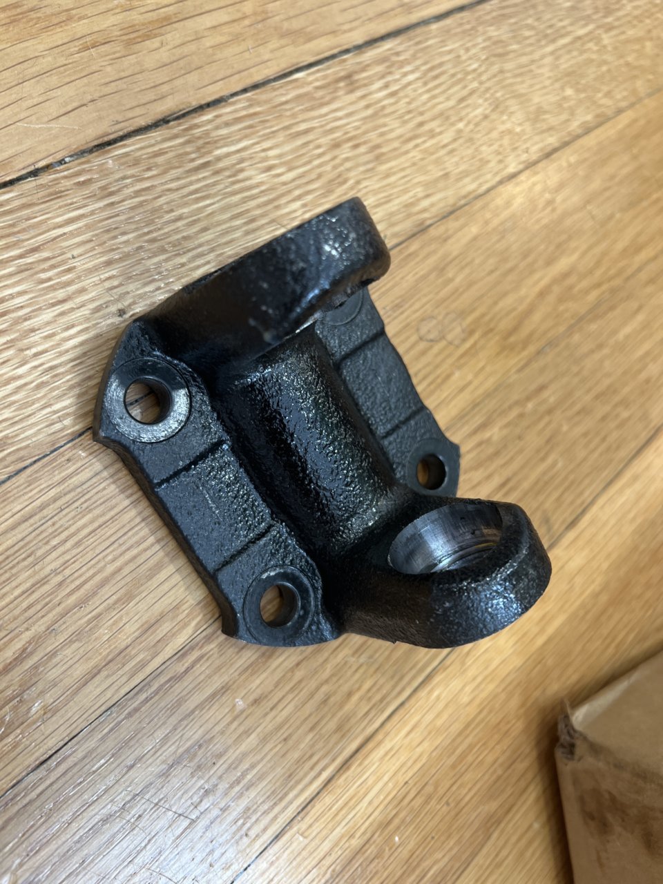

    Turns out I messed up measuring my bolt patterns. Rear was 66 and not 60 as I had measured. TW offered to swap the whole driveshaft out for just the cost of return shipping. Needed my truck back quickly so actually got them to overnight a new flange.
    Haven’t spent much time on inter state yet, but so far I have felt absolutely no vibrations. Very happy with this replacement.

    Thanks BackAsswards for the photo and wrench info! Worked on this for an hour unsuccessfully then found the thread. Flange came off five minutes later.
