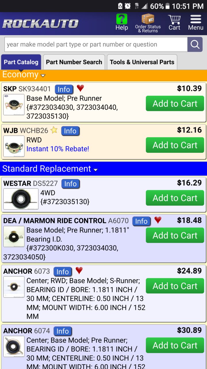

    Carrier bearing. (support bearing)
    rock auto.
