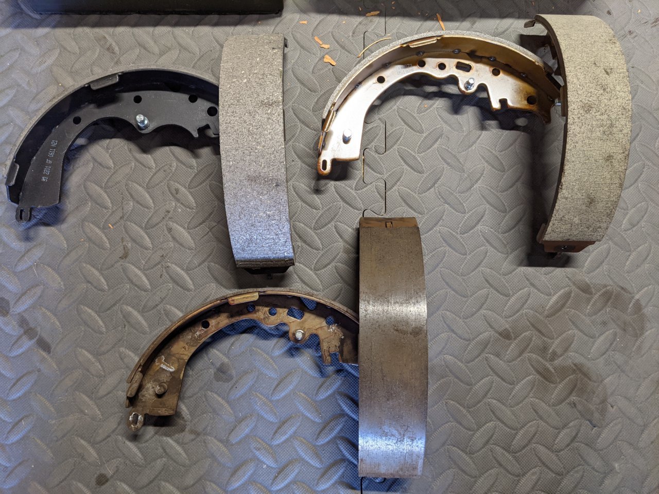

    I have read about the softer feel with the T4R upgrade, but understood it was still better braking under heavy load. My truck hovers just above max GVWR when towing our Patriot X1GT (max of 3500 lbs). I really noticed the need for better braking this past summer on a 12 day trip through Colorado. Coming out of the mountains was SLOW going with multiple stops to let the brakes cool. No warped rotors though!
    Let us know what you think of the Tacoma StopTech calipers. I have looked at those as well. They aren't to spendy compared to other options, but they also aren't larger pistons IIRC. I run 17" wheels specifically so I could upgrade the brakes. Maybe I'll just same the money and buy the Willwood BBK this Black Friday.

    It looks like you have well more than 2/32" lining remaining, the inspection failure point in my state.
    85k is pretty good for a service item that costs less than $100.

    Well, I have a lot of updates to give, will have to put some time into how to write it all up and present pictures and such. But the short of it is that there are wheel cylinders available that can be made to work with very little modification. I have spoken to a few folks ad Advics (OEM supplier) and got several spreadsheets for product specs as well as OEM part numbers they cross reference to. So I was able to identify, find, and order several wheel cylinders to experiment with. I now have in hand, and have test fitted 1" and 1.125" wheel cylinders in the tacoma drums. I also have two types of brake shoes to play with (powerstop semi-metallic and brembo ceramic), and I have powerstop coated drums as well as new OEM drums to test with if I want.
    I happen to have extra axle assemblies with backing plates and brakes to use to play with and test fit to make all my measurements and trials on the bench, looking over everything closely. I am fairly excited to do some real testing, even though I don't know how long that will be. Other projects and priorities have also crept into the picture.
    More to come when I get time

    I just got a set of Beefed Up Brakes Brake Shoes that I will be installing this weekend; they are suppose to have better bite; I'd see how they do with new OEM rear drums.

    what type of material are those beefed up brakes? some variation of Ceramic, or Semi-Metallic?
    Edit: Nevermind, they are ceramic. The pictures look very similar to the Brembo pads I have. Wonder if they actually come out of the same factory.
    https://www.amazon.com/Beefed-Up-Brakes-Premium-Compatible/dp/B08528X5T8
    https://www.amazon.com/dp/B00L7THMCW
    The picture on Amazon is not accurate, by the way.

    I looked into this and so far came up with no answers at all; I am not sure what type of material they use; however I do have the front Brake Pads installed with new rotors and the bite is night and day compare to the OEM brake pads and rotors; or the previous Wagner OEX brake pads I had. The bite is definitely better with their pads and absolutely quiet. I am hoping the Rear Shoes will be the same.
    They are the only company that claims their compound is an upgrade over the OEM setup; Designed to stopping additional weight. I'd be testing that claim tomorrow after the install.

    beefed up uses a ceramic compound according to Amazon link in previous post. Which makes sense for them being quiet, semi metallic have substantially more bite than almost any ceramic, at the expense of dust, faster wear, and noise. But of course there are lots of variation in the ceramic compound family, many use copper and other metallic particles, blending the lines somewhat between compound “types”
