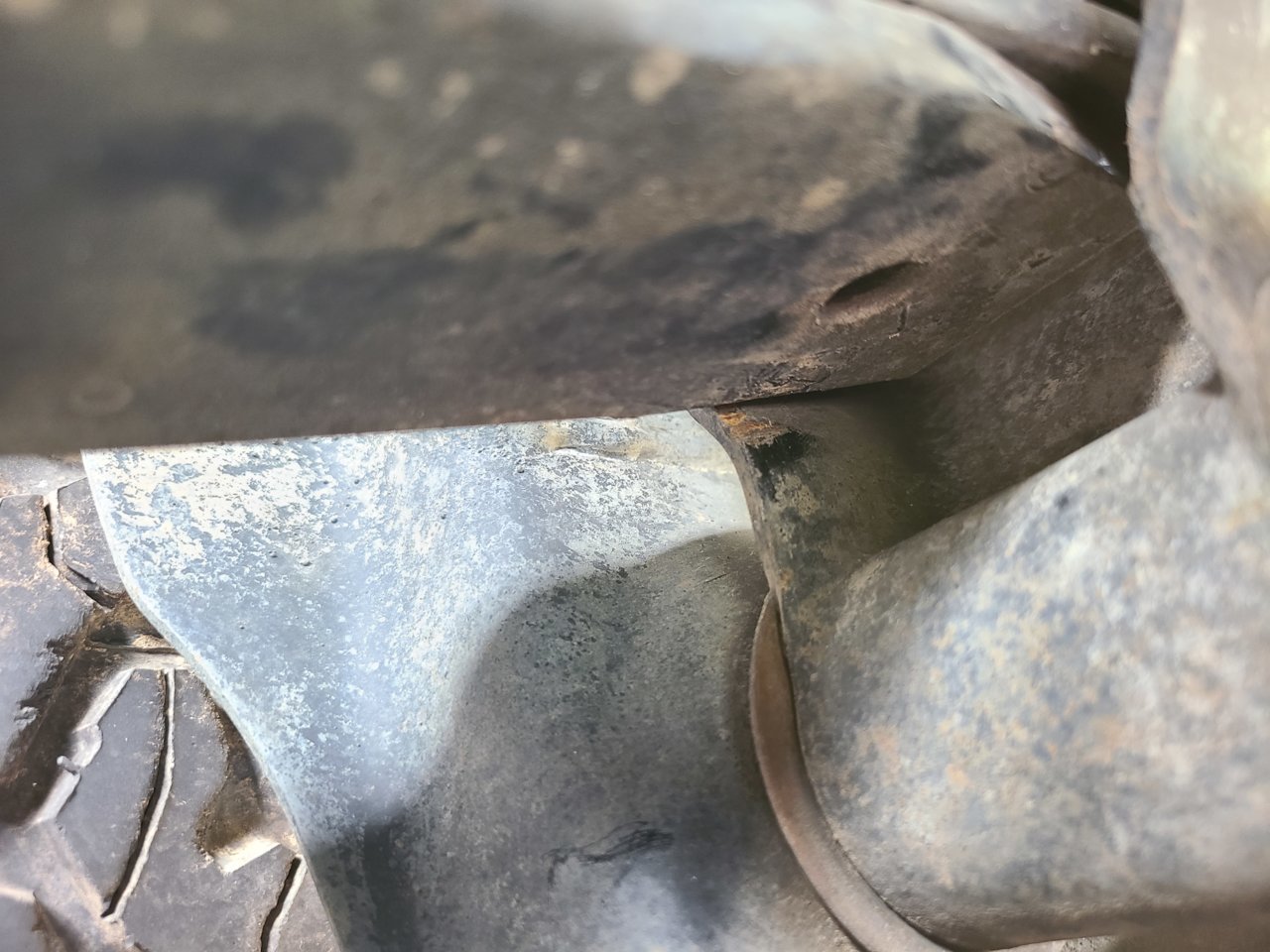

    Check where the leafs meet inside of the rear shackle. Had a clunking noise and found that it was the second leaf binding to the shackle itself. The second leaf extends into the shackle cavity itself. When it flexs it will hit metal on metal and that's probably whatnthe clanking noise is. I also have Dakars 20200420_155833.jpg
    nemesis17592[OP] likes this.

    Have fun cutting or grinding that

    I won't be the one cutting it, but thanks?

    That actually does make sense. I don't really hear it much anymore. But ill check for wear marks.
