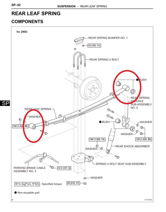

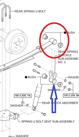

    When you have the truck on stands (i.e. weight off the leafs) you should torque these two bolts to spec, but only hand tighten the third one. Get everything buttoned up (tires on, etc) and lower the truck back on it's own weight, then bounce around on the tailgate and bumper. Once you've shaken it up good, then torque the third bolt. I believe it prevents binding. I have no idea if this is your issue, but this may help.

  16. Jan 26, 2018 at 3:22 PM
    #16
    EatSleepTacos
    Mar 24, 2015
    #151688
    59,835
    Randy
    West Valley, AZ
    2017 4Runner
    This one that attaches the shackle to the frame (blue arrow)
  17. Jan 26, 2018 at 3:23 PM
    #17
    nemesis17592
    nemesis17592 [OP] Well-Known Member
    Apr 28, 2017
    #217568
    181
    Nate
    Comstock Park, MI
    2010 Tacoma DC LB SR5 4x4
    Ahhh! Ok I’ll try that! Thanks.
