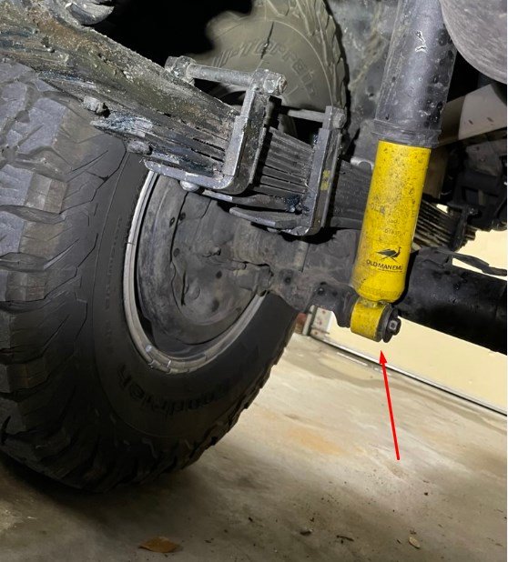

    I don't know if it's just the angle, but it may be worth checking your shock bushing, looks like it may be degraded on one side.
    It certainly would match your symptoms and I can tell you from personal experience that the OEM shock bushing I had would degrade slowly and work basically well until I hit larger bumps.

    That’s a very good point. The bushings are as new as the shocks, but new parts don’t always equal good parts. Come to think of it, I’ve only tried to wiggle the shocks with my truck in the air. Of course their going to be tight then, all the weight of the suspension is pulling on them. I’ll set it up tonight and lift my rear axle with my transmission jack, and see if there is any play or looseness. Couldn’t see anything in the videos that I made.
    Thanks to everyone for their input.

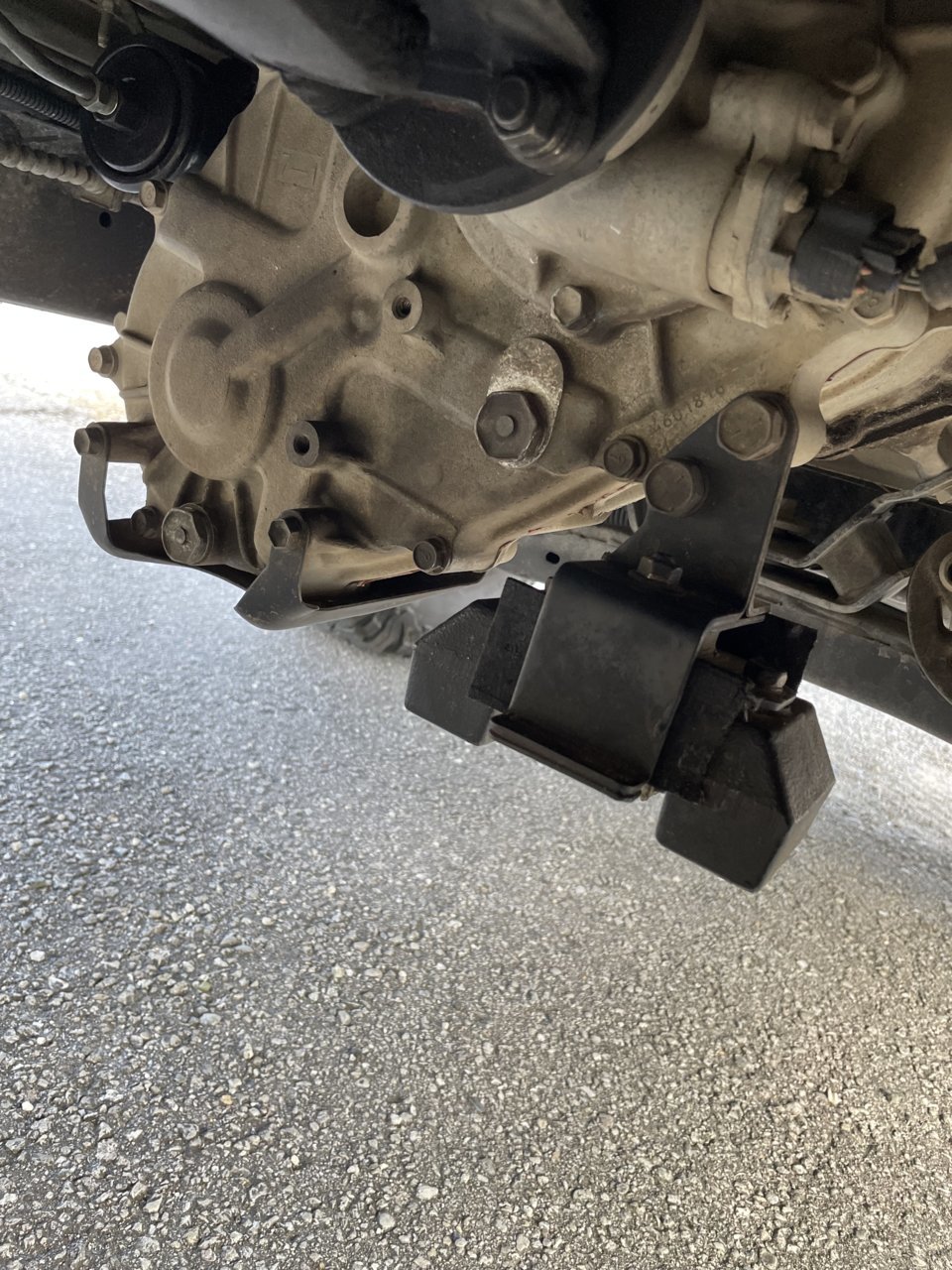

    Welp! I’m dreading this post, because I found my problem. I’m very glad I found it, but it was something stupid, and should have been obvious, and I feel very foolish for overlooking it, and overthinking this entire problem. My instructor in diesel college always had a saying to just remember the word KISS.
    Keep
    It
    Simple
    Stupid
    Well I definitely feel stupid, because it was simple, but anyway I’ll get down to how I found it. I was still insulating everything that moved, and made any type of noise. Most of the time problems like this come from a part that is designed to move. This part is also designed to move and I did look at it and touch it, but I never hit it with my fist until last night. It’s the damn driveline dampener hanging off of the back of the transfer case. I wiggled it, and it was pretty loose, so I hit it with my fist, and heard a smack! The rubber inside the dampener is cracked and is able to hold itself fairly steady until you really jar it. Then the weight moves to the side and smacks the mount. Shiny contact points were there and everything. I cut two pieces of rubber and slid in the front and back of it to see what happens. No noise, waited until this morning to be sure because there is a rough driveway that I have to go through. Here’s a photo of the part that nearly drove me crazy…..with the extra rubber installed.87CCFEC5-85BA-4F7E-9EE0-3D32551AC3EE.jpg
    96BlueTacos and Area51Runner like this.

    What does that component do, exactly?

    Yeah, like the other guys said it dampens vibrations. It’s basically a 5lb weight hanging by a piece of rubber in the middle. That allows for it to wiggle around and counter act a vibration, canceling it out. Evidently mine has been working some overtime….if I pulled on it, the rubber would rip apart. The funny thing is that my truck has always vibrated its ass off, I just went a few weeks ago and got a new set of tires from a local discount tire store. This truck has never ran this smooth in the last 200k miles. The discount tire that I stopped at must have a wheel balancer that is spot on, it was a fairly new store. Got the same tires as the last 3 sets, so idk?

    Yes, it was. It was a combination of the driveline dampener and my front shock bushings. I was going over everything making sure all of the bolts were tight, and put my wrench on the top shock mounting bolt, and turned it. It was tight, as in out of threads, but you could still turn it fairly easily. I took the nuts off and added a few washers to tighten the rubber down more, no noise since.
