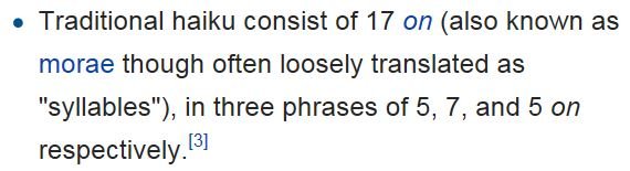

    Nope, try again.
    https://en.wikipedia.org/wiki/Haiku
