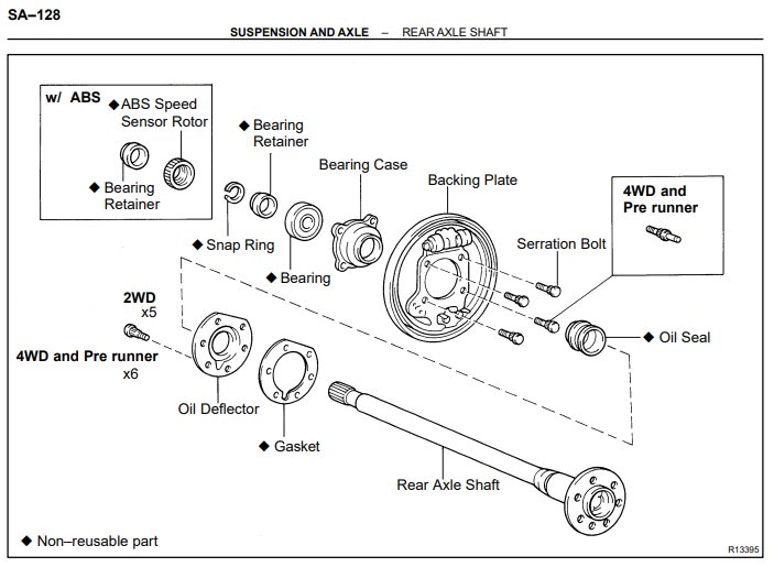

    @Andy01DblCabTacoma what i mean is with the rear wheels off the ground i can push and pull on the wheel axially and feel some motion. Just a little. I have not checked it again in a while so this was a few years back. I was told this was "not abnormal" and to make sure i had no radial play. This makes some sense as deep groove/conrad bearings are radially pre-loaded and can have some axial play in them as the bearing balls are in an arch and only in contact at their apex points to the raceway. (Unlike angular contact bearings or four point gothic arch bearings.) I was also told that if the rear bearings were bad i would hear it when driving which makes sense to me as well. I think a special puller is needed to do this job. That has stopped me from just doing it.

    I'm trying to pick this apart- as you're using some slightly abstract names.
    With your tire off the ground, the wheel should rotate (as in the direction of normal operation) ever so slightly (this rotation would be the same as the backlash in the diff). If it has any other play or movement, you have an issue.
    You need more than just a special puller- you need a press and a puller jig to replace the wheel bearings. The reason I asked where you were, was if you were close by (San Diego), I'd have invited you over one weekend to use my press and tooling.

    I will check this out but the motion i felt was axially. In and out. Not rotational lash. I of course was not looking for lash so i will test that.

    You should not have any in and out movement on your rear wheels (or front for that matter).
    The bearing case (and therefore outer bearing race) is attached via those four bolts pressed through the backing plate and attached to the axle housing. The only thing the axle shaft itself touches is the inner bearing. If you have notable in and out movement here, the bearing is shot. Edit- or those four bolts are loose.

    Thought i would give an update. The knock has persisted and mainly only is when i pull into a driveway at an off angle or in other words not straight in. The off angle entry creates a side to side motion in the rear end and you get the knock. One maybe two knocks.
    Replaced my rear brakes today and measured the axial play while i was in there. Drivers side is .019". Passenger side is .008". From reading the max allowable is .028". I have no radial play that i can detect. Looking at the new axle bearings i picked up some time ago they seem to have axial play in the .005" range. I know some axial play is expected and going by the .028" spec it seems i am still OK.

    I'd plan to do your rear wheel bearings. I had identical symptoms on my '03 Xtra cab, tried new leaf spring bushings, then later new leaf springs altogether w/ new ubolts, all to no avail. Finally just tried the rear wheel bearings out of desperation (despite my axial play seeming to not be that bad).
    And voila, after the new wheel bearings the problem was immediately solved, and hasn't come back nearly 8 months later.
    Edit: also I'd bet your bearings are far worse than the axial play you notice now (with the rear end assembled) would lead you to believe. I could shake mine in my hand like maracas, and they clicked back and forth a lot.
