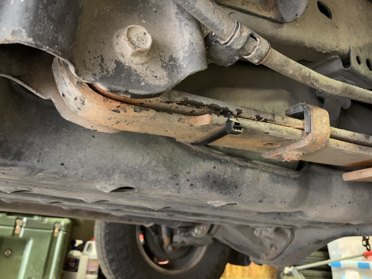

    1CD539F7-0AAA-42FF-8A18-0DE1F5EF07D4.jpg I know everybody’s got a different rattle on their vehicle mine happened to be the driver side front leafspring I was beating around there with the hammer and heard the noise I hear while driving put a zip tie between the two leaf springs my problem is solved for now
    Had the truck about two months now and noticed I did not have the noise when I was loaded with firewood or a small trailer but when I was empty I had this weird rattle going over bumps
