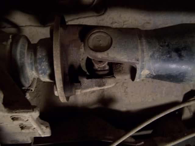

    bad u joint is correct check out the pic i took
    It's like the u joint is all cockeyed. any info about this would be great because i'm trying to learn
    So, the worn out leaf springs caused axle wrap, which caused the u joint to go bad, correct? sorry for all the questions

  18. Dec 1, 2010 at 3:35 PM

    BAM! lol well good thing it didn't bust going down the road like mine did lol. Probably just lack of grease

    how much do you think it's going to cost to have fixed? Do i just need to have the u joint replaced?

    That is beyond bad that is total faliure and just shy of killing the drive shaft + beating the gas tank + every wire and fluid carrying line under your truck.
    You can swap in a new SET of joints for now (FRONT & REAR). I'd do both and I'd buy a good qualit joint ~ not the cheapest china one you can find. A new front joint will get you back on the road but the issue that killed the front joint has traumatized the rear joint too I seriously doubt it's long term viability.
    Do both now and avoid the risk of slinging the shaft later. This will buy you time until you can make a plan for the springs.
