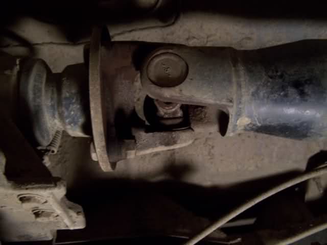

    Depeneds??? How much can you do yourslef? Can you remove the drive shaft? Did the drive shaft contact and damage the front yoke? If the ears ground on each other then you will probally need to replace the drive shaft.
    Search car-parts.com for your used drive shaft. (Part / price / phone #)
    A good drive line shp can replace the front yoke but that might be over your head. I prefer to source a good Heavy TRUCK drive line shop for professional drive shaft repair (Dump truck / over the road truck). Race shops charge race prices / truck shops do quality work for less.

    If you buy a china u-joint you might ought to buy them by the dozzen or at least carry a few spares. Even NAPA and Precison offer a line to compete with the China parts (they are now forced to compete and offer the same junk). The sad thing is all the low cost auto parts have diluted the US market. It is getting more and more difficult to find quality pieces. A good joint should be in the $20 - $30 range.
    GMB offered by NAPA is a top quality U-joint manufactured in Japan.
    The GMB joint listed here at NAPA online is $28.08
    http://www.napaonline.com/Search/Detail.aspx?A=ATMAP17_0257370207&An=599001+101999+50070+2070023
    Just a W.A.G. ~ ~ ~ ~ ~ But a shop is going to get about 2 hrs to pull the shaft and replace the joints. Make sure they are using a quality joint, some parts places hook the shop into selling cheap china pieces at inflated prices then the shop and parts house split the profit. I'd guess you'd be looking @ around $200 - $350 if you took it some where.
    Or
    Under $100 if you did it your self and bough the ball joint press / u-joint press.
    Needle bearings are not an issue one you get beyond f'n up a few new joints. Just use lots of grease to hold them in place.
    You can search "u-joint change" on you tube for a few How too videos...
    Key Words: Universal Joint change changing bad drive shaft vibration front axle shaft yoke press.

    can you tell if they're good just by looking at them? when i was under my truck today they looked normal nothing looked out of ordinary

    Yes ~ that one u-joint cap in your picture looks dislocated. Usually when the needles fail and the cap seperates from the trunion the yoke ear will rub the shaft ear. This will damage / distorte the ears along with their machined fit for the caps and clips. It is often overlooked at first glance ~ But once you know where to look you can see the shiny metal and grind marks.
    Looking at your pic again I'm 90% sure you have yoke damage.
    I should not be able to see the center of the trunion post that that cap should be sitting on.

    well i took it to the shop and i need a new yoke as well. since i can't weld, i'm going to have them do it. I am also getting all new u joints. parts and labor is $400
