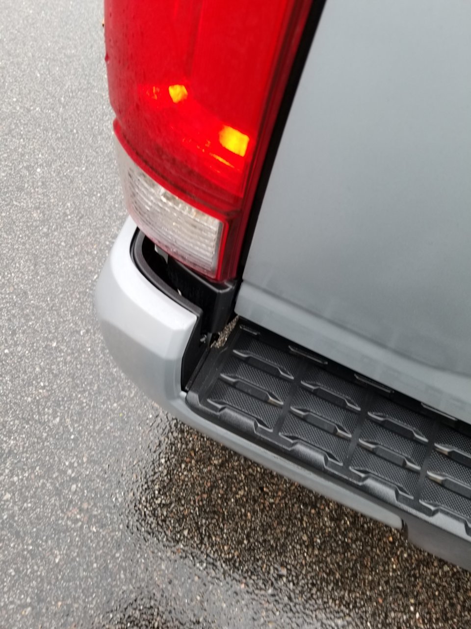

    So I got rear ended yesterday, damage doesn't seem to be substantial as the tow hitch took the whole hit. But in doing so it bent my bumper downwards. I know I can't be the only to have this so what is everyone seeing for repairs? Will a new steal bumper fix the issue or do I have an underlying issue like a bent frame?

    Hard to tell from the angle but most likely bent bumper brackets. Pics from underneath would help

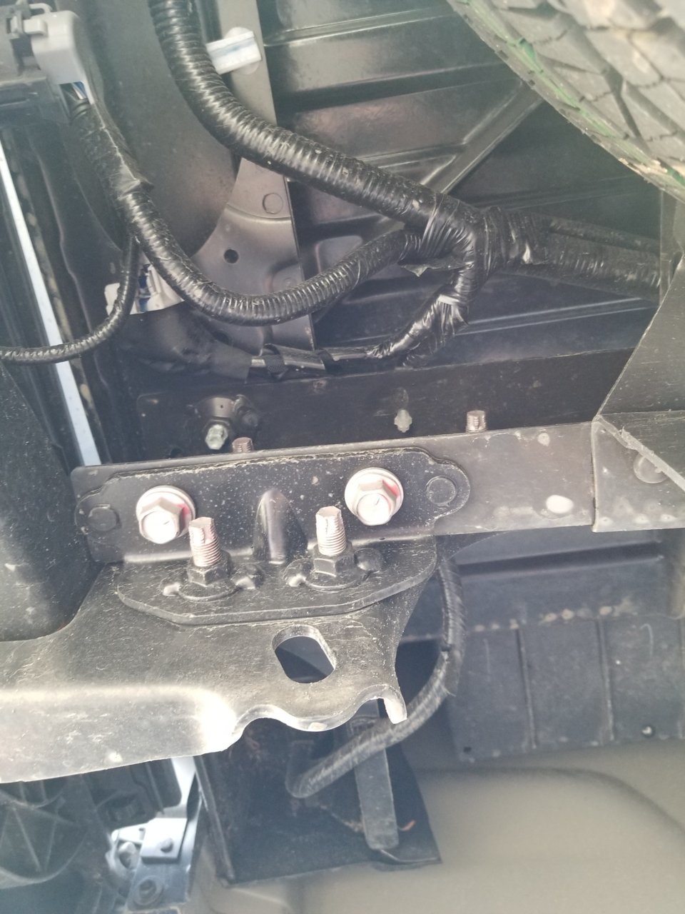

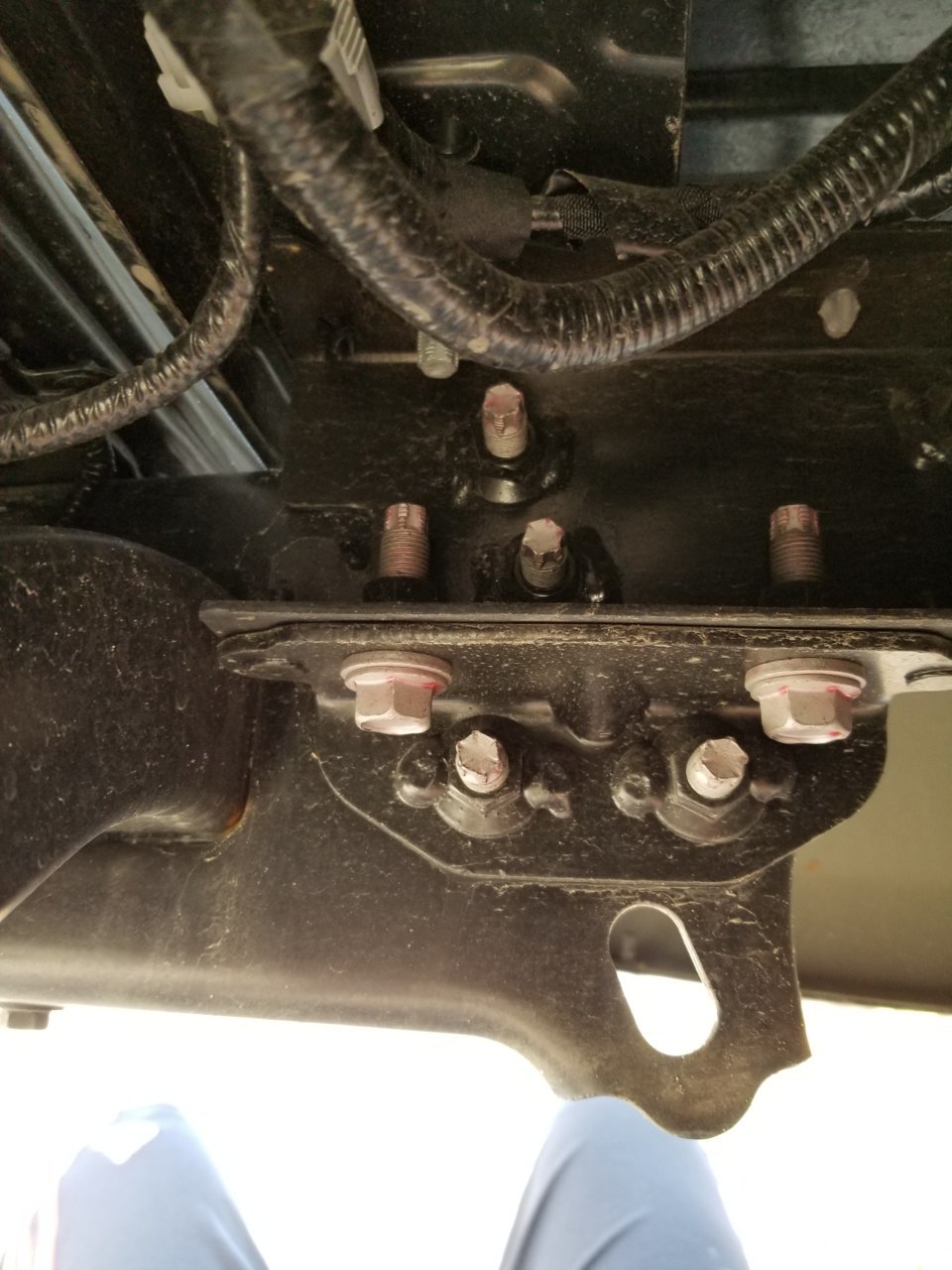

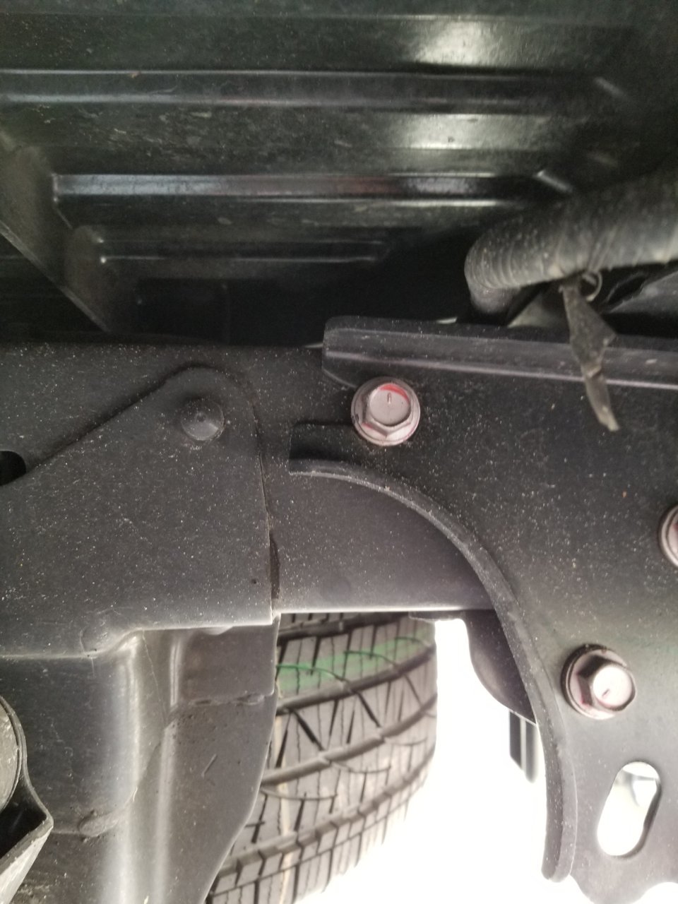

    Pictures from underneath

    Has that bracket moved? Looks like you could loosen that bolt, pull the bracket back into position, retighten and be good.

    I was commenting before you posted the other pictures. Your first picture shows the corner pushed in.

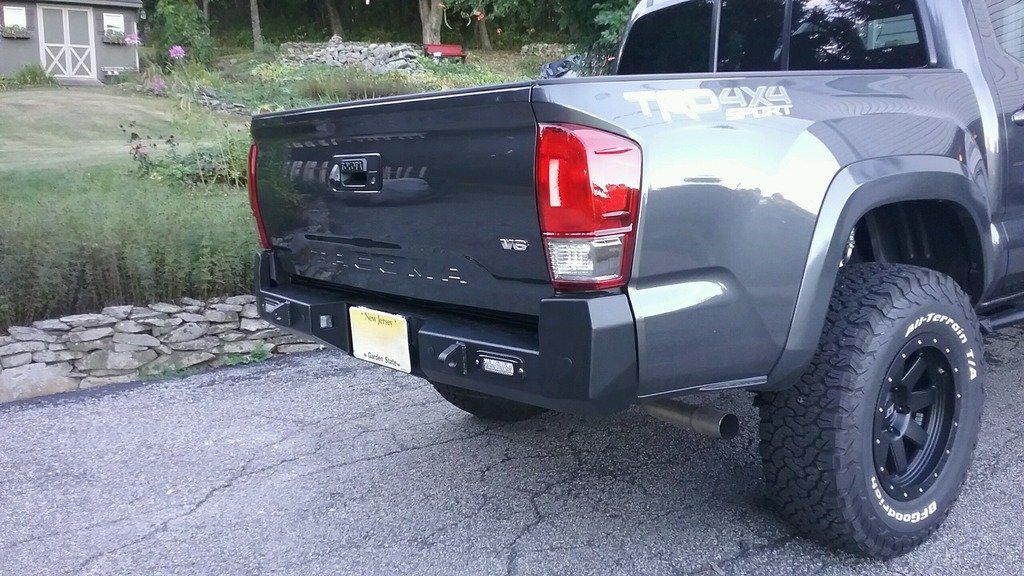

    OP:
    Time to go RCI. Mine just arrived and I’ll be installing next week if I can. Can’t wait. Here’s a pic from the interwebz to inspire you:

    I had a similar hit, but also had rear panel damage. Got a Mobtown bumper, and I'm very happy with it. Definitely worth the wait.
