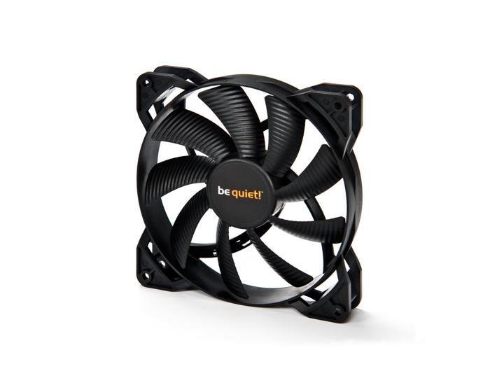

    Hello all, I’m looking for some opinions about the possibility to add a small computer fan or two inside the center console to move some air to the back seats. I have a dog who has always had his own air vents in the back but since the taco doesn’t he is constantly hot, which is a problem because he goes everywhere with me. He winds up in the front seat way more than he used to.
    I think it would be simple enough to get two 120mm fans and rivit them to the back of the console and cut the appropriate size hole for them. Run a switch to the dash and boom, done! But I am wanting to get some vents to make it look factory and I’m having trouble finding something that will mount flush. Anyone have any ideas or am I just crazy for wanting to do something like this?
    Picture of fan for reference and dog for awesomeness.

    If you mount them in the console, where will the fresh air come from? Seems you’d have to run around with the arm rest open for the fans to actually be able to move air, and that seems like a pain to me.

    There's space under the cup holders and if you pop some inlet vents in the sides of the console it should work. You'll need a switch and fused power source. Not sure if the existing dash switch would work or if it is just a relay control switch.

    I would just drill a hole on either side by the seat to use as an intake hole, I don’t need the air to really be heated or cooled, just moved at a decent velocity. Although heated or cooled would be preferable. I could always try and tap into the rear air lines that run on the floor.

    Planned on an add a fuse for power and a separate switch for on/off. Most of the ones I found draw 2 amps or so so power isn’t a big worry for me. Really just mounting and being able to get a vent cover to direct air is my big concern currently.
