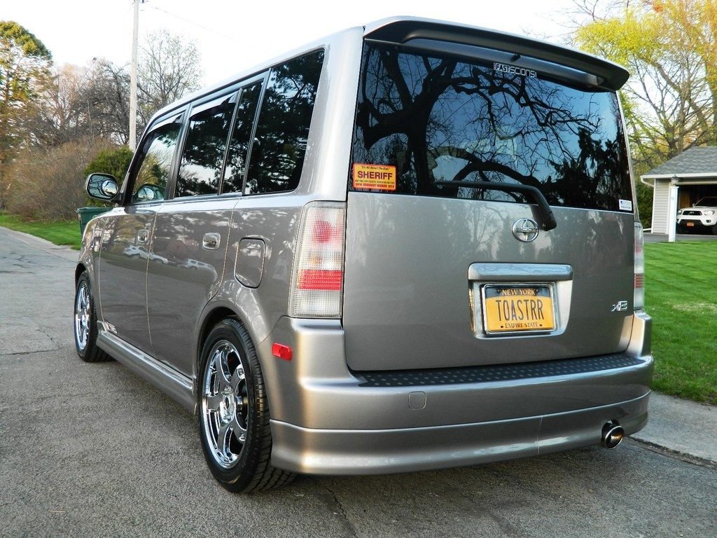

    I never tried the Blade. No more pickup truck in the garage. Shrugs.
    For backup lighting on the 4Runner, I have a slightly different setup (2 Baja Designs pods) for additional rear facing fire power. Besides, running the wires through the rear hatch would have been a bit of a pain. As for trying it on something else, the only other thing in the garage is:
