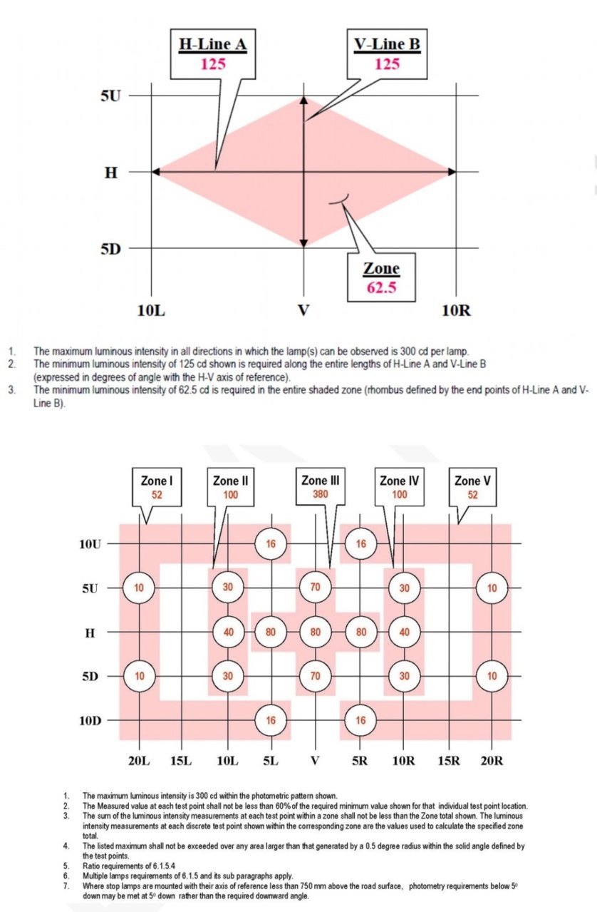

    klavender1[QUOTED] likes this.

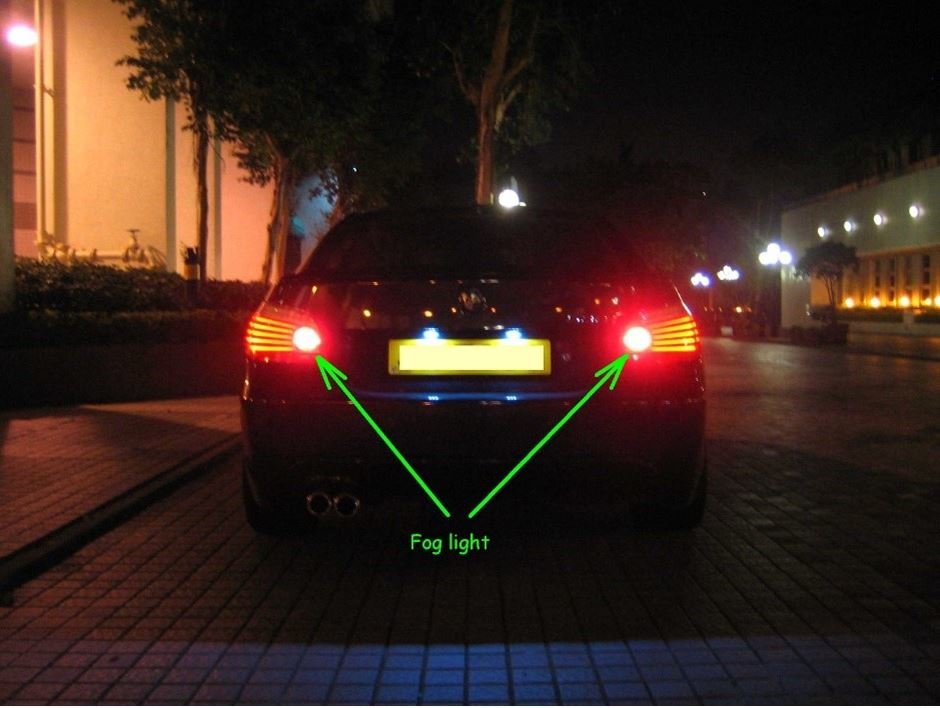

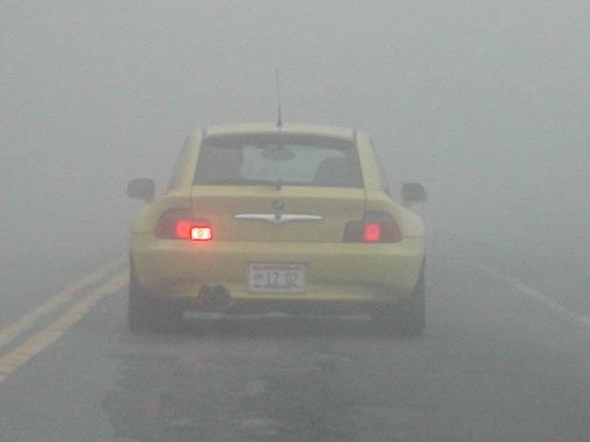

    I'll respond to you one more time in good faith, as I don't think you are here to troll. Running lights are fine in typical driving conditions but fog limits the distance light can travel. This is where the rear fog light comes in, it's purpose is to be brighter so that drivers that may be driving the same direction and approaching at greater speeds can identify you at a safer distance. Fog can occur in icy or snowy or rainy conditions which will increase the distance to stop. The fog lights are to alert drivers behind you that do not see your running lights at a distance (because... you know... THE FOG) that you are there.
    Example below. Compare the running lights to the fog light in twilight. Night time and thicker fog would only obscure the running lights more. In a pitch black situation with heavy fog the car behind the bimmer would be able to see the red light at a greater distance. I'm not sure how to explain this better so you will understand. Hopefully this does it. I encourage you to drive a windy mountain road in heavy fog conditions at night with a friend in front of you to test how well those tail lights do.

    Great photo illustration, thank you for that.
    mic_sierra likes this.
