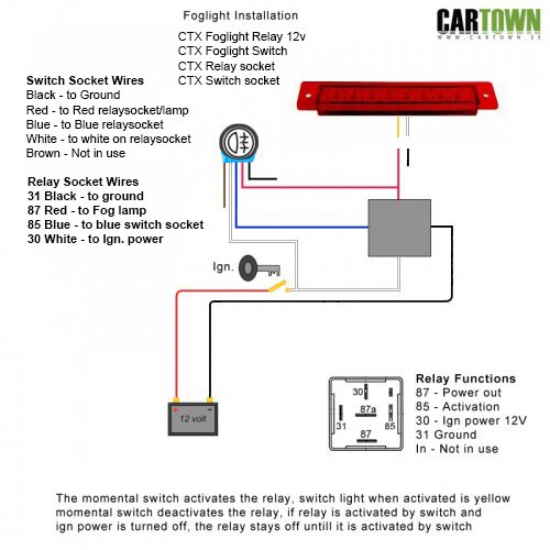

    I agree with you, guessing these work together with the momentary switch to make sure the fogs go off when you shut the lights or engine off to conform to the ECE rules. The carbuilder one works the same way without a relay.

    Here is my game plan for this, feel free to jump in if something looks wrong. The Hella rear fog is on the way, the cartown.se kit that Virgil (from candlepower forum) linked is here already.

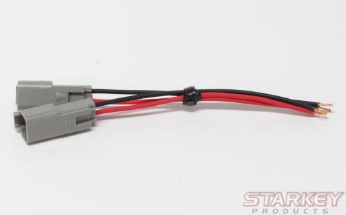

    I thought this set up hooked up to the battery and then had a trigger or activation that was tied to a light. It doesn't, so what I'm planning on doing is using a Y adapter from Starkey Products that will give me an extra output from my OEM front fog that will be the 12v +and - for the relay and the switch.
    a couple of these will make for a nice water tight connection in the harness.
    Now the hardest part is going to be figuring out where in the world I can put the switch on the very crowded f150 dash and getting the wires through the firewall grommet.

    Actually I don't know. Don't want to add another relay on a light that only draws 3w. If there is an issue the BCM should shut the circuit down. Since the fogs are connected to the BCM and it monitors for over currents I think (but am not sure) that should be good.
    i could always tie the 12+ to the fuse already run to the DD driving lights and get the "-" off the fog light tap???????

    I'd agree that you're nowhere near the current draw you'd need to require the use of a relay. (I was kind of wondering why there was one in there anyway.) I'd also agree that if you tap into the existing fog light circuit, you shouldn't need a separate fuse since that circuit is already protected.

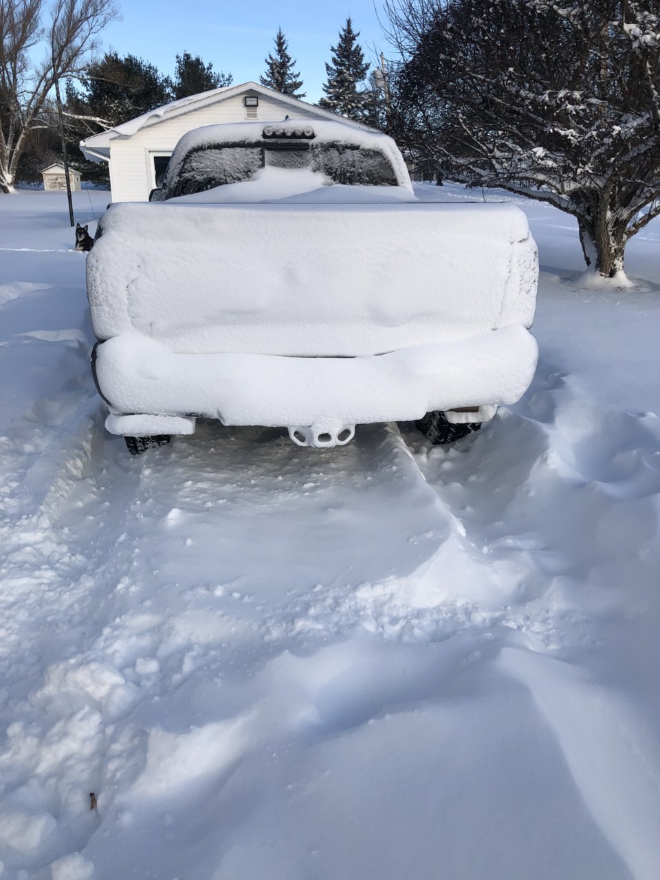

    Coulda have used rear fog lights last night in blizzard conditions. I had good forward visibility using my amber and white halves of my light bar together but I had some worry about trucks coming up from behind, so I actually ended up using my meso puddle lights as a driving light because they’re incredibly bright and light up the sides and rear of my vehicle, was also using my rock lights but they’re not as bright and only light up the underneath but I figured every little bit helps. I don’t think an oem rear fog in the tail light would have been effective last night by the looks of my tacomas ass.

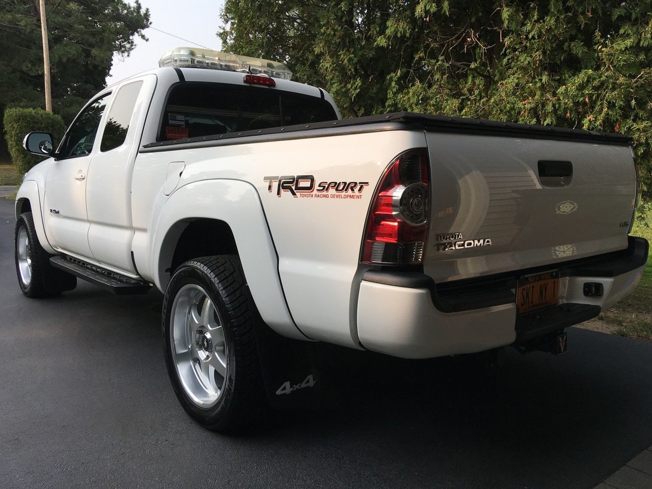

    Yes, in heavy snow conditions, a rear fog - particularly an LED version - will cover over pretty quickly and not do any good. Although I don't have a good picture of it in the snow, the only really effective way I had of alerting drivers of my presence was a 36" light bar mounted on my roof. All LED lower level and 4 halogen rotators in the upper level. It took a lot to block that bad boy out.
