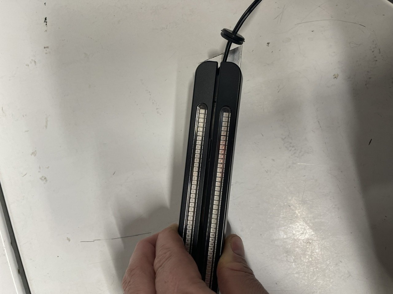

    Late to this thread. Owning a white truck I'm always looking for ways to improve visibility to other drivers in the winter. I personally have the split putco blade and love it although it is not a replacement for rear fog lights. I suppose you could get creative with wiring to produce brake light output when your fogs are on. I've debated the jw speaker 274 previously but haven't put too much thought into an attractive mounting solution. There is an L-bracket option.

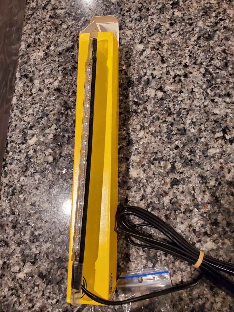

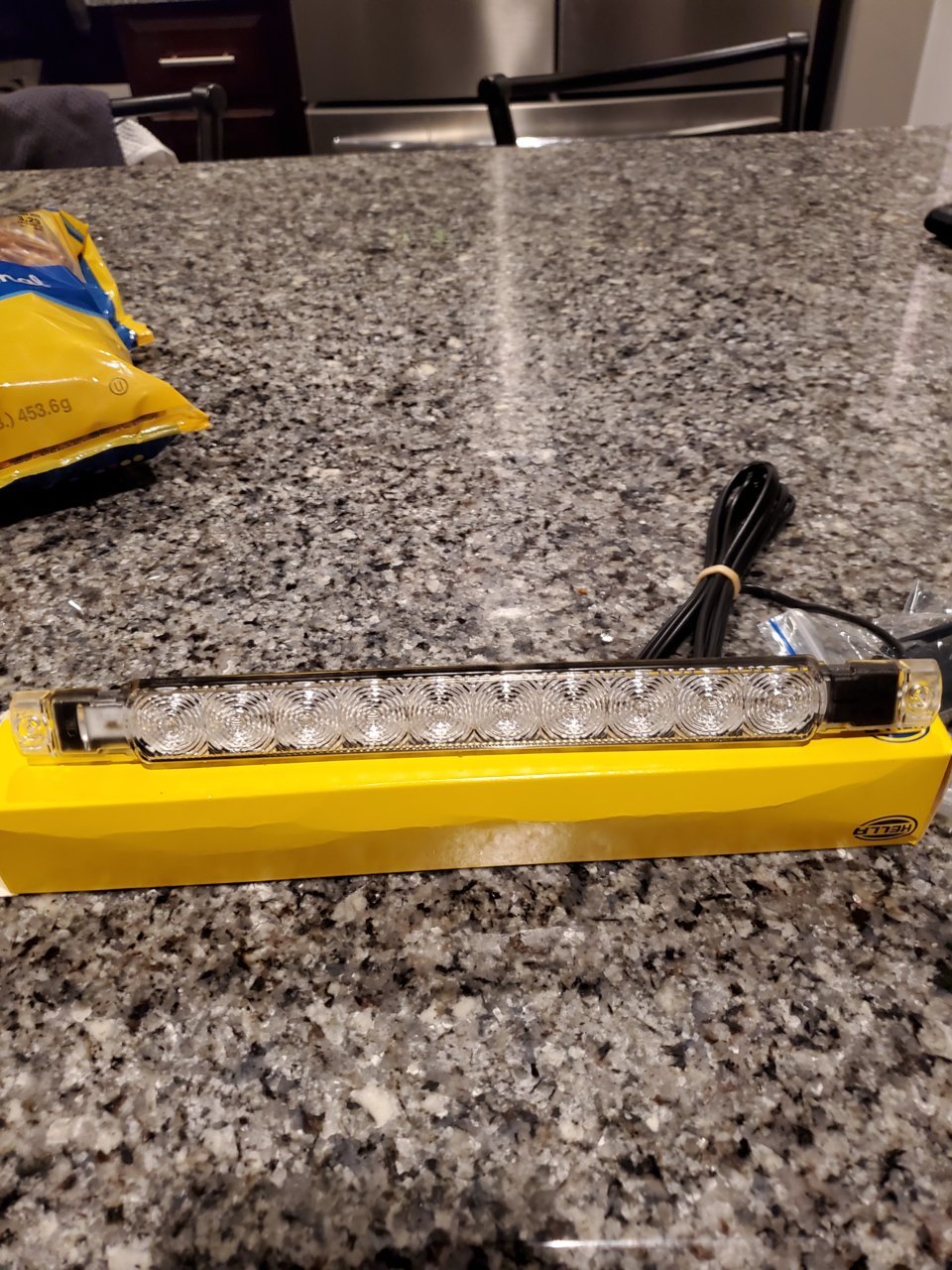

    Caught up and see the light arrived, can you share a picture? Curious how it compares to the catalog.

    Looks exactly like the pictures online.
    Too Stroked and 907rx7[QUOTED] like this.

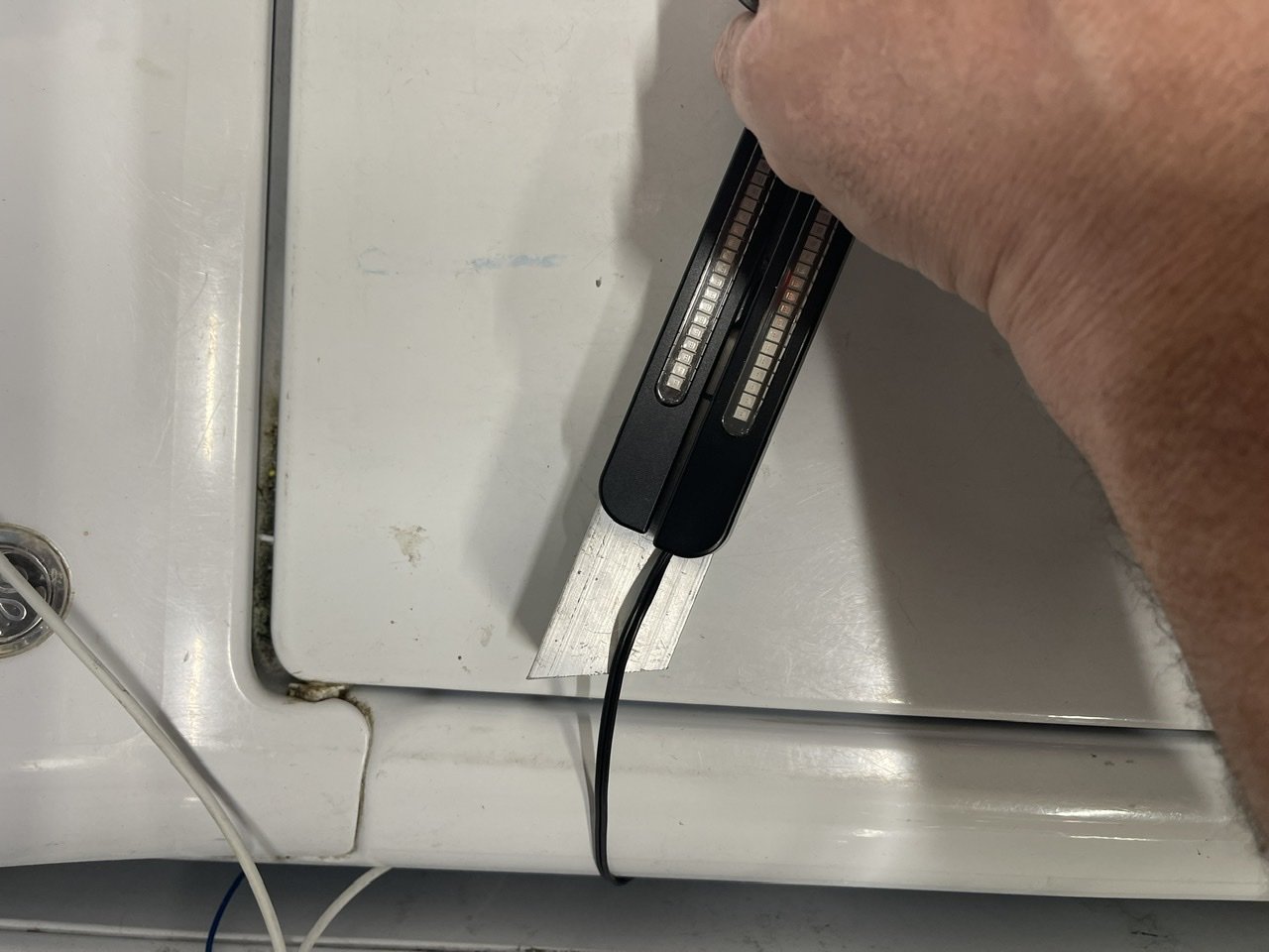

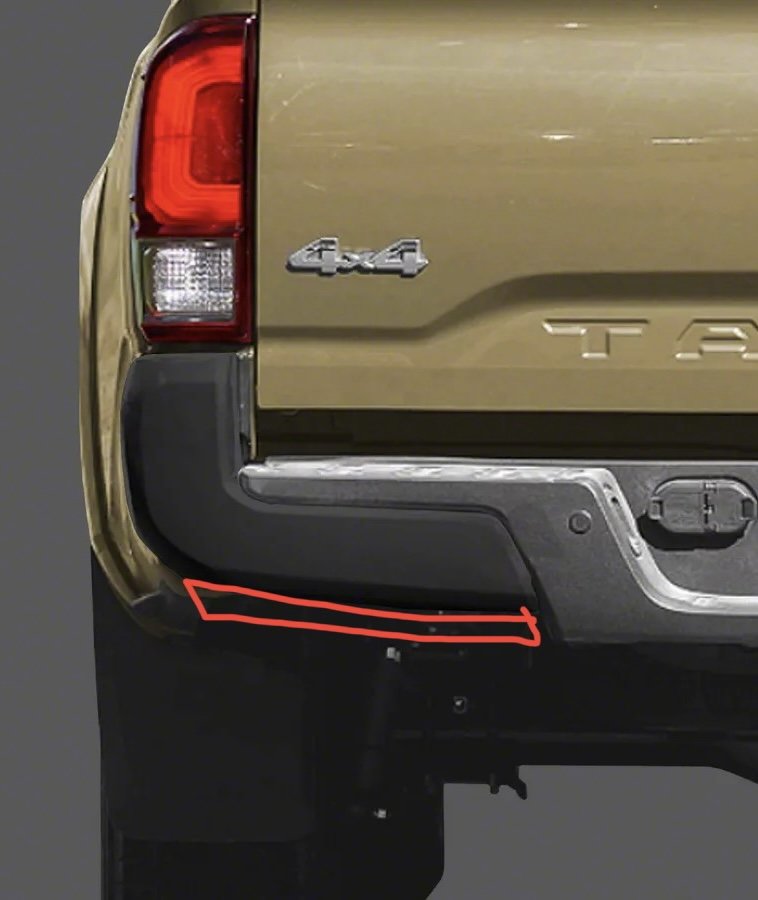

    I hate sharing stuff before it is at least partially realized, but here is what I am working on. I’ll try to get better pictures when it gets closer to being done (it is very far from that right now).
    Using 1 1/4 aluminum channel, I made some mounts for the rear end. They will mount under the bumper, and follow the body lines pretty well. Here:
    That spot also allowed for easy mounting as there are clips there for the bumper cover that can easily be replaced with some different hardware if needed (I haven’t gotten that far yet). It did take some modification to the aluminum. I had to remove some from the top top clear the bracket and bolt toward the center, but that was a quick job with a router. Anyway, the plan is to use a VLED LPB on each side, as well as a LPR for some other lighting (either more reverse light, or most likely going to tie it to the cargo light to act as a scene light, but that isn’t really relevant here…). So I took a die grinder to the LPB so I could make them more of a surface mount. They will kind of go like this:
    F41147BC-EDCA-46FF-95BA-23CE3CB87CAB.jpg E57423B6-72E9-45B2-9823-6BCF40B86D6C.jpg
    Once again, this is a very rough explanation. When it is all done, I will definitely update though with some half way decent pictures. But maybe it will give someone an idea to expand upon.
    toledoupsguy[OP] and 907rx7 like this.

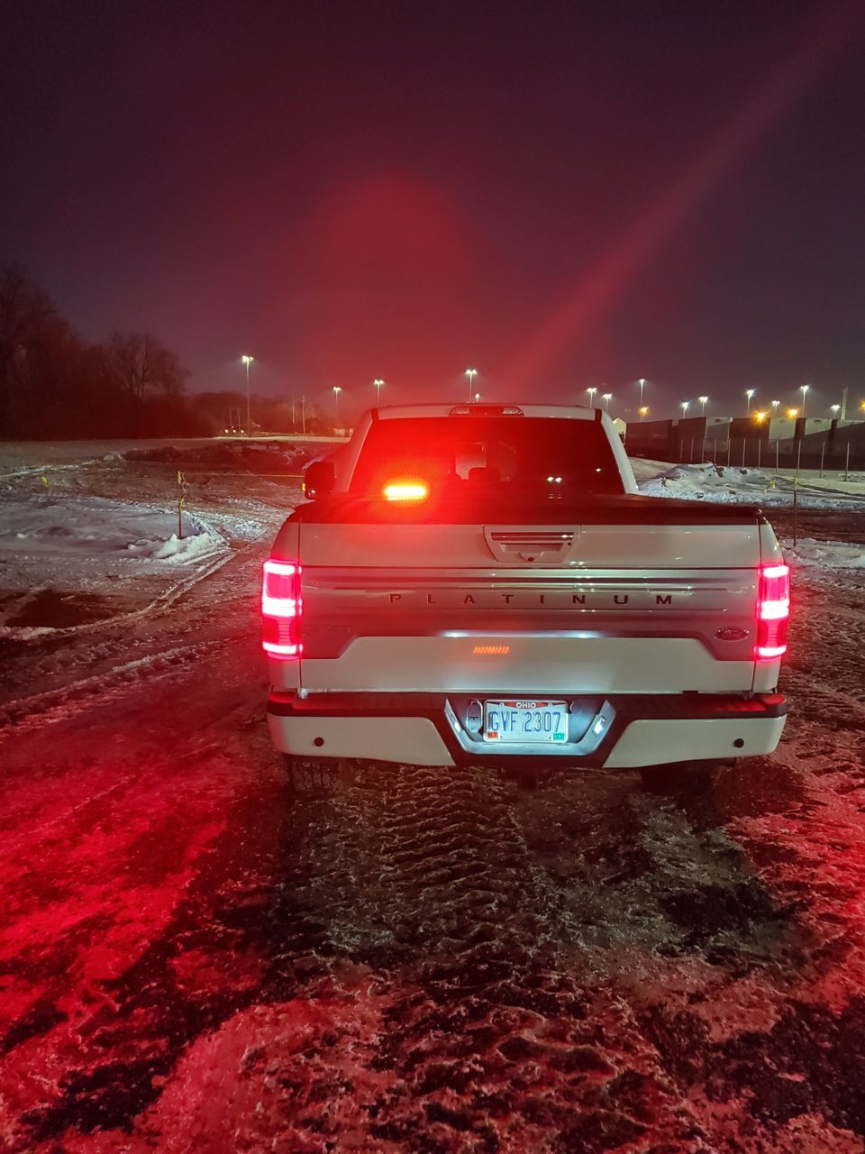

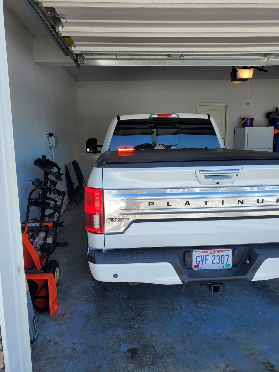

    Lousy picture but hopefully representative. Freaking cold so took one and ran back inside. In bright sunlight the tail lights are barely visible but the Hella rear fog is bright.
